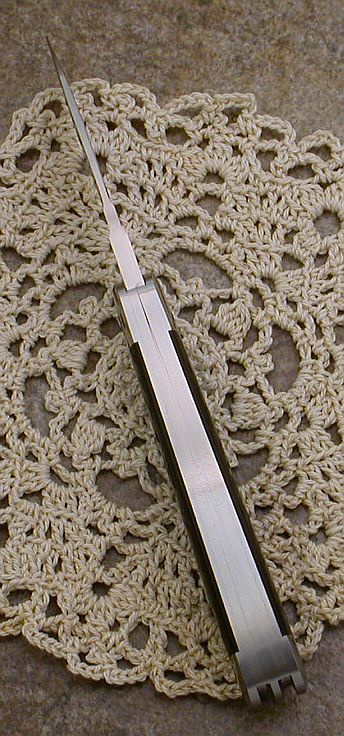

If a slipjoint has a split spring...does this mean a main blade at one end and two blades at opposite end....the main blade being the thickness of the other two blades plus the thickness of middle liner...all three blades using the two springs at the same time? So little time, so many things to learn.....
Almost -- the single blade is the thickness of the two springs only (and yes, it uses both springs at once) -- the liner gradually tapers down in thickness to a point and stops - normally ending not much past the center backspring pin (the center backspring pin anchors the other end of the tapered center liner). The two blades at the other end each ride one of the springs.

Here is a nice image showing the "split spring" config on a R.Bose Rogers whittler.

Thanks zerogee for the images you sent. Here they are...
These pictures show a catch bit. that's what it is called. They are used on paralell back spring whittlers. If it is a split back spring whittler it has a tapered cut liner seperating the springs at the back end. The picture Kerry posted of the whittler that Reese made is a split back spring whittler.
PS on a split back spring whittle the master blade thickness is equal to the thickness of boyh springs and the back blades each are the same thickness as the spring setting on it. On a paralell back spring both spring equall the thickness of the master blade and the sum of the thickness of both small blades and the catch equal the thickness of both springs. If you think this is confusing try making one.
