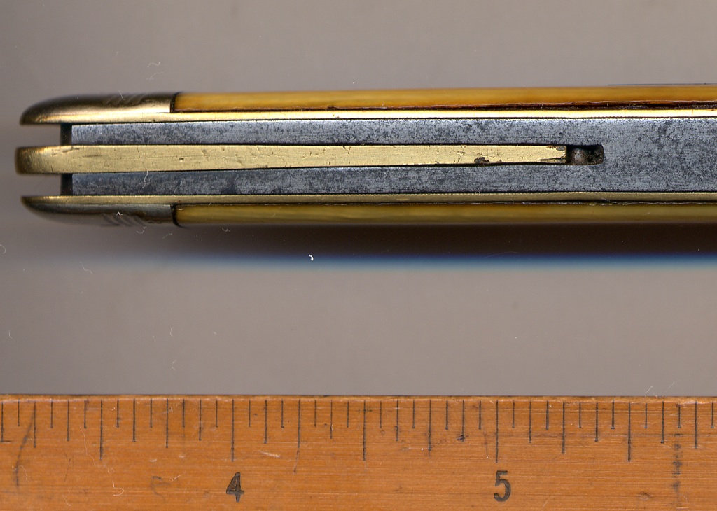

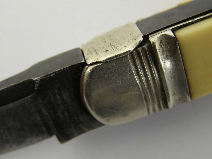

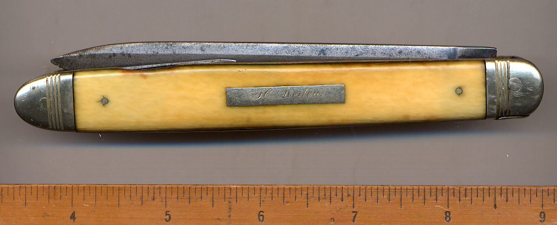

wharncliff whittler
T. Reaney
Shalesmoor
(1833-1857)
I copied this picture back in 2007. I don't know (remember) anything else about it. The bolsters are forged with the liners as a piece.
Thanks for the pics, guys. All of the single spring whittlers I've seen are from the 1800's and all but one were made in Sheffield. I've been working under the assumption that this style was abandoned because of the difficulty (resulting in higher prices). Is this correct? Are there drawbacks to this style such as weakened springs or anything that would push manufacturers into the more common two springs with a wedge style?
So all of this begs the question: how is a split spring created? Are two springs hammer forged together? Or, Is a single spring cut halfway down the middle?
I'm going to guess forged together. I imagine the inside edges facing each other need to be smooth so they won't hang up on each other.
I have never seen that design before, thanks for the pictures! My next question would be about longevity, but I guess that is answered since those knives are well over 100!
Thanks--that would be my guess. Heat and flux on one end. BTW I like the integral bolsters on the knife in your pic. I guess they were made for knives besides Barlows, too.
B.Levine had something on this a few years back on his Forum. There were cutlers in France and England who actually made split-springs but they (unsurprsingly) proved far too fragile in use. So I would believe that the ones shown would be forged together. It also explains the fix of using a wedge/spacer to divide the backsprings on many Whittlers.
i would do differently. I would cut and then forge down the end of the cut...less heat involved and no flux trapped in between
