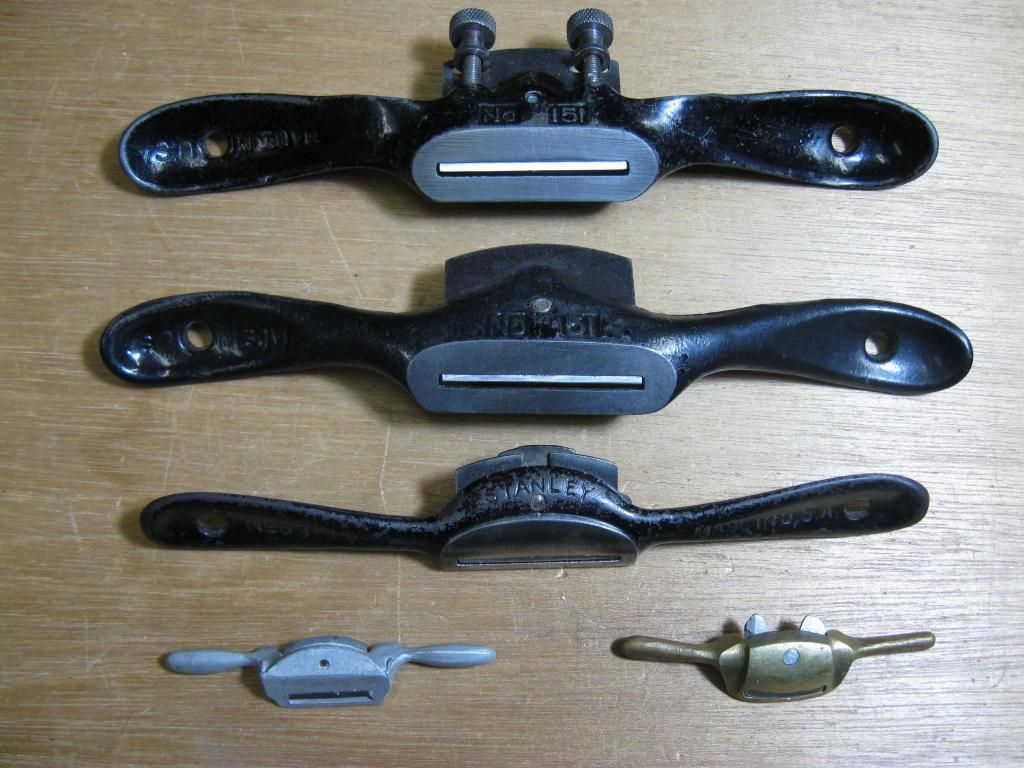

Here are pictures of what I have
Metal
Top shave is is a Stanley 151 with the adjustors mentioned previously. Next is a 51. Both are flat bottomed, both IMHO are nice shaves. The 151 is obviously easier to set the blade, but I don't mind setting up the 51 so the adjustors aren't a make or brake for me. Next is a Stanley 63. It's a little smaller and has a round bottom. This one is my favorite. The little guys on the bottom are no-names, but work well in tight spots.

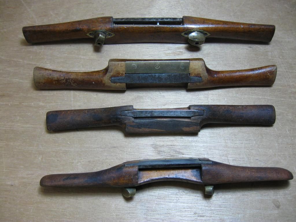

Wood
These work well and are just plain fun. Note the top and bottom shaves have their blades held in with thumb screws to hold the blade in and adjust cut depth, while the blades for the two in the middle are friction fit. For a user with a wood body I'd reccomend one with the thumb screws and a brass wear plate.
