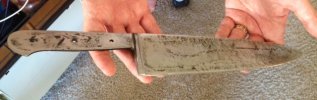

Recently pictures have appeared of irate looking spouses holding recently arrived triangular boxes. This appears to be a situation that could have serious mental and physical health consequences for various forumites. It is said an ounce of prevention is worth a pound of cure, so how many would be willing to buy kitchen knives for their beautiful and long-suffering spouses, if such were available from HI?
If some 100+ year old drop-forged kitchen knife blanks with integral bolsters could be finished off by the kamis, would that help placate the incipient furies? Finishing would appear to involve final forging/heat treat/grinding. My guess is the 100-year old steel would be something not too complex that they would have no trouble working in traditional manners. I could be wrong though. What are your thoughts?
What kind of price point could HI expect to get for a finished heavy duty chef knife with a 10” blade, capable of doing cleaver work, opening coconuts, etc., as well as the standard veggie cutting.

I certainly think they could differentially harden these blades in the traditional manner. Probably much faster than Khuks due to the lack of mass. Not sure what the steel type would be but I bet they could adjust to make it happen. Maybe some of these pro knifemakers could expound on this? As far as the complexity of the preformed bolster i would think the scales would be a breeze for them. Id buy a full set of them especially if a certain amount of the proceeds were donated to earthquake victims and you know they would. Id pay minimum about $6-$10/inch. Maybe much more depending on everything:rolleyes:

All cuteness aside the 100yr old steel would be excellent if actually made after 1890s when true steel became suddenly cheap and plentiful and relatively clean for all industries to play with...in 1870-1880 timeframe a shotgunner shelled out hundreds of that time's money for fluid steel barrels....most other stuff would not be classified as steel today.....but old steel actually ages as it never stops completely cooling/changing and can be really good stuff...in honesty i have no desire for any more kitchen knives than i do not use already, but that is me...
The story is that these were hidden away to avoid the metal confiscations/appropriations around WWI.

I think i might manage to buy one if not outrageous...but am no fan of $100 kitchen knives when i have other $500 knives i use there anyhow as well as elsewhere.....but they should be excellent....martensitic transformation continues as steel "cools" over time and even microscopy of old razors have astounded researchers.....an old Marbles knife is better than new...and not due to anything but age (excluding newest made in China).....so an old kitchen knife could be very good...probably plain high carbon steel near 1085-1095 class....
