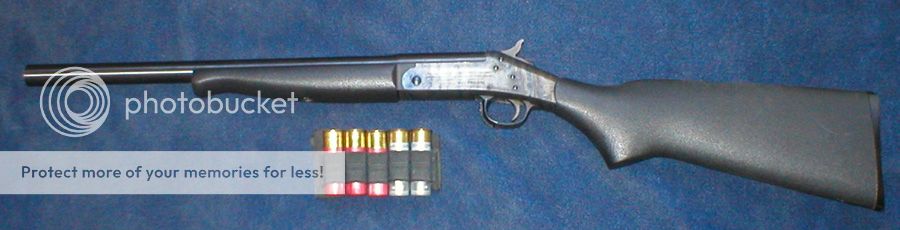

I sprayed this shotgun 5 years ago and it has held up great. I have done a couple rifles and some AK magazines also and it really lasts. I sand and prepare my surface nicely first then spend several days spraying on 3 or 4 coats letting it dry pretty good in between coats.
I have also found you have the choice of making the texture a nice smooth surface or rough and bumpy as you want for more grip. Keeping the can in kind of close (but not enough to make it run) gives it a smooth surface and bringing the can out far away on your last coat leaves is bumpy and textured.
Its cheap too. About $6 a can and it will do 2 firearm sized projects at least.

Your stock turned out awesome! ...is that sprayed-on over wood? if so, it looks great! I have beat up stock on my Rem. 870, deer gun that I would be interested in finishing that way...vice buying new synthetic stocks. Doesn't look like I'd have much to lose by trying the stock already looks horrible. (I bought it that way ...it's a tack driver though!)
Yes that is the original wood stock. It works great on wood. I got that shotgun at a pawnshop for $30 with a very beat up stock. Turned it into something fun.
A coat or 2 a day for a few days letting it dry well in between coats. I also like to give it about a week to dry before using it. Even though its dry to the touch it stays wet underneath and will scratch easily until its really dry. Thats when it gets tough.

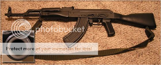

Here is an AK that I did the wood and the magazine with truck bed liner also.
