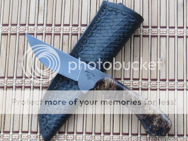

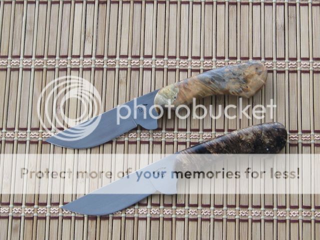

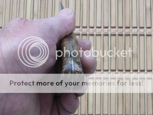

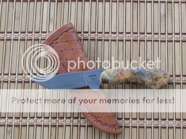

Just out of the shop with these 2 Spring Creek hunters. Both are full tang 1084 steel with differental heat treat. Flat ground with nice distal tapers. Satin 400 grit finish length of cutting edge is 3-1/2" . The darker one has stabulized spalted Maple burl handle. The other is stabulized Box elder burl. Both have 3 1/16" SS pins. The sheaths are 8-9 oz leather by yours truly.
As always constructive crituques are welcome.
