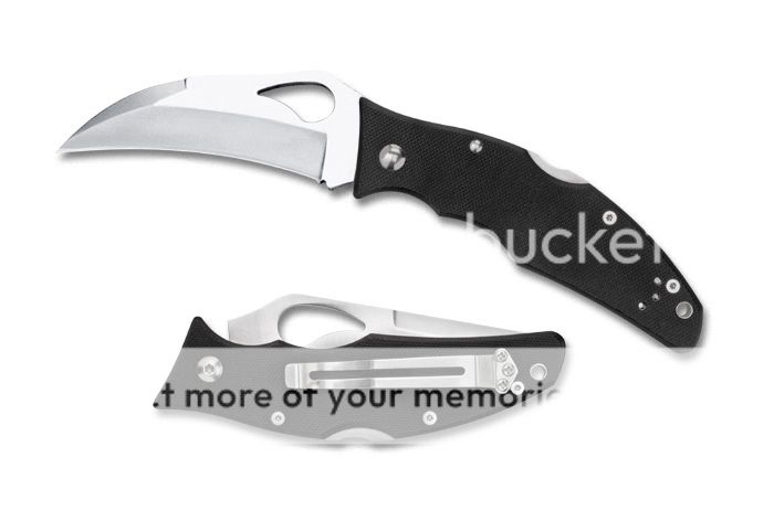

I don't know the model name, but the Byrd line has a folder with a hawkbill blade.
Should be under $20 for the FRN version, bit more for the stainless and G10
Opinel makes a good inexpensive pruner in carbon steel but it doesn't open one handed.
It is called the Byrd Crossbill G-10 and is available in part serrated as well.
P.S. - Welcome to the forums!

The Crossbill is roughly the size of the SpyderHawk. The Byrd series knives are made in China to Spyderco specs and quality control. They are amazingly good knives for the price. The 8Cr13MoV steel is similar to AUS-8, but run harder than AUS-8 normally is. It sharpens easily and holds an edge well.
All of these knives except the SuperHawk are lock backs, and none of them should be difficult to operate with gloves on. The Comet hole of the Crossbill gives more purchase for the thumb than the smaller round holes of the Merlin and Harpy.

The G-10 Crossbill has skeletonized steel liners under the scales. It will feel far more substantial and rigid in hand than the unlined FRN of the Tasman Salt. Which will fail first in real use? Flip a coin. I have ten year old unlined FRN knives that I have beat the hell out of and they are still going strong. Looks and feel can be deceiving. Your best bet is to pick a good brand name and buy from a reputable dealer. Either the Crossbill or the Tasman will give you years of good service. It will boil down to personal preference - which works best for you. I hope you can find them locally and handle both before buying. I'm not that fortunate, so I do most of my knife shopping online.
