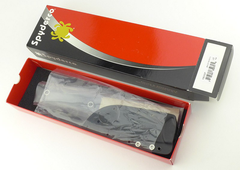

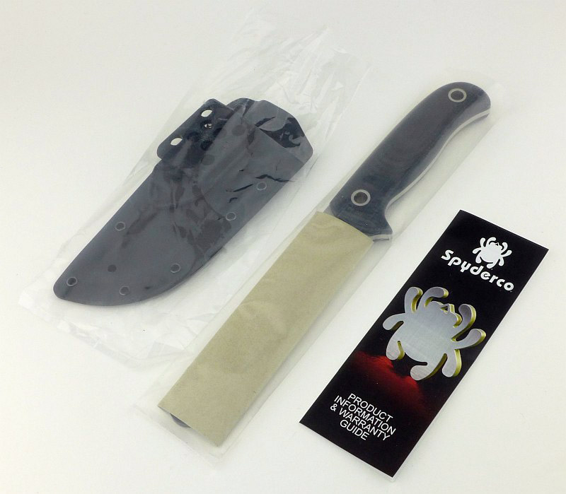

Standard Spyderco packaging is used for the Bradley Bowie.
Both Knife and sheath arrive in plastic bags. The sheath has come out of the bag slightly, but the knife is still fully covered.

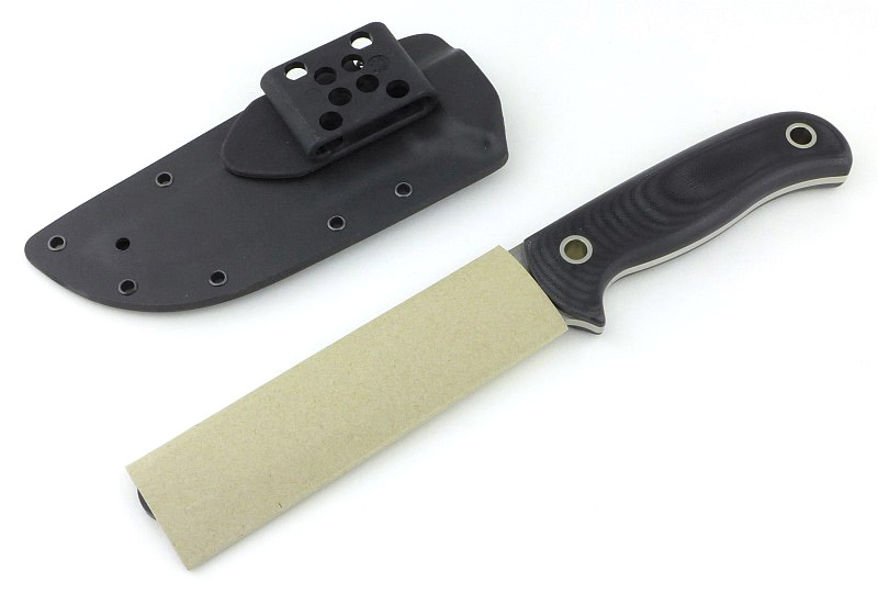

In the box are the knife, sheath and information leaflet.

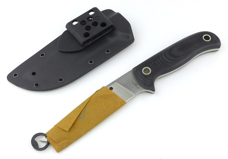

Mainly due to the choice of steel, there are a few layers of protection for the blade. With the plastic bag removed, the first layer is a cardboard sleeve.
With the cardboard sleeve removed we find a wrapping of Vapour Corrosion Inhibitor paper, plus a plastic tip guard.
And there it is, kept pristine by the wrappings.

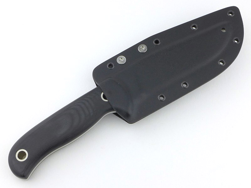

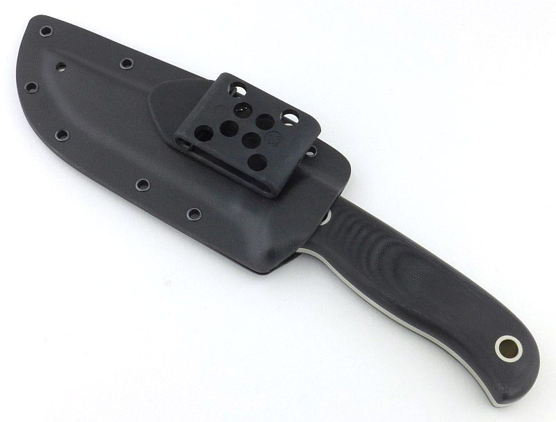

We are going to have a look round the sheath first. Not just any old Kydex sheath, in fact not Kydex at all, but its higher performance alternative - Boltaron.

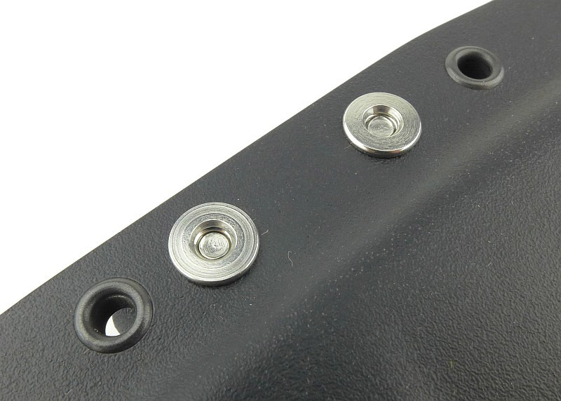

The back of the sheath...next onto some details.

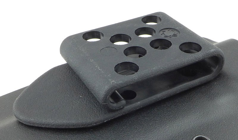

In contrast to the black Boltaron and rivets, the belt clip fixings are silver coloured.
As expected with this type of sheath, the Boltaron is moulded around the end of the handle and has been cut and sanded to its final size and shape.
The belt clip itself is open at the bottom, but tightly sprung with a hook shaped end. Once positioned on a belt it will not easily come off again.

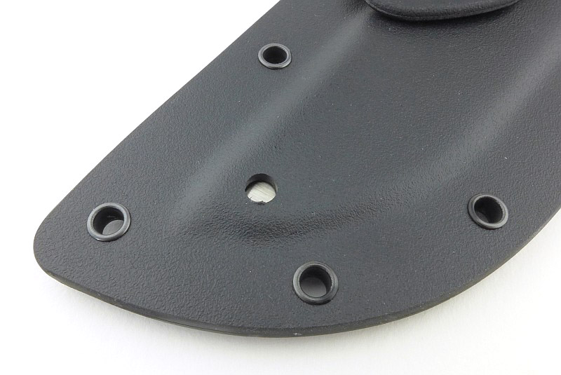

Near the tip of the knife is a drainage hole. Ideally this could have been further down at the actual blade tip, as a small amount of water can still stay in the sheath if it becomes soaked.

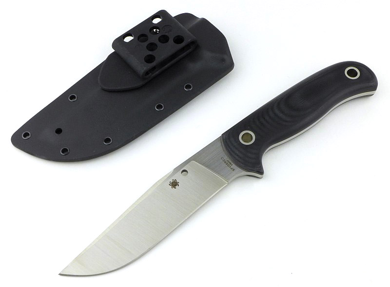

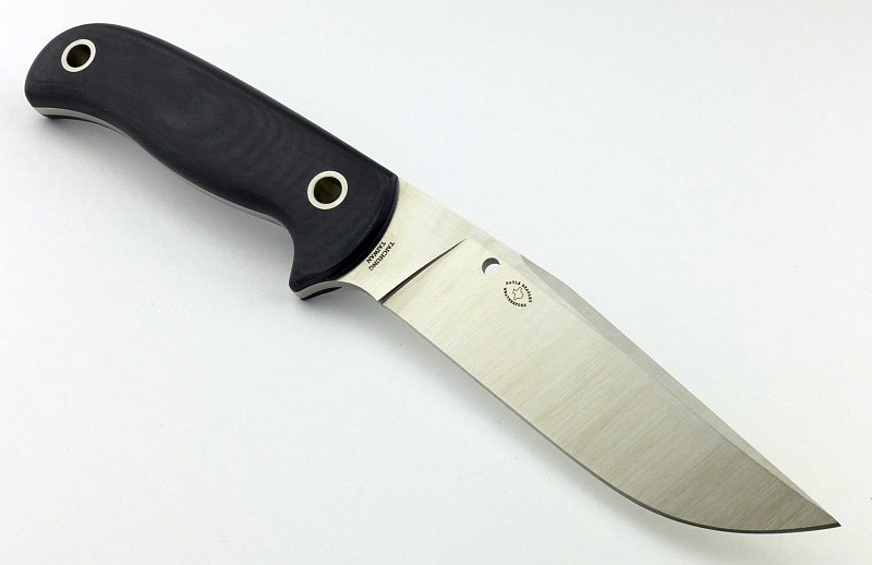

Now onto the knife. Just take in that full flat grind and long sloping swedge.

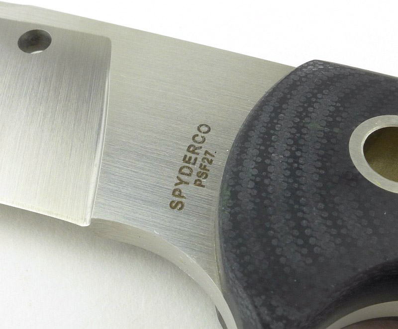

The PSF27 steel specification is engraved under Spyderco's name.
A finger guard is formed out of the full thickness tang and handle slabs.
The full thickness tang is prominent in the slim handle.
There are relatively sharp corners to the plunge line - potential stress concentrators.
Gayle Bradley's logo appears on one side of the blade.

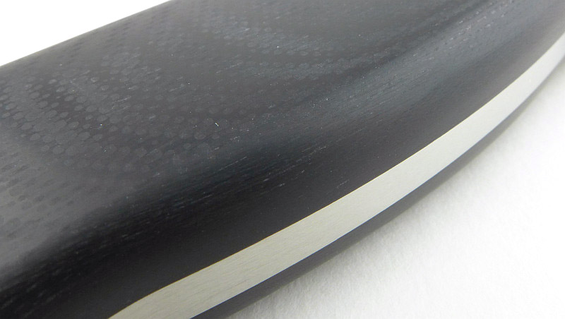

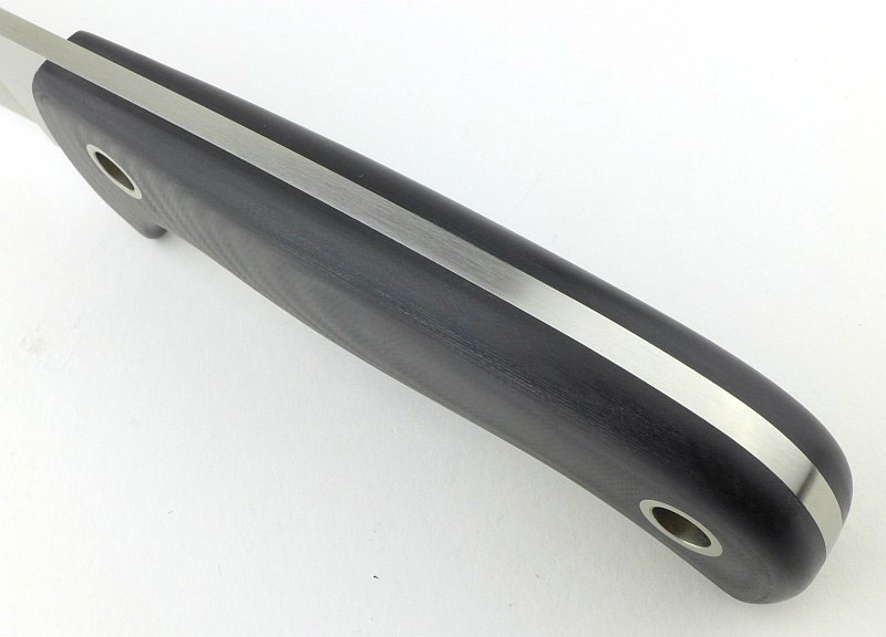

All the corners of the G-10 Handle are well rounded preventing any hot-spots. Only a small section of the handle edge next to the ricasso is not fully rounded.

I've already mentioned that the design of this knife really speaks to me, and just looks right. This is absolutely confirmed by the feel in the hand; it really does work as well as it looks like it will.
Excuse the potential connotations here, but that semi-polished G-10 handle is asking to be touched, stroked and held, much like a worry stone. Every part of it is smooth, the type of smooth that doesn't drag, catch or stick like a full gloss polish can. It has got to be one of the best feeling handles I've come across, and you don't want to put it down.
Even wet or sweaty, there is plenty of grip despite its smoothness, in fact the least amount of grip I found is with a completely clean and dry hand. The rounded edges remove any hotspots; you are much more likely to get a blister due to wearing gloves (and their seams creating a hotspot) than anything to do with the handle.
Personally I prefer a thicker handle for a bit more of a handful, but in this case I like the lower profile handle with less 'presence' on the belt (or as I often do, slipped in a large pocket). There is enough handle to allow you to really work the blade hard without adding bulk.

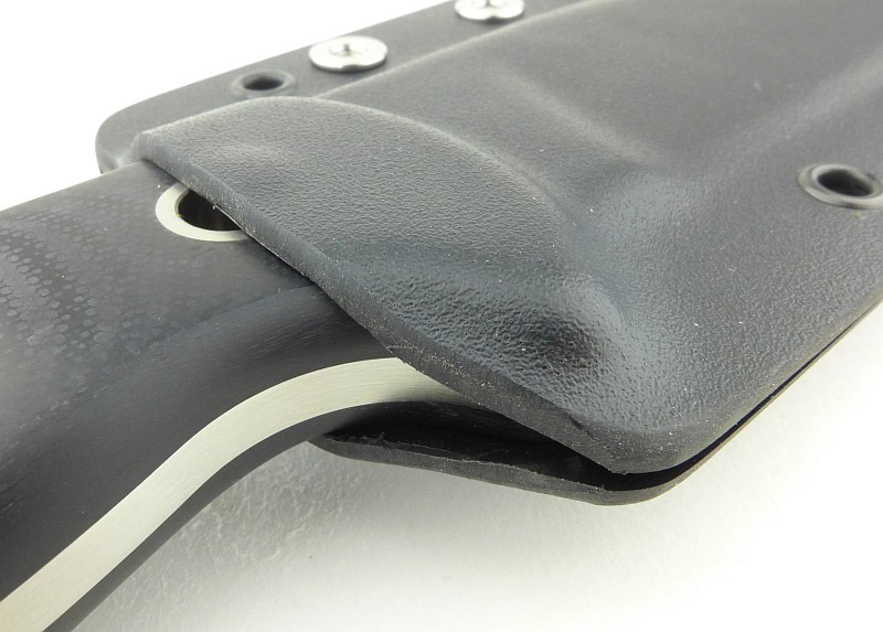

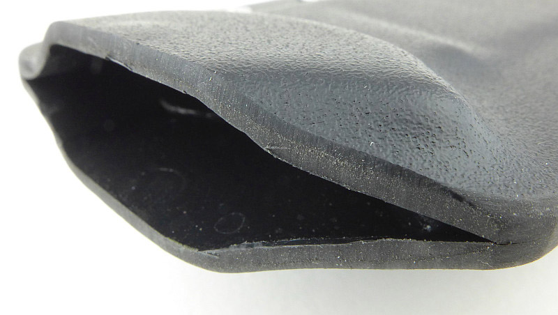

As is often the case with the type of sheath used here, the retention is pretty stiff, and the knife doesn't easily come out. You need to lever the sheath away with your thumb, or end up with severe 'sheath recoil' and an uncontrolled slash of the blade as it flies out. In the sample received here, the edges of the Boltaron had sharp corners from the final shaping and these were catching on the knife, especially on re-sheathing the knife.
