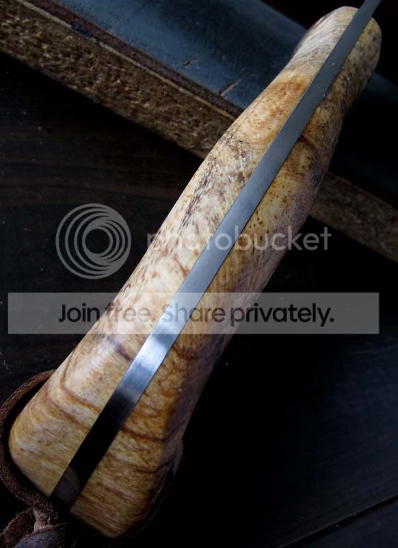

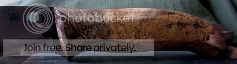

BACK to the mod I did on the handle, after I glued the cracks, I took the knife
out to the shop and with my fairly primitive tools, ground down the handle
into a somewhat octagonal shape, without losing the palm swell or the nice
contours near the guard and butt of the handle.

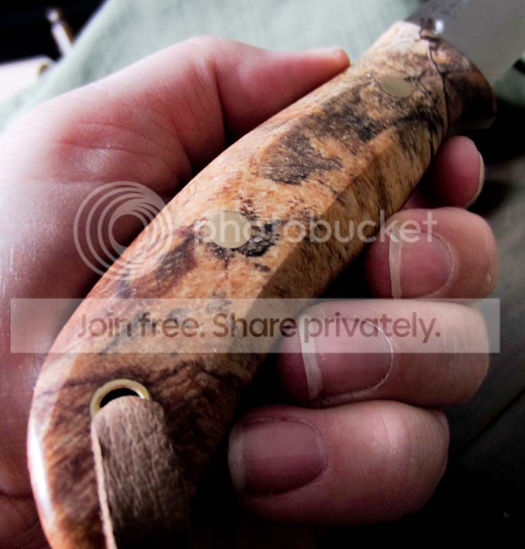

What this does is to provide some flat surface for your fingers to purchase a grip,
the fully round handle, to me at least, can tend to twist/roll in the hand, while
the octagonal shape, your finger tips rest against a flat surface helping to keep
the knife in a little more control.

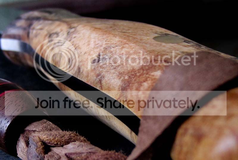

Here are a few images, quickly taken today, hope you can see the octagonal flats
that I sanded into the scales...
and as you can see, the palm swell is still there, you just get a bit more control of the knife, for me at least;
Very rugged knife, I've not tried to baton through anything yet, but that wasn't the purpose for
my having it, just a very sharp, nicely handled knife, all is good and the cracks are smooth
we'll see how long they stay smooth...
G2
Thanks guys, of course, being the level headed fellow that I am,
I plumb forgot to take BEFORE images ;) colour me silly, but there
should be some folks around that have this wonderful knife that
hasn't changed the contours of the handle and might post an
image to compare the difference, it is kinda hard to tell from
a photo, so in my photos I tried to get the contrasting light
to show the lines/edges of how the facets are formed.
