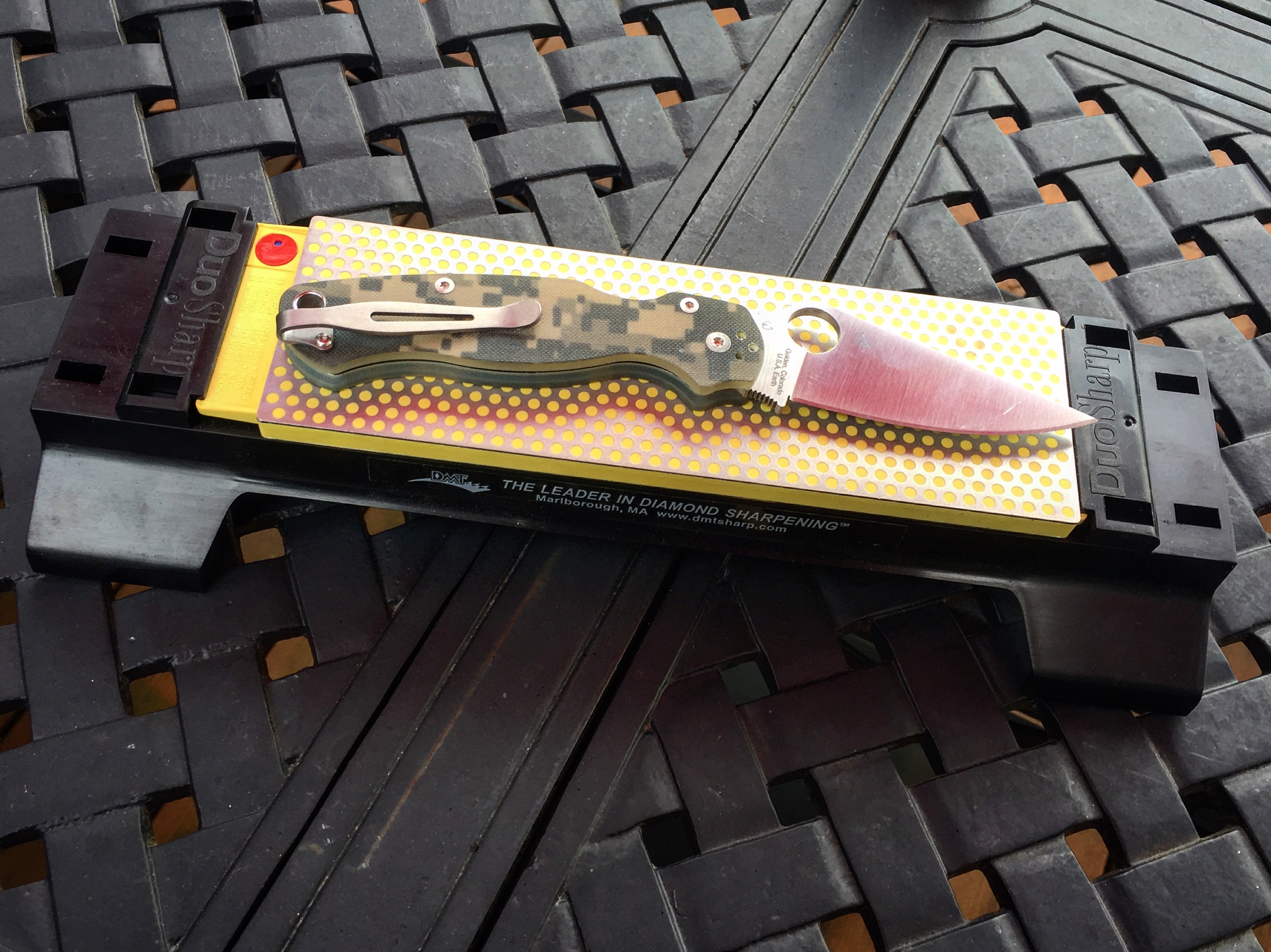

So I just wanted to post a quick update for this thread after I responded in another thread. Since the time of this thread, I have added a DMT DiaSharp Extra Fine stone and a Spyderco Fine Ceramic stone. I wasn’t sure if I needed the ceramic stone but I just went ahead and picked it up to try out.
I have gotten much better over the last couple of weeks and have been learning how to use each stone. I think I have a pretty good progression of stones now and it’s a set up that I can get great results from consistently. The DiaSharp Extra Fine stone is really amazing. Many times this is where I end. The 3 DMT stones are more than enough for what I typically need. However, I have been really liking adding the fine ceramic stone at the end of the process. It really cleans up the edge a bit. I find that I’m using it in place of my Sharpmaker for quick touch ups. Maybe 10 to 15 quick strokes per side and I’m getting arm shaving sharpness.
I must say it was really an “Ah Ha” moment when I was able to really “feel” the angle of the blade sitting flush with the stone. That was always a bit of a struggle for me. Now I can place the knife on the stone and feel the correct angle. So much easier now.
My next goal is to start resetting some angles on some older more beat up knives that need some attention. Right now, I’m just finding the current angle and sharpening from there. I need to start being able to reset the angle sharpen at 20 degrees, 25, 30, etc when needed.
