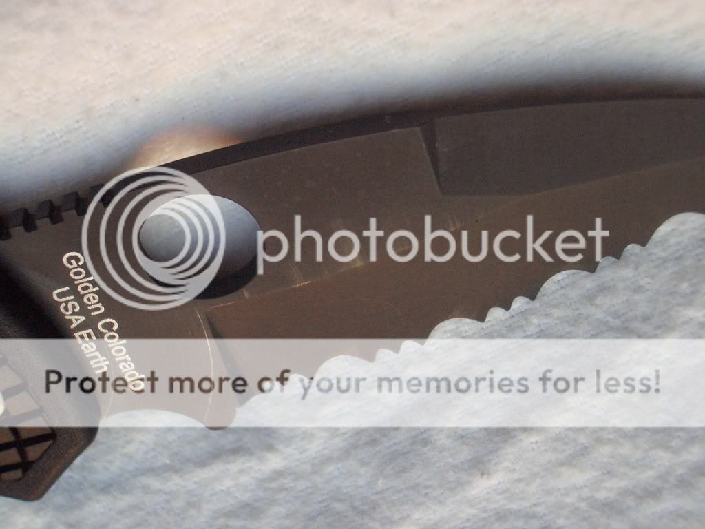

Normal use doesn't scratch the blade, most of the marks come from just opening and closing it. Dirt in the pivot area enhances that problem.
This Native wasn't actually used, just played with it for a while:
