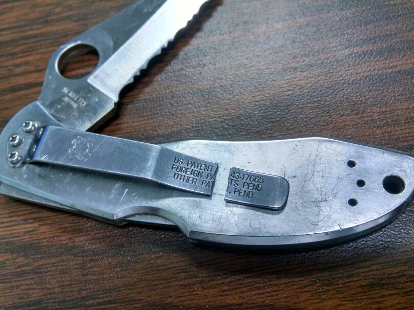

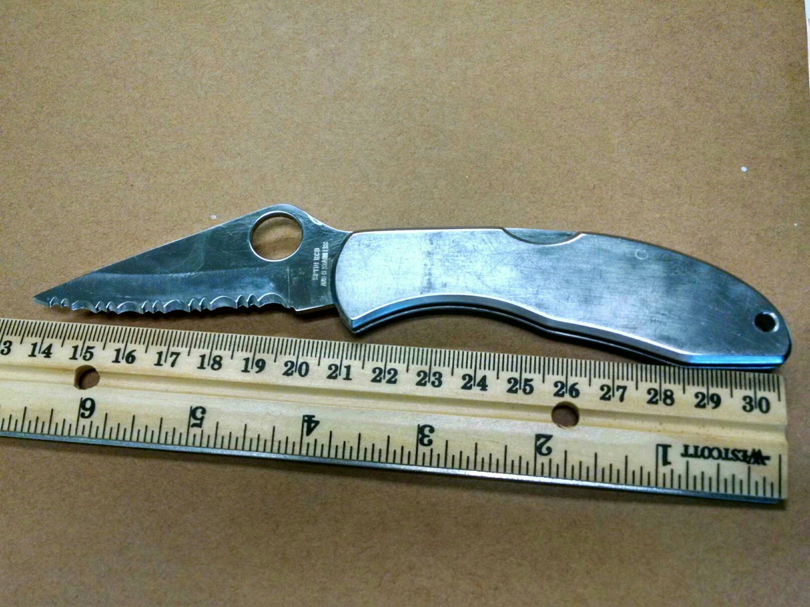

As promised...looks lik its a delica 3, Aus-6.
Not sure if years of carrying it clipped to the collar of my tac boots put too much stress on the clip or if with real world use that's just an expected wear and tear item to service, not that i think any other brand would have fared any better..
$5.90 shipped for replacement clip. What do you experienced Spydie owners recommend for sharpening a full serrated blade? What do I ask from a local sharpener to make sure they're qualified? I had a good Henckels kitchen knife destroyed by an allegedly great local knife sharpener awhile back...
