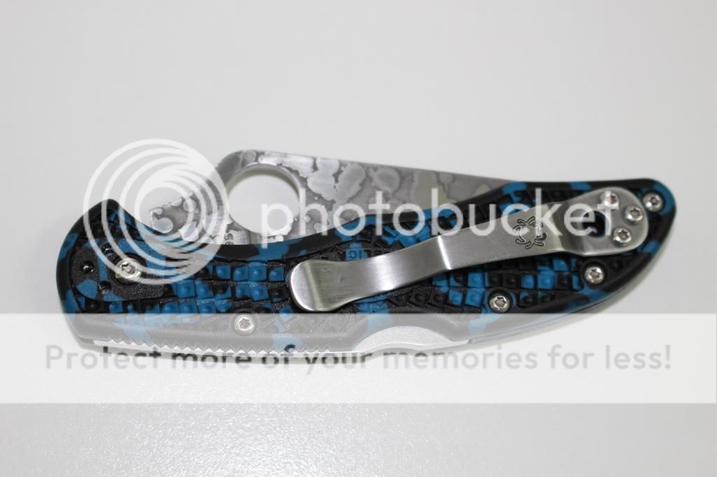

Well I have abused this knife regularly for a year now. Never once cleaned it or taken it apart. Holds an Edge like a razor for a good amount of time before needing resharpened.
Today after I got home from church I decided it was time to give her a little TLC

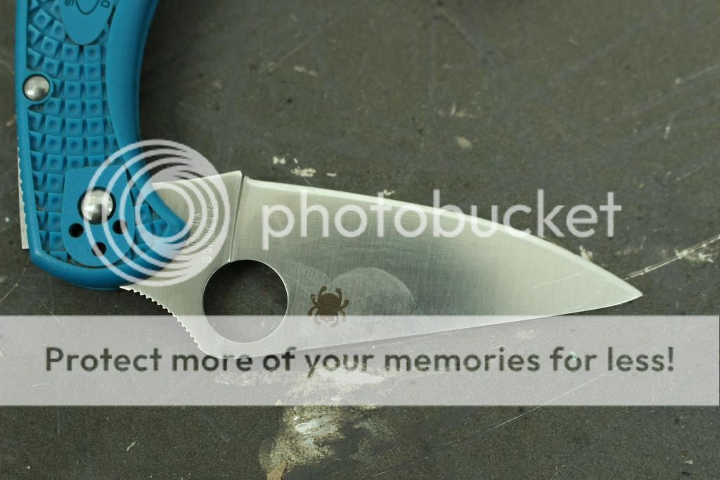

Here is how she looked when I started.

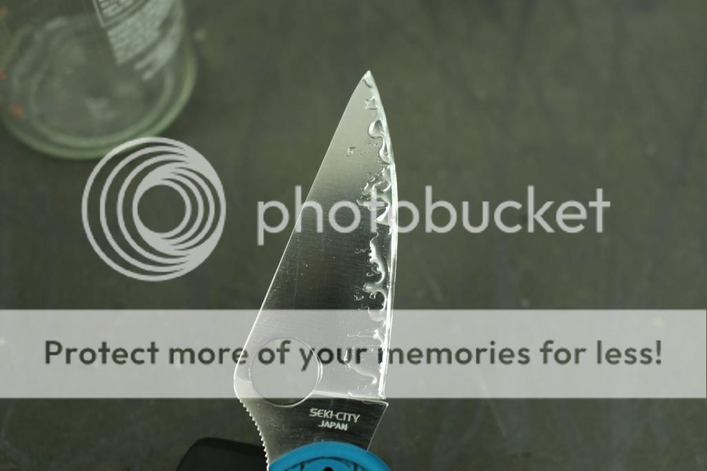

first thing I did was protect the edge from the acid etch with nail polish.

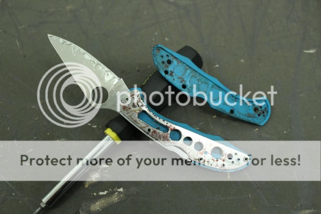

Then she came apart for a full detail job, You can see all the blood from the 1 elk, 4 Deer, And 1 Antelope I gutted with it last year.

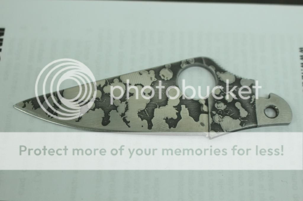

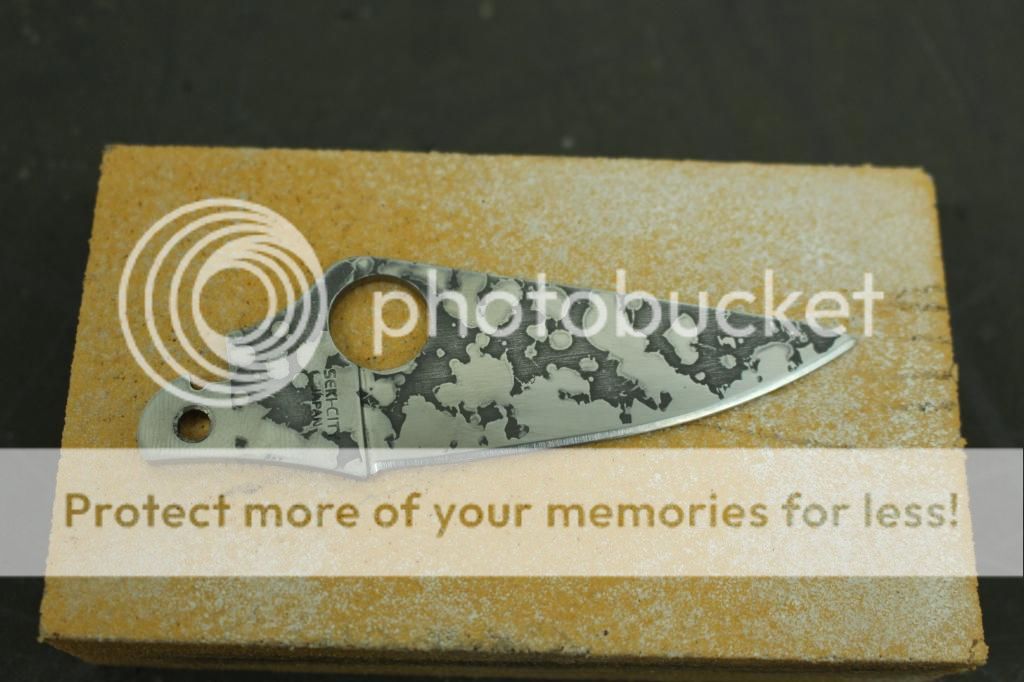

next I splattered candle wax on the blade before going in the PCB Etchant. (Sorry did not get a pic of that.)

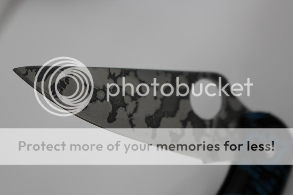

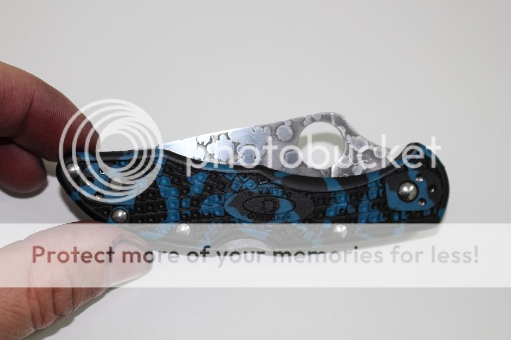

this is how the blade came out, (after hitting it with a little 1000 grit.)
then I moved on to the scales, Used some hot glue to make a pattern and put it in s RIT dye bath, I thought I screwed it up at first but i think it came out great!
Let me know what you think, Love it or hate it comments are welcome.

Rit dye is the best kept secret with g-10 and frn. I did almost exact same thing with my old southard scale. I gotta say I've never really liked the blue handles but the dye job you did looks 1000% cool
Handle and blade look matched to each other in the awesome pattern. Quality is absolutely top notch. THE BEST DELICA I'VE EVER SEEN!!! Go have a beer, bowl or a good nap as you deserve it!

Thanks guys, There are some Great Delicas out there so that really means a lot to me, RUM and Coke Tonight for me =]
Sweet delica, man! I would have done a different acid etch pattern, but beyond that I think it looks freaking awesome!
