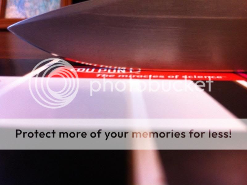

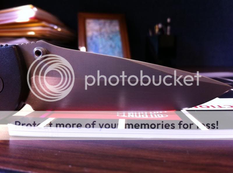

For the ultra rods, I guess I’m wondering if they will help much to get a nice, smooth and reflective edge, or if I’m better off with a strop after I finish with the standard Spyderco fine stones. Here’s an edge from an EDC Grip with a D2 blade. It cuts really well, and will also shave you in a single pass, so it’s not so much cutting performance, but I have found that the smoother and more reflective I get that final finish, the more cleanly my blades will work and so I’m considering the ultra stones.
Basically, are the diamond rods for my Sharpmaker a good investment, or would you think I’d be just as well off with a diamond benchstone for the occasional times I want more aggressive performance from a stone. Also, will the ultra fine rods be a good investment in terms of increased edge performance, or would I be better off with a good strop setup?
