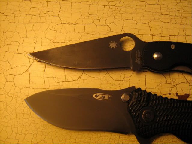

My Bechmade DLCs show more wear than my Kershaws and Spydercos. I have an all black Mille and 2 Delicas and 1 Endura with black blades, they have some smooth spots in the texture but no chipping or scratching what so ever and it has been used hhhhaarrrrrdddd!!!. For my Griptillian I cannot say the same but I love it anyway.
The BM grip does not have a DLC coating.
These two have seen LOTS of use and though the millie looks worn, its not, its just dirty.

Wow! This is very nice. I'm much more confident of the coating now. Awesome picture man.
Believe it or not but the ZT has (for testing and use) cut lots of drywall, carpet, regular cardboard, recycled cardboard (takes the edge OFF good 1095 in 6in), rope of all kinds, and many other things.You can see some wear when you look close but its still not through the coating yet. The millie is my brother's and I know he uses it a lot, its been his main knife for over a year now. I was wrong to say that there is no damage, he showed me a small mark on the back from cutting a pop can and the small grey specs don't seem to come off but it looks more like tin stuck to the surface :eek:
