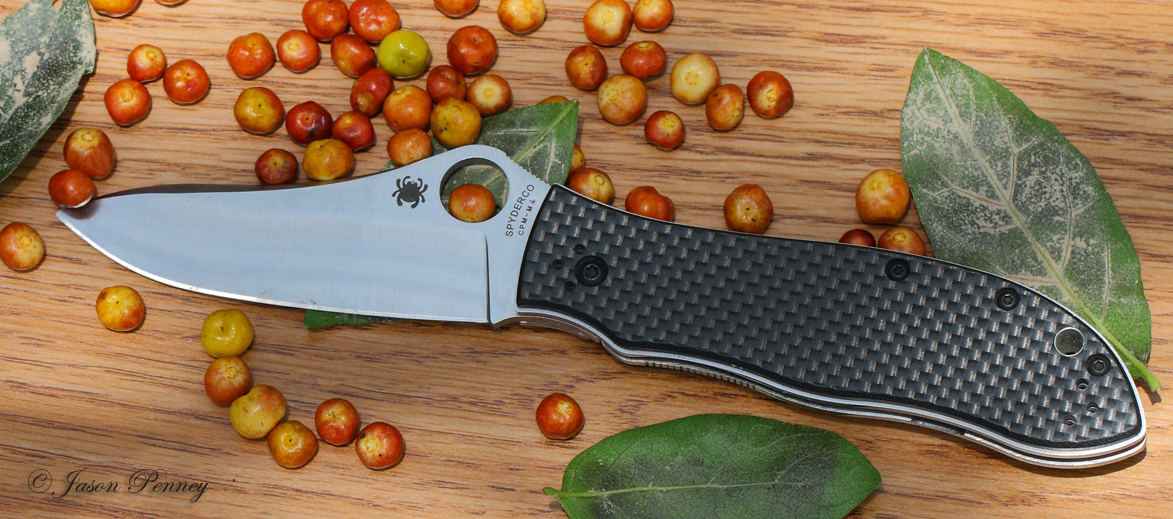

Thanks,..I'll try. It's just a pain to add the photos and text and have them come out the same way on a forum post. The photos come out very large but it seems I've hit a sore spot :) Anyway here's an attempt..

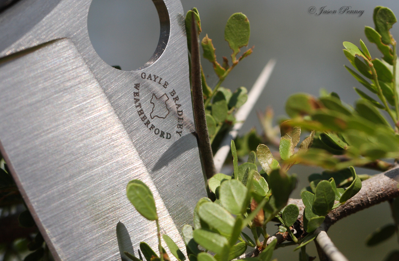

A while back, I was perusing the Spyderco website and came across a photo of a knife that had the shape of Texas emblazoned on it's blade along with Gayle Bradley - Weatherford above and below it. Being a Texan myself, I thought it was probably a violation of some obscure Texas law for a knife guy not to own this knife; we are a somewhat proud lot :) I saw that the steel was a type I had not owned previously so I thought it would probably be an interesting purchase, so I bought one.
A LITTLE BACKGROUND
Gayle Bradley is a Texan (obviously) from Weatherford who made his name in the knife world via custom knife making and winning cutting competitions with his blade designs. Being from Texas naturally makes him a bit smarter, a bit tougher and anything he makes would presumably be a bit better than knives made anywhere else in the world (that ought to get me some ugly emails). A collaboration with a fine knife maker like Spyderco should produce one heck of a knife. So purchasing this knife for anyone should be a no-brainer.

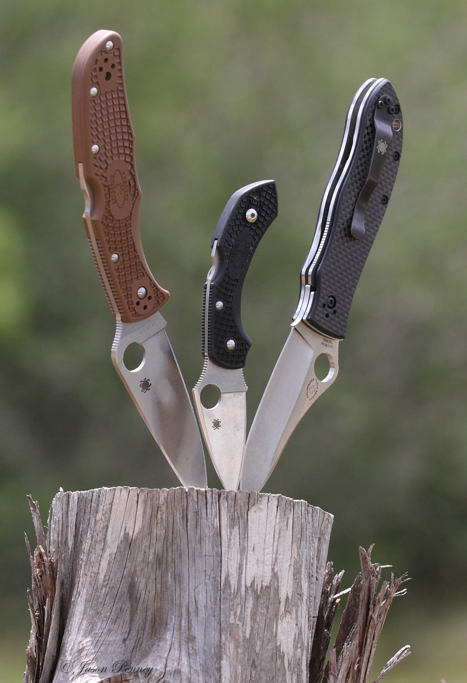

When I received the Spyderco Gayle Bradley in the mail and opened the box; handling it, I immediately thought of my Spyderco Chinook that I had purchased many years ago and still own. The Spyderco Chinook is the largest and beefiest Spyderco I own. I love the Chinook and it's toughness. So the fact that the Gayle Bradley's toughness reminded me of the Chinook is a very good thing.

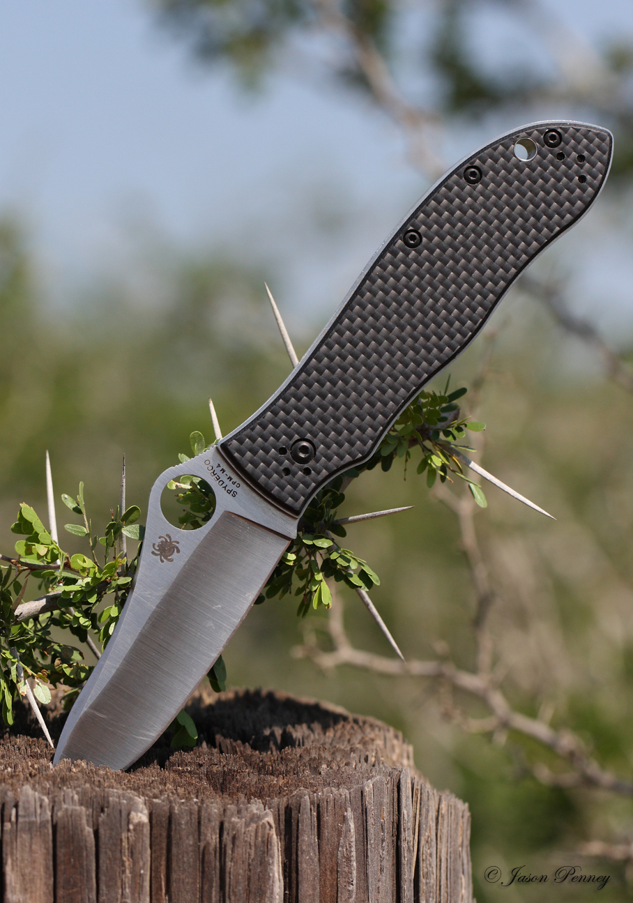

The Gayle Bradley uses twill Carbon Fiber for scales or it's handle. The Carbon fiber is nicely beveled along it's edges for comfort. I'll be the first to admit that prior to handling this knife, I've never been a big fan of Carbon Fiber Scales. In the knives I've handled previously, I found them more gimmicky than anything. Carbon Fiber works very well to conserve weight on my Cannondale Road bike and my wife's Specialized but I've never seen the utility in knife scale use. Well, Spyderco has changed my mind a bit with the scales on the Gayle Bradley. There is just enough texture to provide a good grip and the beveled edges make for a comfortable purchase under hard use. Well done Spyderco.
Underneath the Carbon Fiber Scales is a set of stainless steel liners that provide added strength and also contain the Michael Walker liner lock. The knife is constructed using torx screws to hold the scales and liners together which gives it a little added touch of class. The Gayle Bradley is an open back design which makes for easy cleaning. The standoffs (the parts between the two scales that the torx screws run through) are big and thick. One of the things I love on my Rick Hinderer XM-18 are the big standoffs and the Gayle Bradley's standoffs reminds me of those; and that too is a good thing.
The Blade is made from satin finished Crucible Steel CPM M4; or for the purposes of this article just M4. M4 is a very tough steel with excellent wear resistance. M4 is not a stainless steel and thus will rust if not taken care of. Many knife folks like to nip the rust monster in the butt by creating their own patina on their blades with everything from mustard to citrus fruits to moist coffee grounds. It all depends on the pattern or look that you're looking for. For me, I'll just do my regular cutting and let the patina develop on it's own. If you don't like rust or patina, I highly recommend Tuf Cloth . It beats back the rust and doesn't leave a nasty oily blade like other options available. Despite the rust potential, after using this M4 steel on everything from food to tree limbs to just whittling, M4 has held its edge VERY well and it STILL slices through paper with ease. I'm a new M4 fan; but I still like my stainless blades.

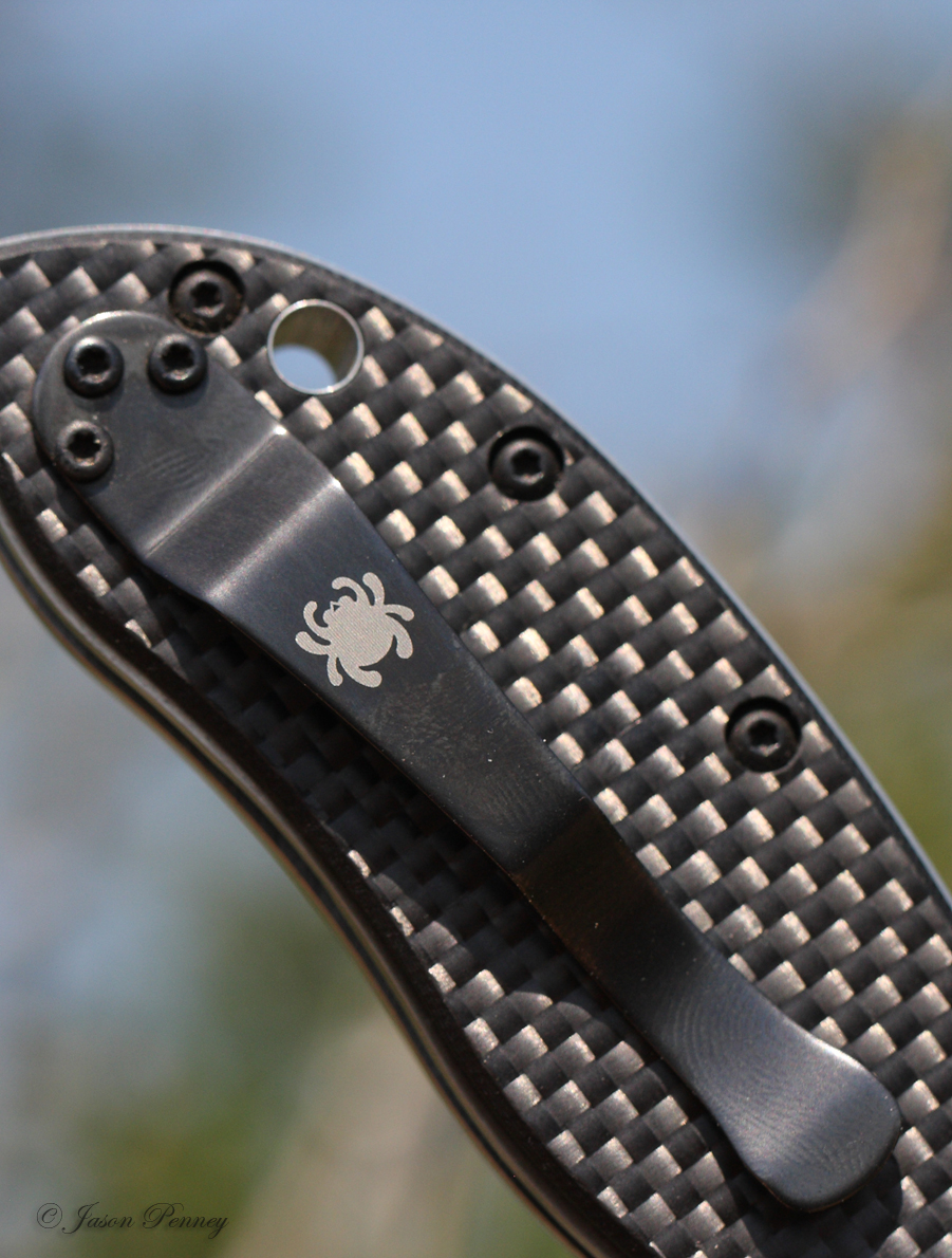

The pocket clip on the Gayle Bradley is almost perfect. It's long enough and has enough flex to get it in and out of the pocket with ease. The clip can also be moved to any of four positions, left, right, tip up or tip down.Spyderco almost always gets their clips right.

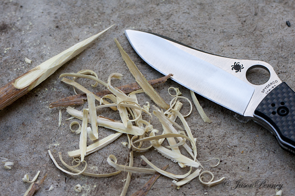

The modified drop point blade lends itself to good slicing and the M4 lends itself to hard use. In truth, the possibilities are endless; slicing, heavy cutting tasks, food prep, skinning, pruning, scraping thorns out, carving, whittling, you name it, this blade can do it. It's a great blade all the way around.
