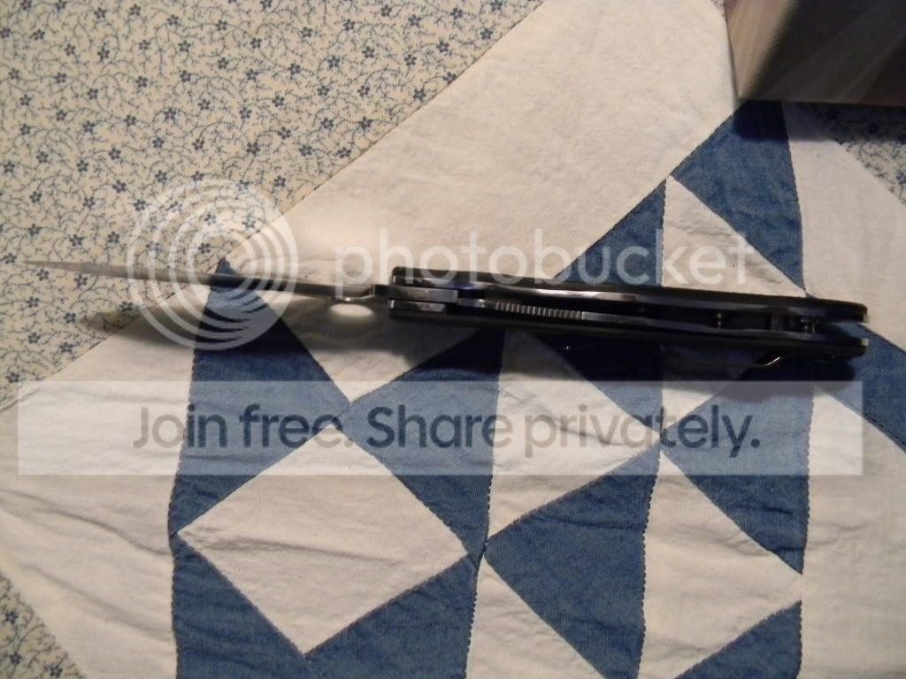

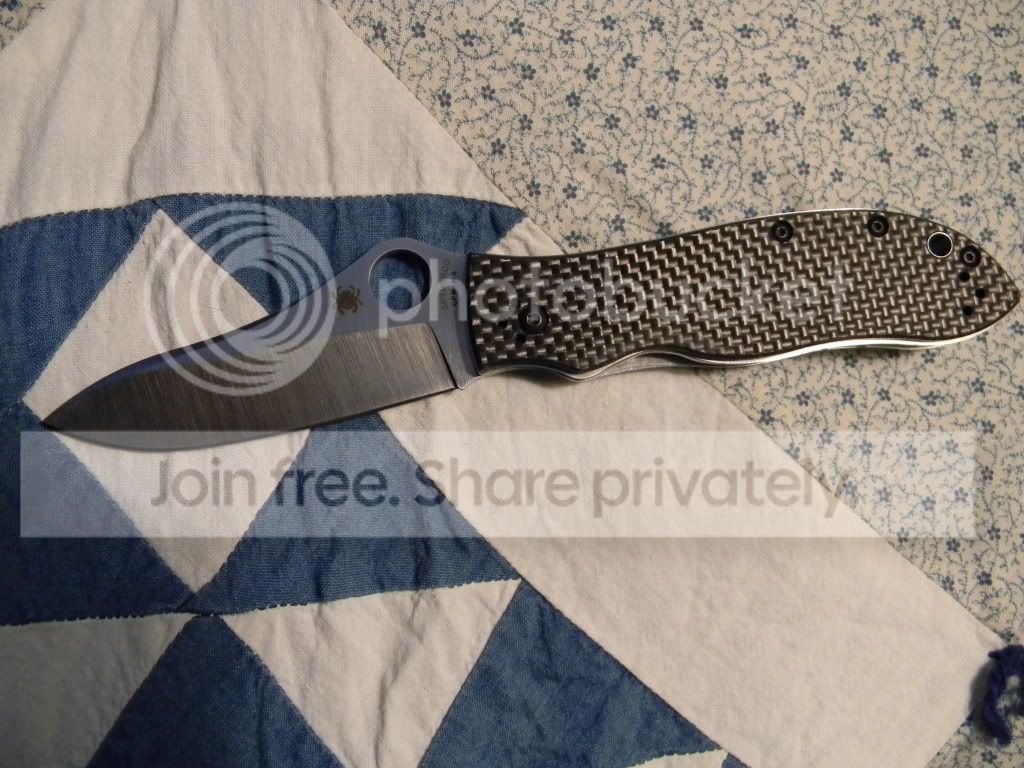

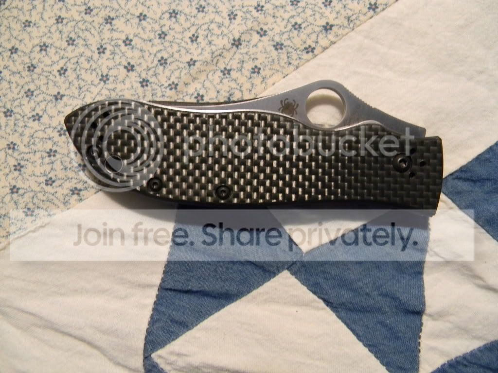

I am not sure if anyone has made a thread about this. I did a quick search and didn't find anything related.
First off let me say I love this knife! Its tough and a fine looking knife while doing it. I am happy with the knife except for a minor flaw in the design. I really have no idea how they over looked the Spydie hole being partially covered. It really made closing the knife a pain in the butt. So I finished a project from the honey do list and I thought what the hell I'll try this myself. I disassembled the knife and officially voided my warranty so there was no turning back at this point. I got out my dremel and got to work. I used a fairly abrasive stone to take most of the material away from the liner. I used a file on the carbon fiber for most of it and finished with a rubber wheel from my polishing kit. The file left the CF a very light gray and I thought I ruined it. I got the idea to use a rubber wheel attachment in a last ditch effort. The friction created enough heat to bring back the darker color.
I was really impressed how precise the knife was built and assembled. I must have partially assembled the knife 50+ times trying to get the liner and scales shaved down to my liking. Overall the process took a little over an hour to do clean up included. I am a little unhappy with the metal finish where I took the material away. I'm definitely going to spend some time polishing it up. Overall I am pretty happy with the results. It passes the function test and I will work on getting the finish 100%.

He did a helluva job! The only thing I want to do is get the liner polished a little more. I would love to know how he perfectly matched the CF bevel also. I really didn't put a whole lot of planning or thought into this one. I discussed it with richard j a few weeks back but pretty much wing'd it lol. I don't think I did bad on my first knive mod.
