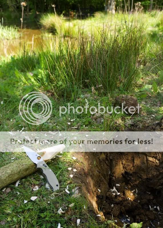

I truncated and flattened a piece of hazel for use as a digging stick, harvesting ramsons (wild garlic) while out with the dog. Smell of bluebells and garlic delightful:

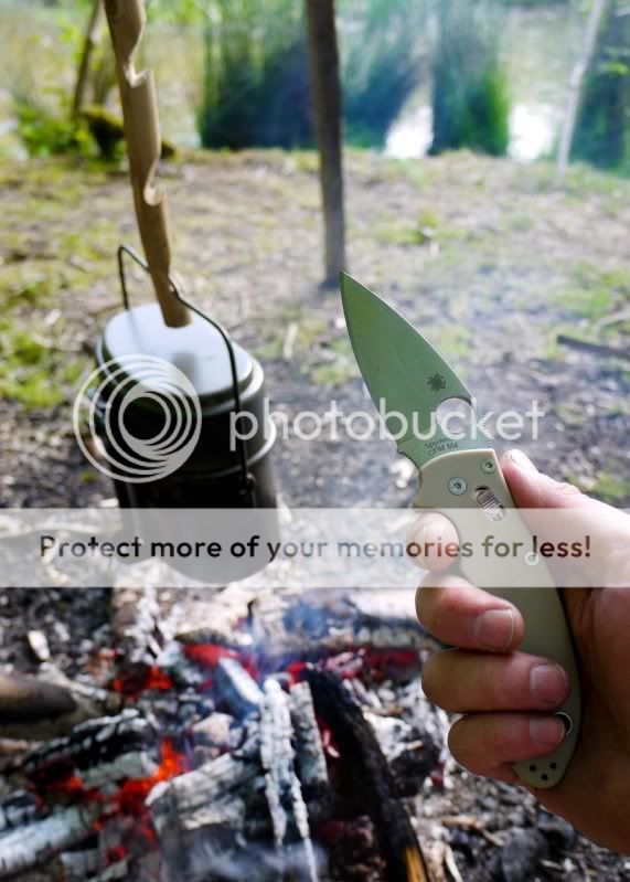

Whittled a pot hangar:

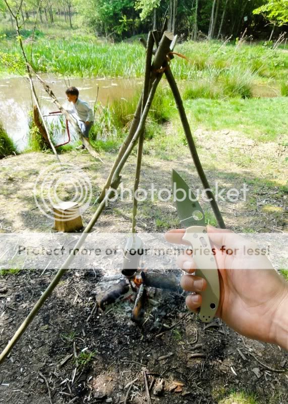

And got the grub on with a tripod:

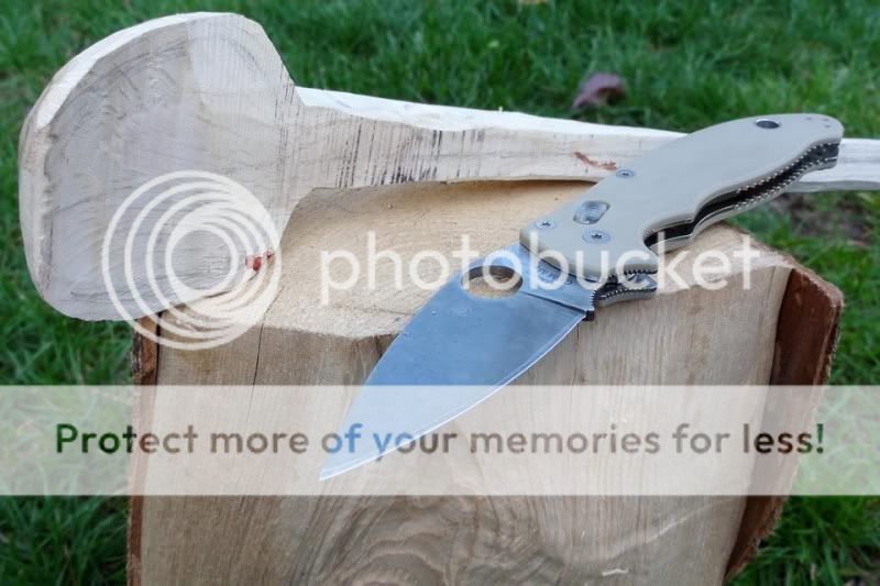

And did some carving (spoon and stake for tree-support etc.):

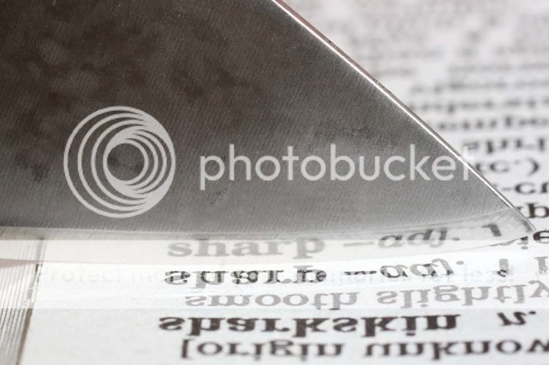

Running a finger nail up the side of the blade toward the edge there was a "catch" or hooking sensation on one side but not the other, reminiscent of a rolled/folded edge. I have tried to photograph this with a macro lens (not my forte) but I can't see an obvious roll:

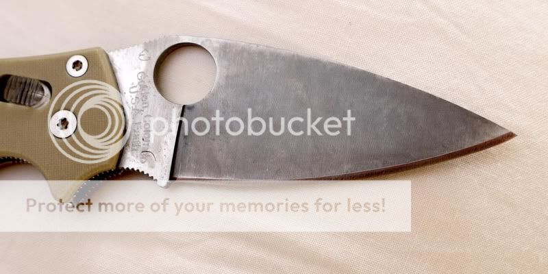

Since then I have sharpened at 40 deg inclusive- still hair-popping but should be less damage prone. The blade was developing an uneven patina so I have tried to even it up a bit by leaving the blade unwashed after cutting up onions and such:
