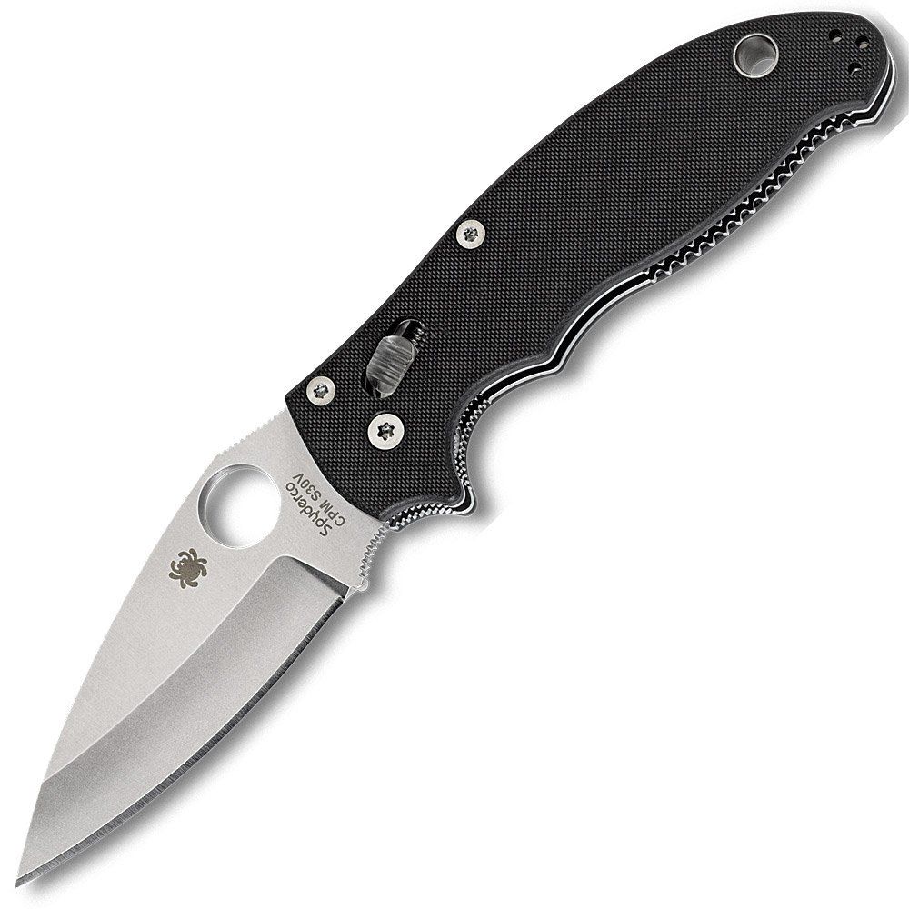

Spyderco Manix2
length: 8.00" open, 4.625" closed
blade: 154CM stainless
blade style: full flat ground
opening: Spydie Hole
lock: Spyderco's version of the "AXIS lock"
Price: $88.21 on Amazon

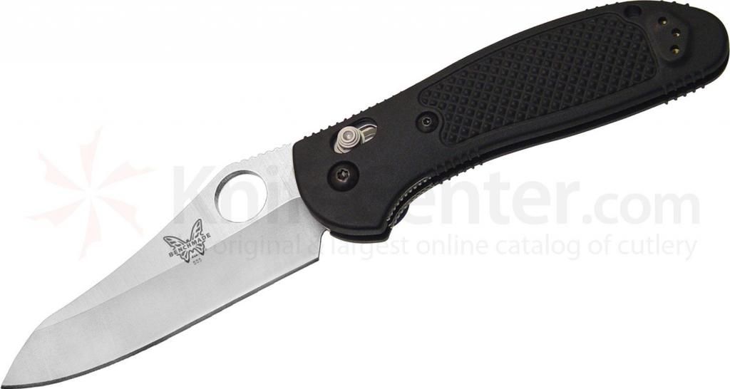

Benchmade 550HG
length: 8.07" open, 4.62" closed
blade style: hollowground modified sheepsfoot
opening: Benchmades version of the "Spydie Hole"
lock: AXIS lock
Price: $88.90 on Amazon

Benchmade Knife 550HG Griptilian Pardue Plain Edge
Folding Knife with Hole Opener and Black Handle
lock: AXIS lock
Spyderco Manix 2 G-10 Plain Edge Knife, Black
lock: AXIS lock
blade: 154CM stainless - The old ones were, the new ones are now upgraded to CPM-S30V
Price: $88.21 on Amazon - Look around for a better price, I see $83 at one of my usual knife shops. I've seen them on sale as well for around $75

If you decide on a new Manix 2, you'll most likely get a blade in CPM S30V (as in the picture you posted), which replaced the 154CM version some time ago. The newest poduction models come with a FFG blade, although the saber ground blades are still available, in a few places, for the time being.
