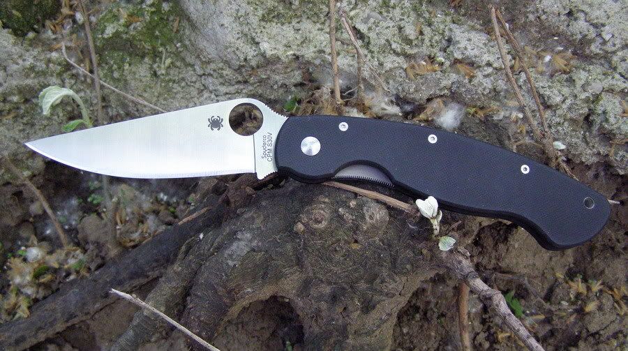

Hello everyone.
Just received the knife and wanted to share some thoughts with everyone who's interested.
The background: I like folders. I own a small classic micarta Sebbie and a MOD CQD Mk1 Auto (I also love Busses, but that's beside the point). So the Millie's got some serious competition. While it might not be fair comparing it with the Seb, the MSRP is almost up there (street price, of course, being much lower, while the Seb retails for what the sticker says). So, without further ado:
Darn, I got an empty box. No, wait, the knife is in there. Wow, this thing is huge. Wow, it's featherweight. It fits in hand perfectly, both in standard and reverse grip. The carbon handles are very rough to the touch without being nail-file-like. There's no way to lose a grip on this knife. It opens smoothly, the lockup is solid, there's no blade play. The blade is (almost) perfectly centered. It is sharp, the grind is level and smooth, but not perfect. It does shave hair, but not as well as my carefully sharpened Sebbie or CQD.
Okay, unfair comparisons time: while the Seb feels like a jeweled vault, the Millie doesn't - mostly because it is deceptively light due to carbon handles with nested liner. The lock covers about one quarter of the blade tang (that's also how wide the liner is), compared to about 3/4 cover on the Seb - and the liner is as thick as the blade. There's no point in comparing Millie to CQD as the latter is not a liner lock and looks extremely aggresive. The Millie, on the other hand - despite the size - looks comparatively benign. Not sheeple-friendly, mind you, but far less likely to make anyone scream.
Overall first impression? I love it and I can wholeheartedly believe the story about Mr. Glesser designing this bad boy as a tool for his son, should he be enlisted. This incarnation of Millie offers best of the best - an exotic sintered steel alloy (the best currently offered by CPM), carbon fiber handles, solid nested liner lock. I seriously believe that for the price, you can't do any better.
It's not EDC for city use by any reasonable stretch of imagination (the Seb fills that role perfectly), but it will be delegated (when not in use) to an outside clip-on duty for my SHTF scenario Maxpedition pack. This knife means business all the way.
Two tumbs up!
Cheers, Rok

you will find your self needing diamond hones and strop paste to sharpen it but it gets stupid sharp and stays that way longer than any knife I've ever seen. I did a manila rope cut test the other day (3/4in) and needed more than the 40 feet I got to loose the shaving edge, after I had no more rope to free cut I took some cut peices to the bench and started saw cutting. Using a sawing action I was finally able to dull the millie but even dull it still wanted to cut.

Actually, I just found out that Edgepro will do the trick for the more serious sharpening, while touching up on the fine and very fine stones on Sharpmaker is quite feasible (albeit three to four times slower than, say, for a Seb or CQD - the latter is 154 cm). It's polishing the edge with mylar tape that's not quite as easy as with "meager" S30V.

Actually, polishing the edge is not difficult at all, but getting it hair-whittling sharp is a PITA.
Good job with the review man. I have the one in S30V, ergonomics are fantastic.
Kind of big for EDC, Benchmade 710 is better.

It has a huge amount of vanadium, which translates into a large volume of big, ugly, hard, devil-worshipping vanadium carbides. That's why I love it! I sharpen mine freehand on DMT diamond hones, because vanadium carbide is harder than a lot of common abrasives. That, and because I sharpen everything with a plain edge freehand on DMT diamond hones. I have no trouble sharpening it, but it does take longer.
The spyderco ceramics leave a large bur thats hard to get off. I also use DMT stones for my S90V millie they work alot better than the ceramics but to finish the blade you need diamond paste on leather, CrO does nothing. If you properly strop your millie it will easily tree top a hair.
I find S90V to be fairly easy to sharpen but I also have the right tools, I would say it sharpens similar to S30V but takes much longer to polish.
I've got the Millie in s60v, which was called CPM 4440v back in the day. Harder to sharpen than s30v, for sure. You know, for me the Millie would be such a winner with only two design changes - if the front of the handle had the same "drop" as the back end, and if the handle didn't have this huge cut out so that any firm grip + twist to the right will release the liner lock. It's not like it's hard to close a knife without that huge cutout, like a Pro Hunter, or Lone Wolf T2, for instance; it just makes it a far less reliable lock.
