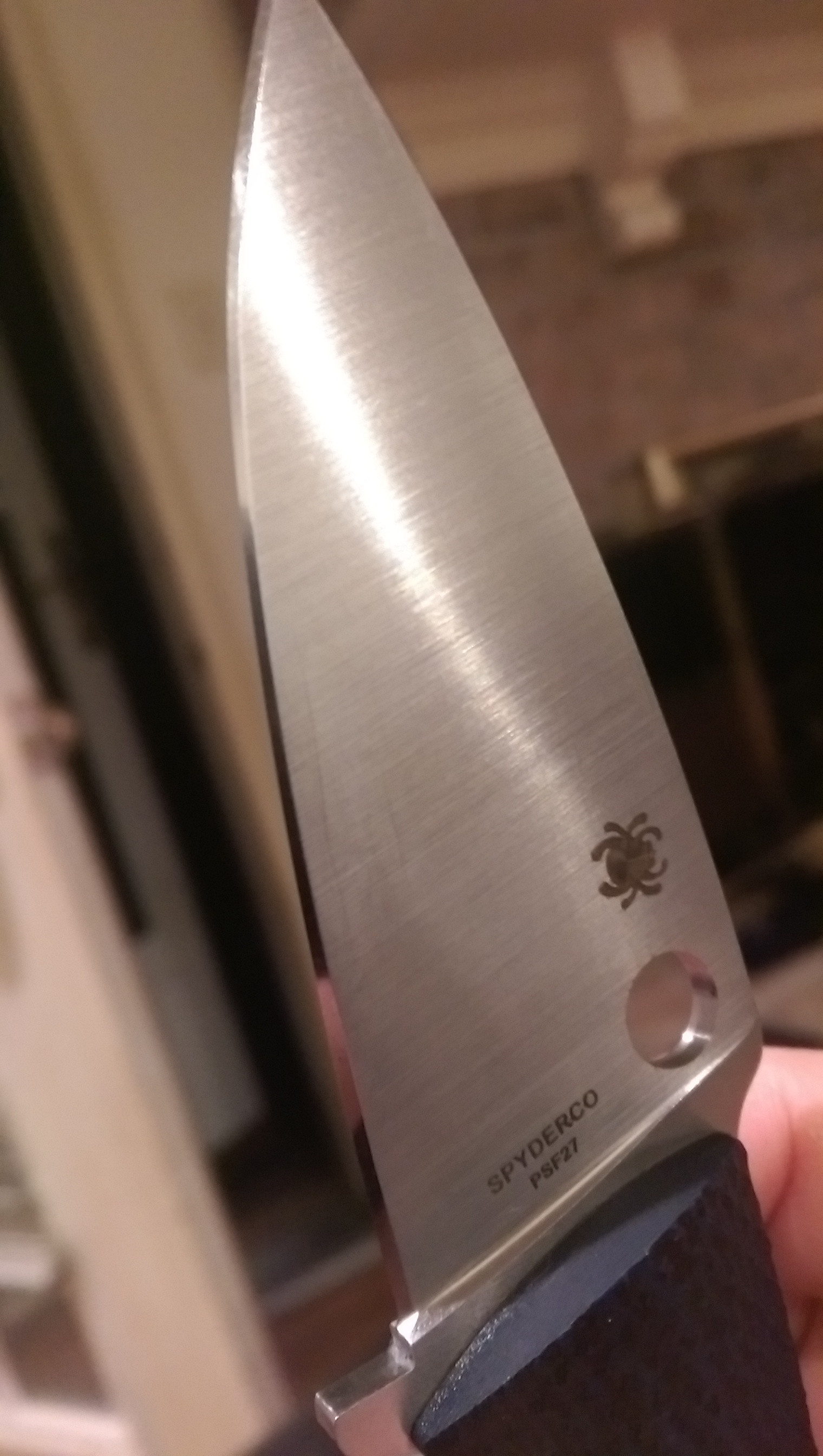

PSF27 steel, rounded halpern scales.
Sorry I don't have photos to post, it was a dirty, muddy day with the dogs out in the woods after a hard rain yesterday. I haven't seen many reviews for PSF27 so I thought I'd post some quick thoughts about the performance. I sharpened it to 15 degrees per side up to a 1500 grit stone followed by diapaste strop compound up to 14000 grit. Near mirror finish and could whittle hair. I have cut up probably 20 good sized, thick cardboard boxes and cut maybe 40 pallet straps before today and haven't stropped or resharpened since the initial sharpening. It's been about a month since I've sharpened it. I live about 20 miles from the Atlantic ocean. I've not lubed it or anything aside from some simicrome polish I used when I first got it. There has been no spotting or rust noticed.
First, I went out to the woods and chopped down a 4 inch tree with it, handled it well enough for such a small blade. No slicing type cuts, it was all chopping.
Then I picked up an old four to five foot piece of dead hard wood with probably 6 good sized knots, between half an inch and two inches each. I carved, stabbed, and whittled each knot out of the limb and then rounded one end and sharpened the other. I stabbed, twisted, gouged, and chopped into the knots. I batoned into the limb and twisted out chunks of wood. I smoothed all rough surfaces by whittling.
I carved my wife's initials and mine into a tree.
I went home and deboned a refrigerated, cooked chicken. Normally I try to keep from scraping against refrigerated cooked bones but this time I cut and scraped as much as I could. I split the chicken in half. I split a leg bone for the hell of it.
After all that, I see only two small sections, maybe the width of a needle each, of the edge that rolled very slightly. The knife can still barely shave arm hair and can cleanly slice printer paper at three inches from my fingers, the knife can still roughly push cut about half an inch from my fingers except on the small rolled sections. I wasn't easy on the knife at all. To compare, I've done pretty similar things to a ZT 0561 with elmax and a spyderco military with S30V and those edges rolled a good deal easier. The only steel I've had chip on me is benchmade's 154cm and ZT's S110V. So far, this psf27 steel is good to go but it was almost as hard to sharpen as the thick S110V on the ZT 0560CBCF.
Hope this amateurish review helps. For about 110 bucks for the blade and handles, it's a very good knife for the money.

I finally got my MT19 up and going, with canvas micarta scales. The PSF27 blade has been a pleasant surprise. Sharpening was a breeze with my KME and the Gold series diamond stones. I'm thinking about picking up another just to have around.

Well, as an update I took the scales off and found fairly significant surface rust with no pitting. I sanded it off and there was a little bit of staining left over. I covered it with a thick layer of frog lube and threw it back together. The blade did well being worn and stored in a kydex sheath but the scales kept enough moisture in to cause significant damage if left unprotected. I don't think it was unreasonable and I saw what I needed to see after leaving the knife unprotected without any kind of corrosion resistant product. That's a month or so being left unprotected, washed a couple of times, and being basically neglected living 20 miles to the ocean and working within feet of it. Definitely need to keep an eye on it but there's no need to be obsessed with keeping it clean and dry.
