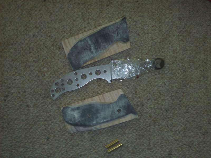

Here is a spyderco mule blank I have just had some fun with. More practice for me on the grinder.
Tiger maple with black liners. I love this wood its my favourite handle material.
This blank design was a real PITA. Gonna be a sweet user blade.
The last pic shows a small slip up. shaved the skin of my thumb with a touch. It was close..
Hope you like it. I do :D

Can you explain how you pinned the scales to the knife?

Well the blade is epoxyed and the brass pins stop movement.
Literally I just glued the parts in the first pic together. Plenty of epoxy and then clamps to ensure a tight fit.
The fibre scaled were expoxy'd prior to the final glue.

Cost wise you cant really beat them as I got my blank for $50 and the scales were $10. Maybe throw in another $15 for brass pins and epoxy and liner material.
I buy in larger quantities though which gets part prices down. I'd say this knife cost $75 max.
It was a pain on my grinder. I should have used my dremel for the tight handle radius's but you live you learn.. :D
