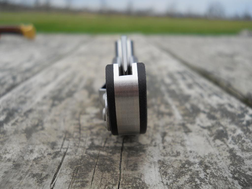

The Native 5 isnt small, but it also isnt big.
It feels very solid, and has a "quality" hefty feel.
Some people may find this knife a bit heavy at 3.7 ounces, but I enjoy it. I don't like light knives that much.
Skeletonized stainless liners.
The blade is 3 inches, and its overall length is 6.9 inches.
The blade is 3mm thick.

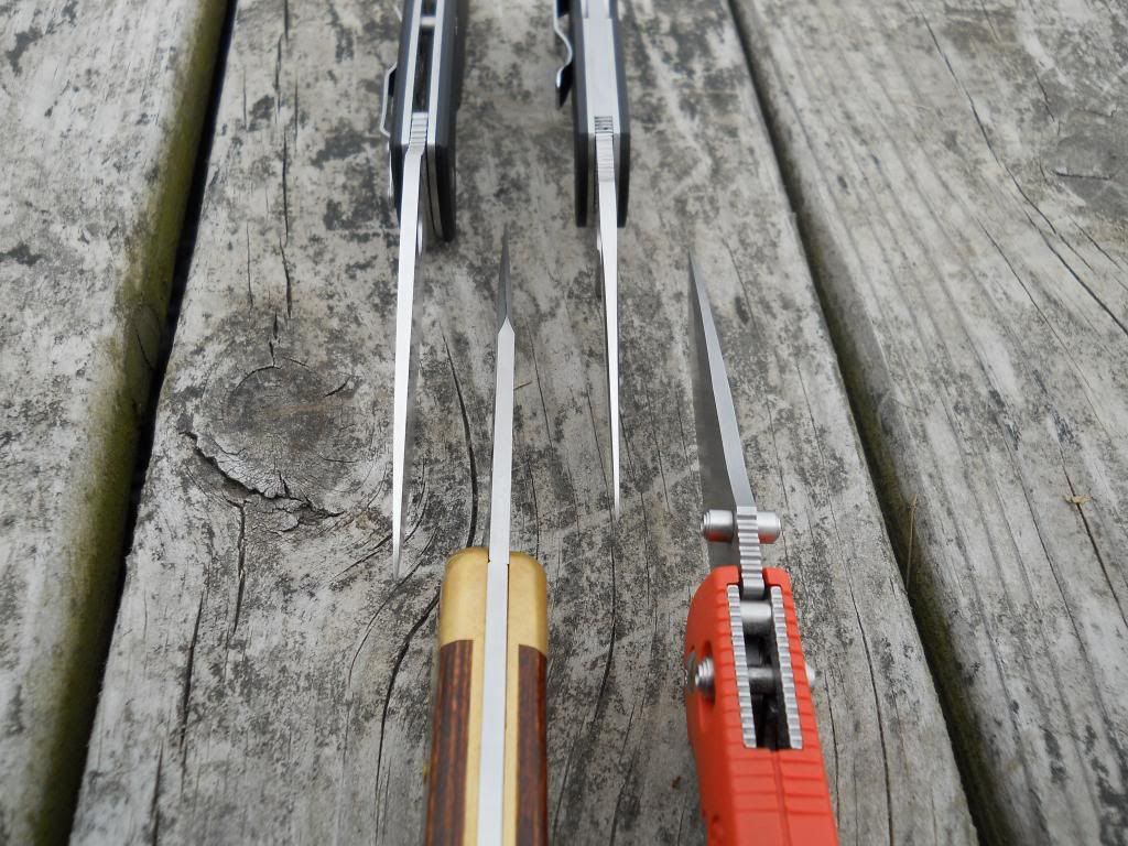

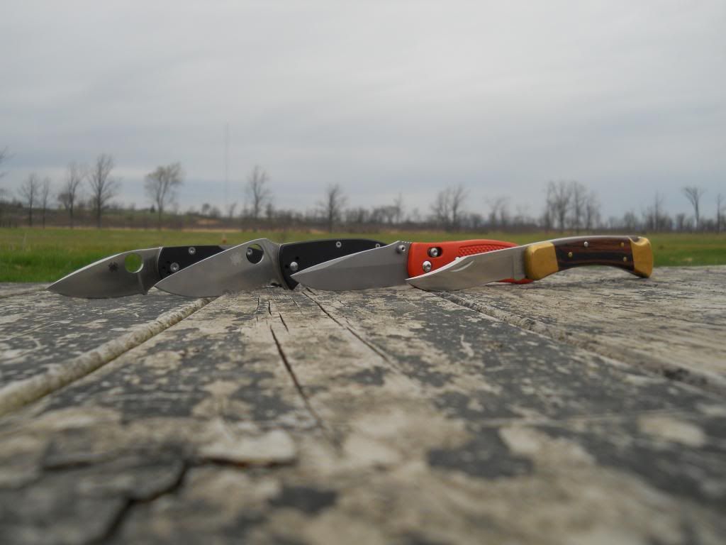

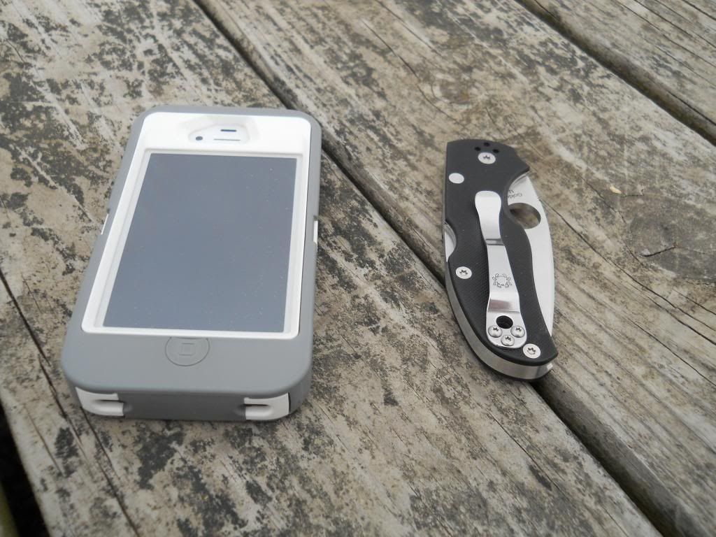

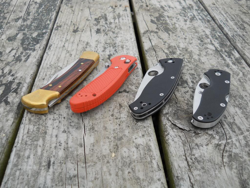

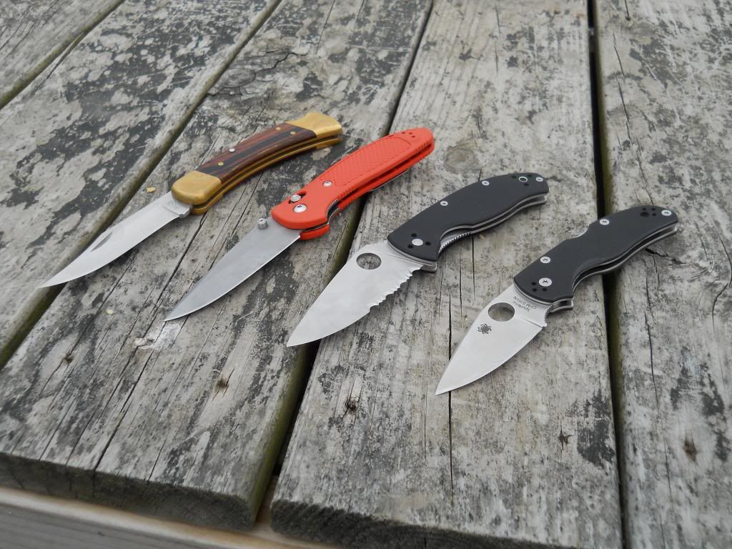

Compared to a Benchmade Griptilian, A BUCK 110, a Spyderco Tenacious, and an iPhone 4.

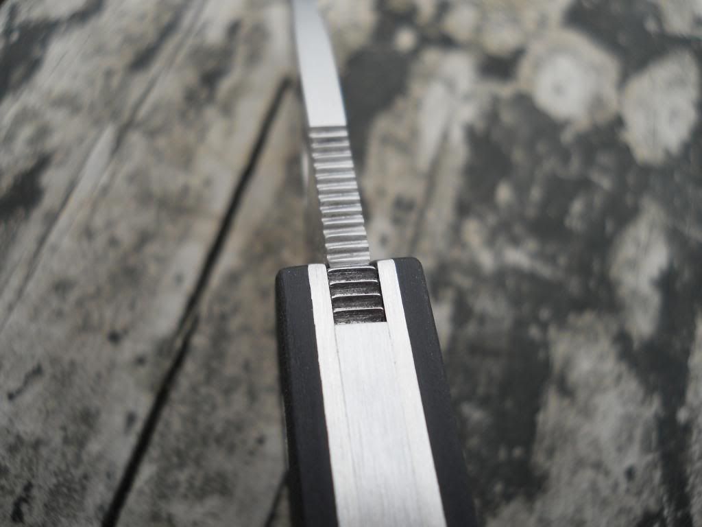

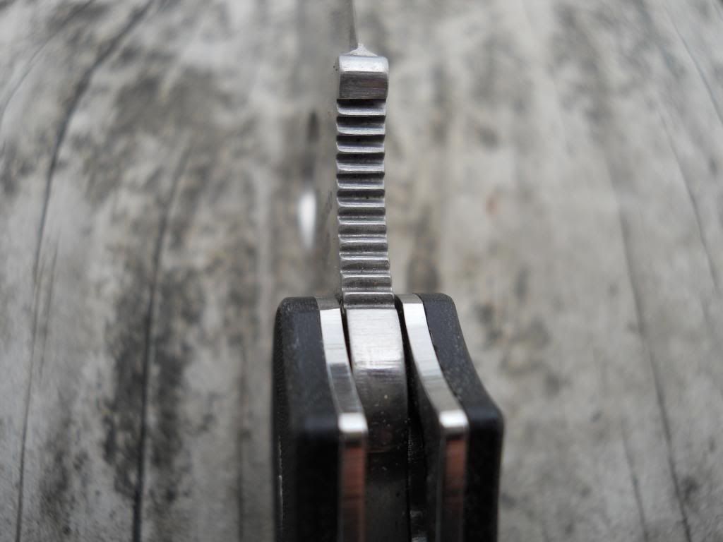

The jimping is really grippy, and is even on the lockbar.

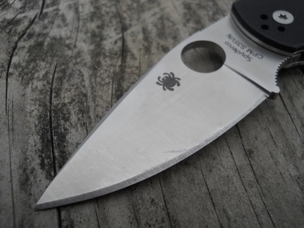

The FFG slices excellently.

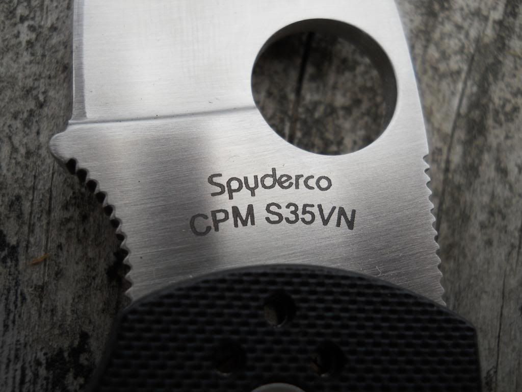

The CPM S35VN holds its edge extremely well. I spent over an hour slicing cardboard, and it didnt lose its edge. I was amazed. :thumbup:

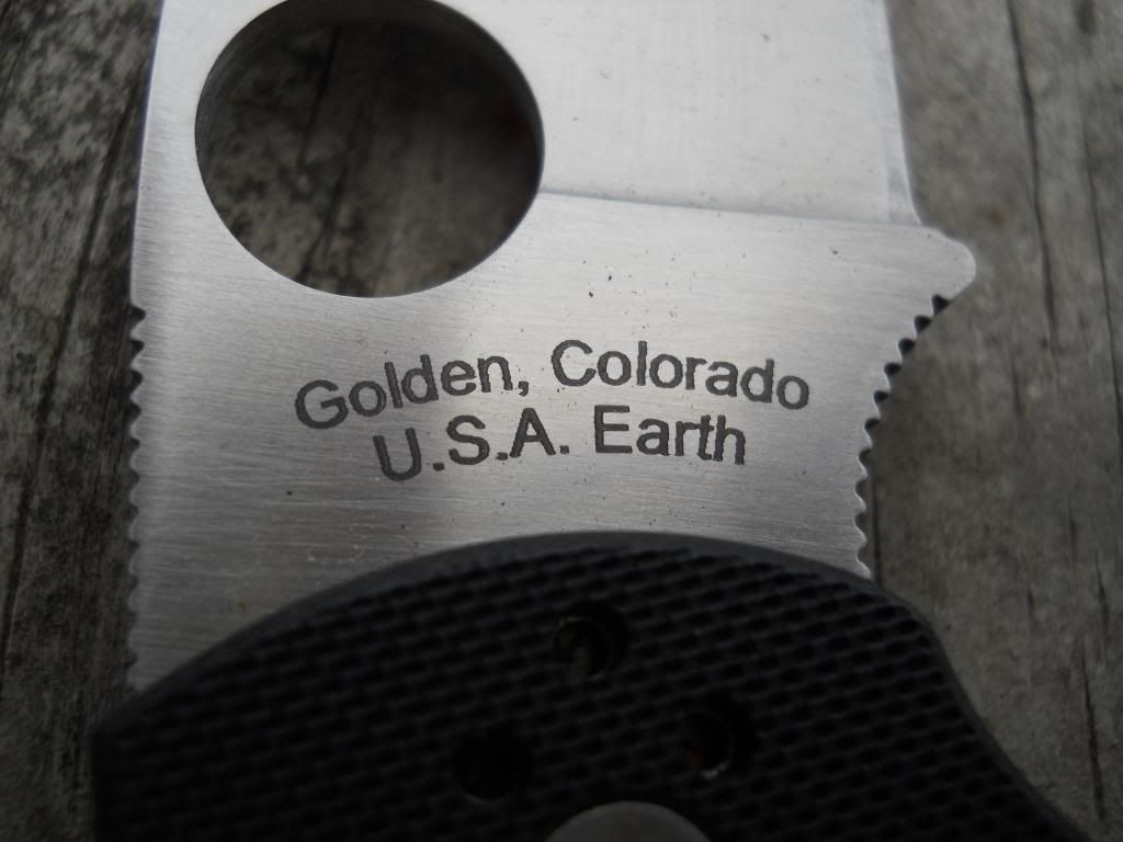

Made in USA.

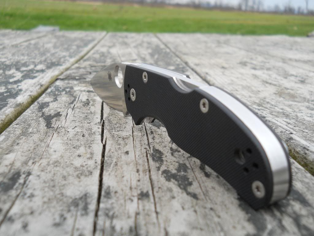

The fit and finish is outstanding. There are no gaps ANYWHERE, and the blade is perfectly centered.

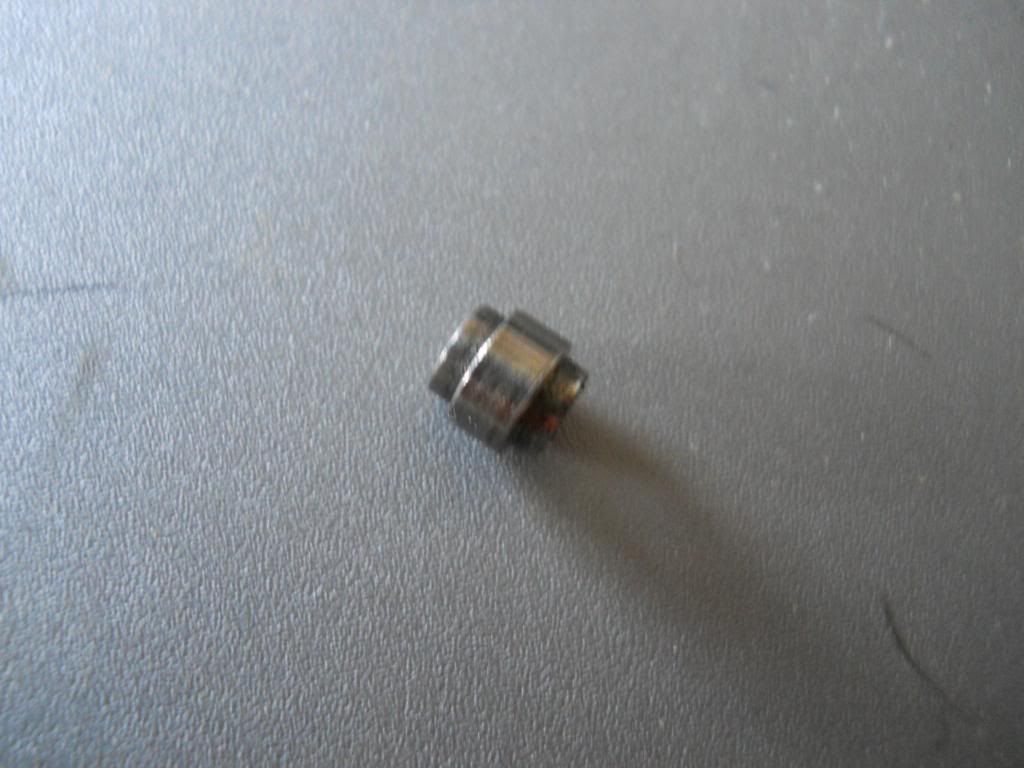

It was hard to find the perfect spot in pivot tension, (The pivot bushing means that there is a male-screw on both sides of the pivot) having a screw on both sides can make adjusting more difficult than usual.

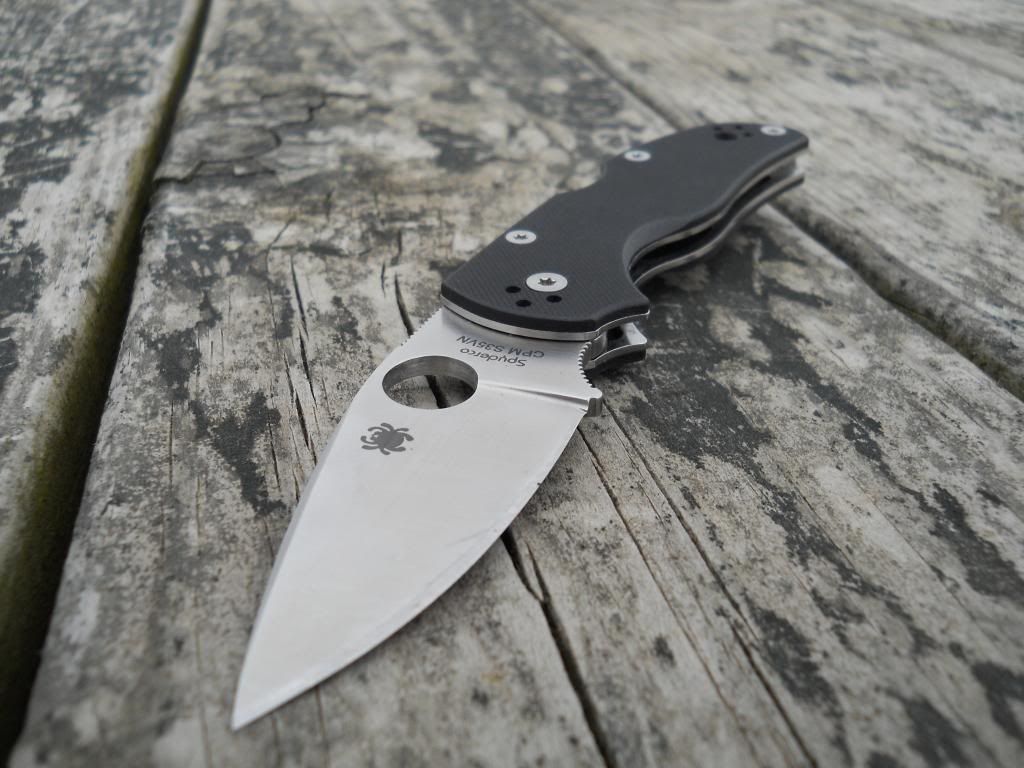

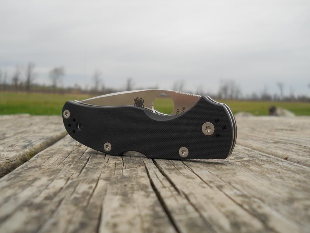

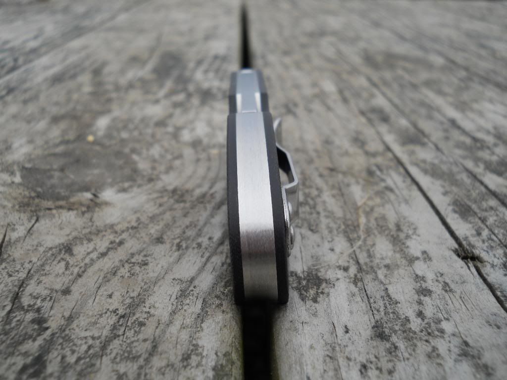

Overall, this knife is outstanding. Holding this knife in person will truly do more justice than these pictures can do. And with using it, you will be sold.
Ohhhhh yeah, I definitely reccomend this!
Some more random pictures for you all.

Now, some people say that with a pivot bushing, you tighten it down all the way. This is somewhat true.
If it is tightened down all the way, it still opens smooth, but the handle detent is nonexistent. (Nothing holding it closed, because the pivot is tighter than the lock-spring tension).
Its perfect spot is JUST loosened down from full tight.
But It still wont free-fall. It takes a light downward flick.

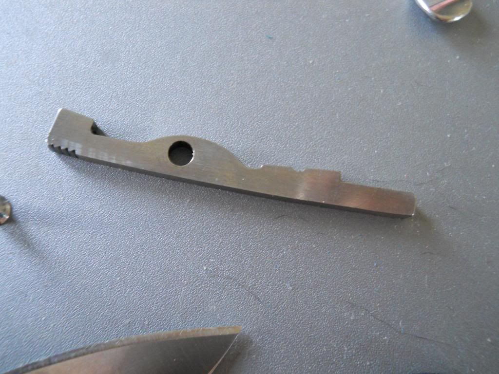

I had a long, boring day off yesterday, so alot of time was available for my knives.

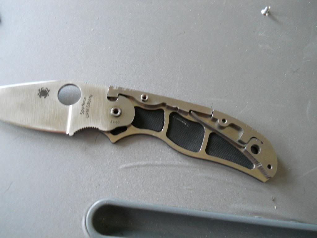

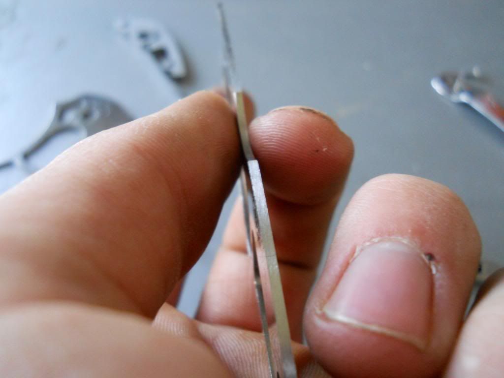

I spent a while with some Torx Drivers and gun-oil.
I messed with the pivot screw and the lockbar-tensioning screw.
It now free-falls, and has a much better handle detent.
Dis-assembly Pics!
I would like to add that there was a TON of loctite on EVERY screw. All of them. Even the clip screws. For the most part, corners were rounded but there was a couple of rough spots. Out of every part, the blade was the cleanest cut and polished.
After reassembly, the pivot bushing screws were less of a mystery. I tightened them down evenly on both sides and was ok.
