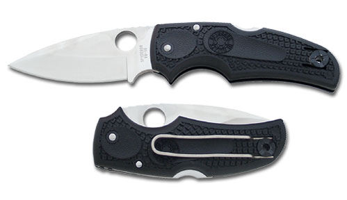

No, this isn't the Native you're used to. It's not S30V. It doesn't have the blcky jimping. It doesn't have a solid pocket clip. And it doesn't have the spiderweb handle texture. This is the Vg-10 Spyderco Native III, model number C78PBK. I chose this because I actually prefer VG-10 to S30V, and the knives are very close in price ($51 for the S30V version and $56 for the VG-10 version). The Native III weighs in at 2.8 ounces.
Here are the details...
The Handle: The Native III's handle is made of grippy black FRN in Spyderco's trademark Bi-Directional texture, similar to their Volcano Grip. It's 4" long closed and 1/2" thick. The choil is the same shape, size, and location as the S30V version of the Native, and does its job efficiently. Other differences in the handle include jimping on the butt for a really secure grip in reverse grip, and shallow grooves on each side. These help with indexing the handle when drawing from your pocket. The pocket clip is also different; it's a wire clip instead of a solid piece of steel. It's reversible for tip up carry, left or right handed. It can be removed with a coin or large Phillips screwdriver. The clip is pretty good: it's tight enough without being too tight, it's high enough without being too high, and it's out of the way when using the knife.
As big of a fan as I am of the S30V Native, I'm an even bigger fan of this one. The handle feels much more comfortable, and I've always loved Spyderco's wire clips.
The knife locks open via lockback, and it's located in the middle of the handle. It has the David Boye dent in it, which reduces weight by a tiny bit and gives you a groove to use as an index for closing the knife. Find the groove and push to close the knife; no guessing in the dark.

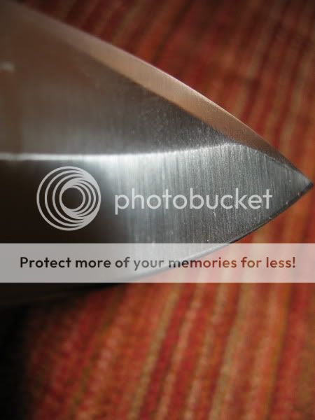

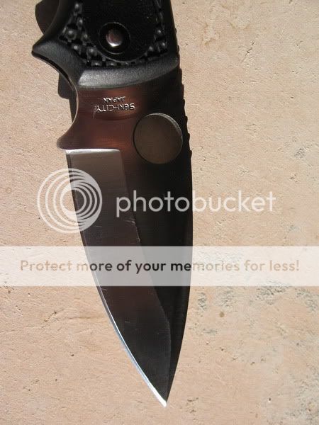

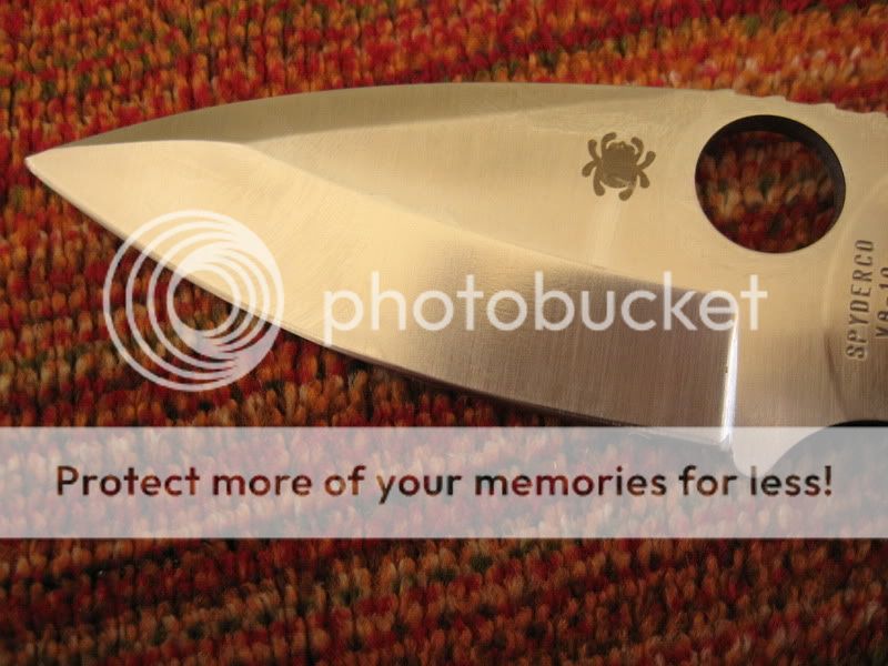

The Blade: The blade is the same size and shape of the other Native's blade; a spear point with a swedge. It's made of VG-10, and is 3-1/8" long (2-5/8" edge). It's 1/8" thick. The opening hole is just under 1/2" in diameter, and is comfortable to use. No sharp edges on this one, and although the hole is still partially covered by the handle, it's smooth and fast to open. Being made of VG-10, the blade also mentions that it's made in Seki City, Japan. Instead of the blocked, recessed jimping on the back of the blade, it's a different design; aggressive rear-leaning steps. They're spaced farther apart than the blockier ones on the S30V Native, and they're more aggressive. I find them to be much more useful.
The blade came out of the box shaving sharp and needed no touch-up. After slicing a few cardboard boxes up, it still shaved. The grind is a very shallow hollow grind, which at first I mistook for a flat grind. The swedge is a bit different; it goes farther back on the blade and isn't as pronounced. On the S30V Native, you could do some honing and have a sharp back edge, but the Native III won't allow this easily because the swedge is thicker and is more to reduce weight than for weaponization. The pivot pin is pinned and not adjustable, but it doesn't need any adjustment. Mine is perfect; not too loose and not too tight. I can SpyderDrop it easily, and it won't shake open.
