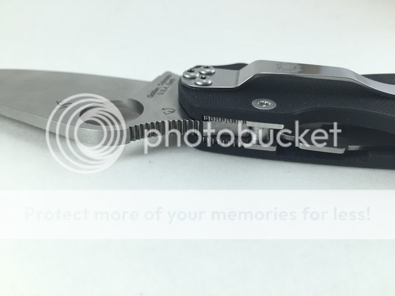

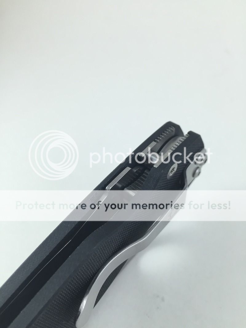

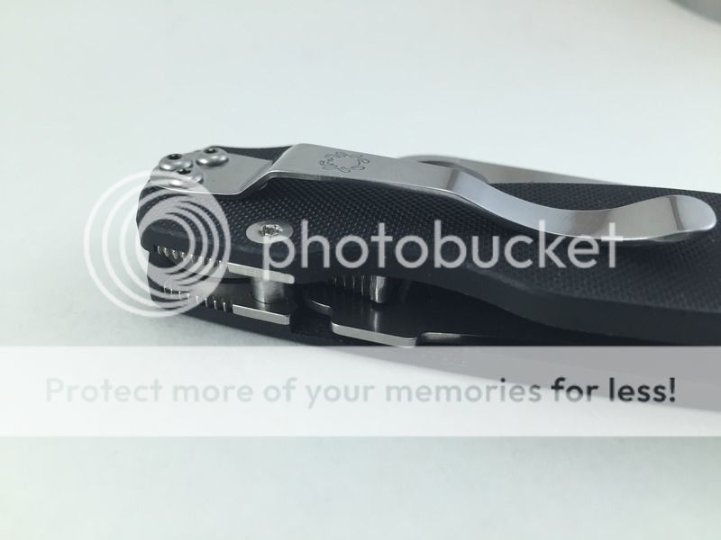

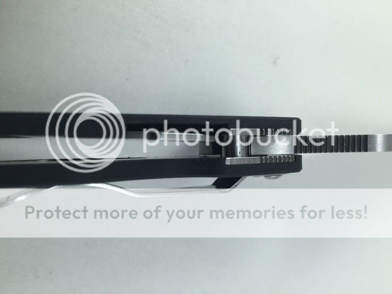

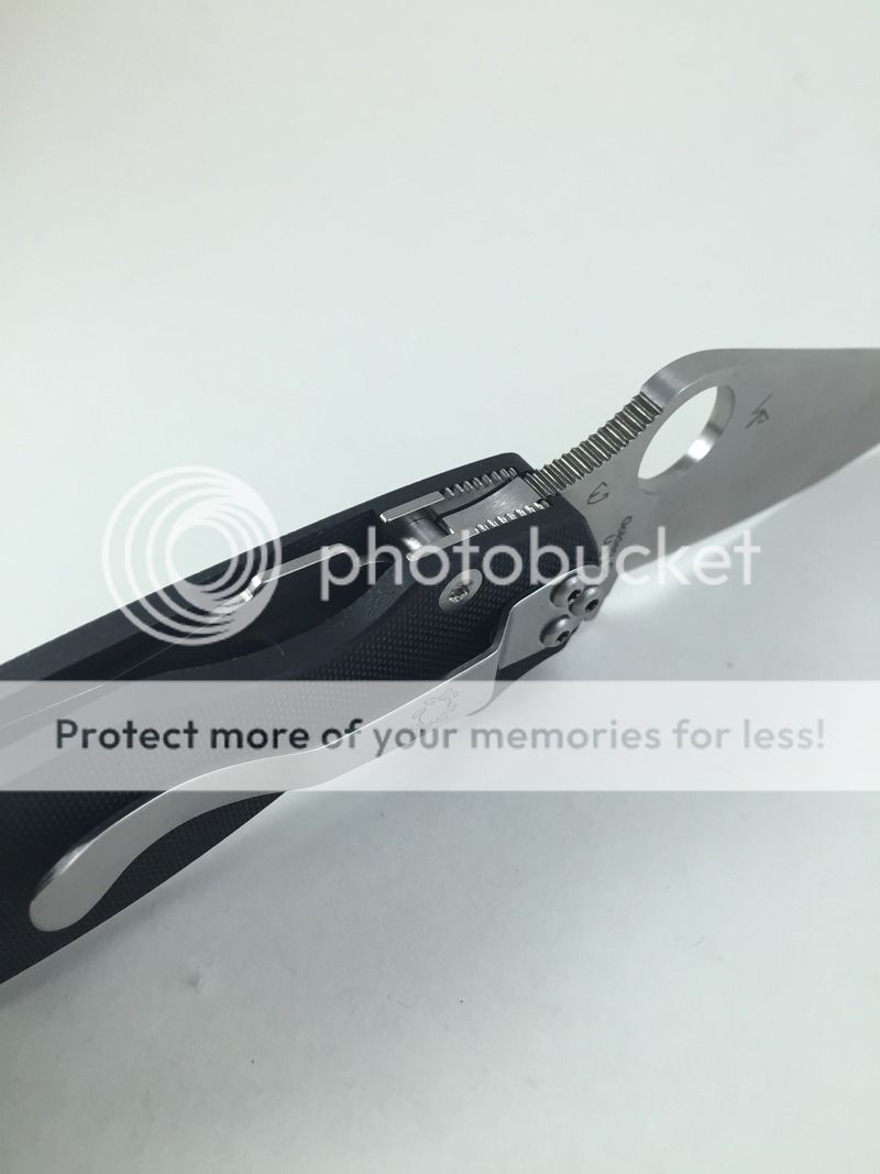

Where did you get it from? Can you post pictures of the jimping on the top of the blade and the lock cut out or make another video with close ups on these two spots)?
I have seen two fake PM2s and they were both super stiff. Not saying yours is fake but I would want to rule that out super quick.

Where did you get it from? Post pics of the lock cut out please.

I agree that you should try to figure out for sure if your knife is a legit Spyderco knife or a counterfeit. There are plenty of fakes out there like everyone said. I've never used one so I can't say how they feel compared to a real one. But the real ones are known for being super smooth and if you can't get yours to that point I think that is certainly suspect, or just bad luck. I put a few drops of CLP down towards the pivot on my knife. Couldn't tell for sure if it made a difference though.
I purchased it from Amazon. Was sold and shipped by Amazon and not a third party seller.
Here are some pics:

Yup, real as all get out. Great pics as well BTW.
The reason I ask is over the summer I was at cabela's looking at knives and I mentioned to the knife guy I carry a PM2. He said they just got two in and showed them to me. I could tell right away they were fake based on the not angled jimping and the sharpness of the lock cut out in the G10. The other thing was they were super stiff to open. Nothing like my real PM2. Turns out they were returns. Some one bought fakes elsewhere and returned them as real. This does also happen rarely with Amazon but I wouldn't worry about it much with them. Just know your product.
