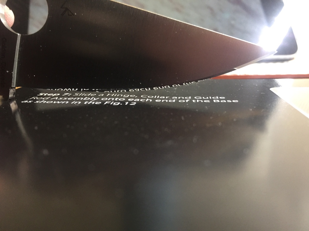

Spyderco Paramilitary 2 mirror edge on a Wicked Edge-Yes it can be done!
Jul 6, 2016
882

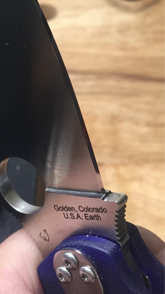

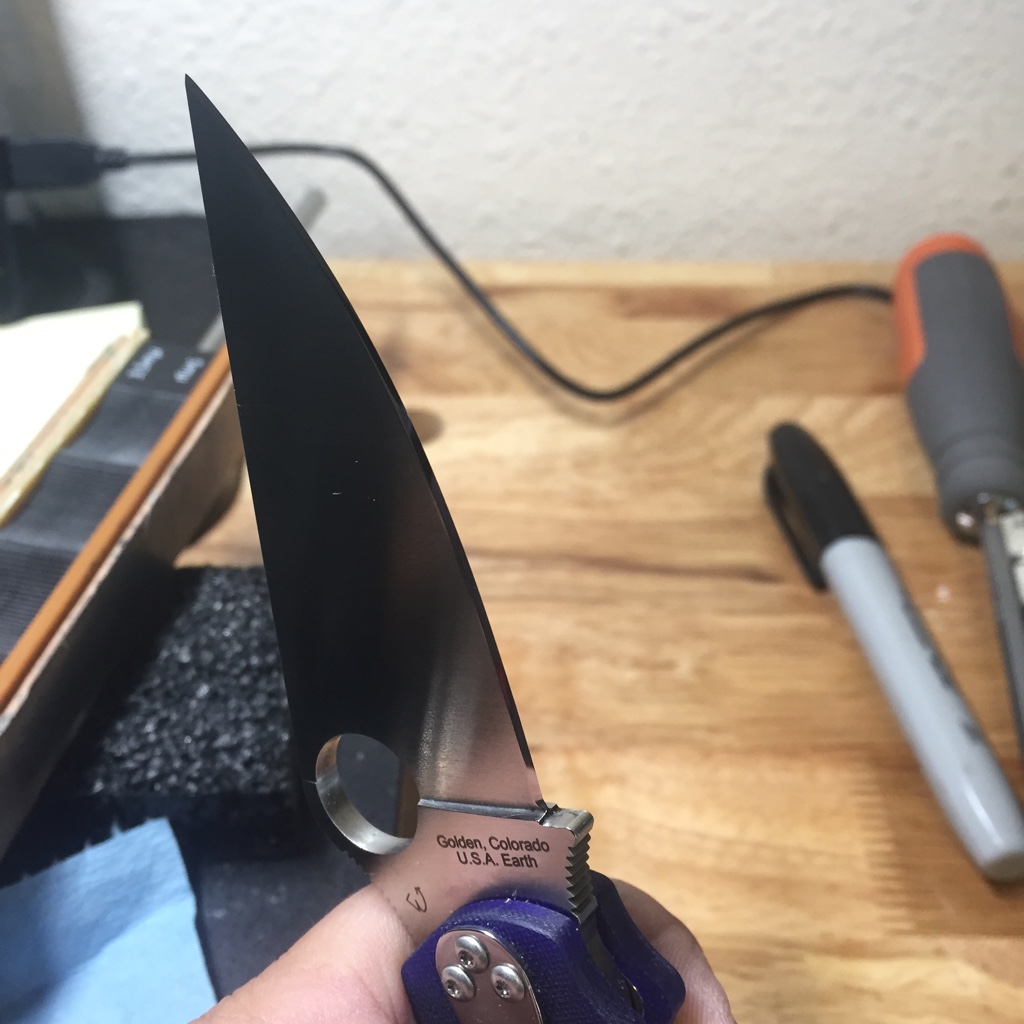

Just finished my blurple s110v para 2 after some modifications on my wicked edge.
The WE is an awesome device. I have no issues at all with s90, 110-125, 10v, or any of the 'monster' steels. It's such a solid device that nothing is really out of bounds.

It wasn't the steel that was the problem. Most Spyderco FFG don't play well with the WE at the heel of the blade[emoji6]
Ahh gotcha. I know what you mean. How did you fix that?

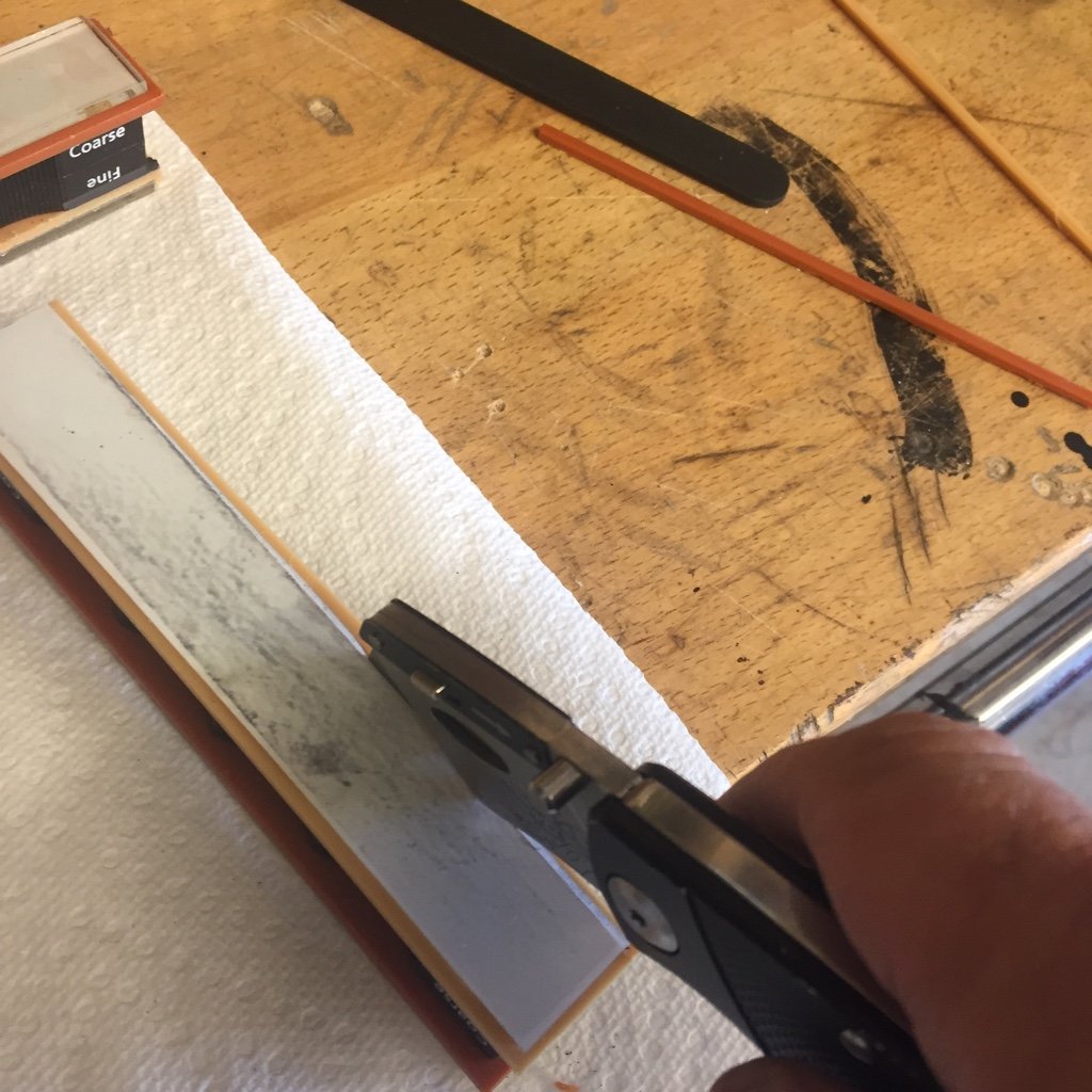

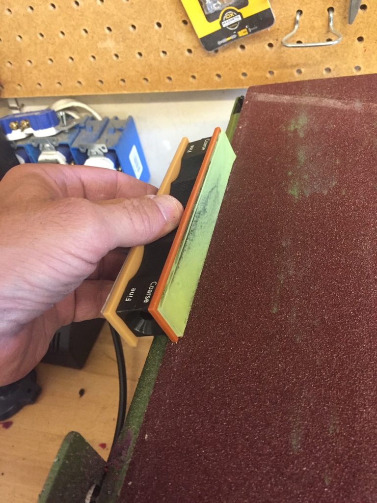

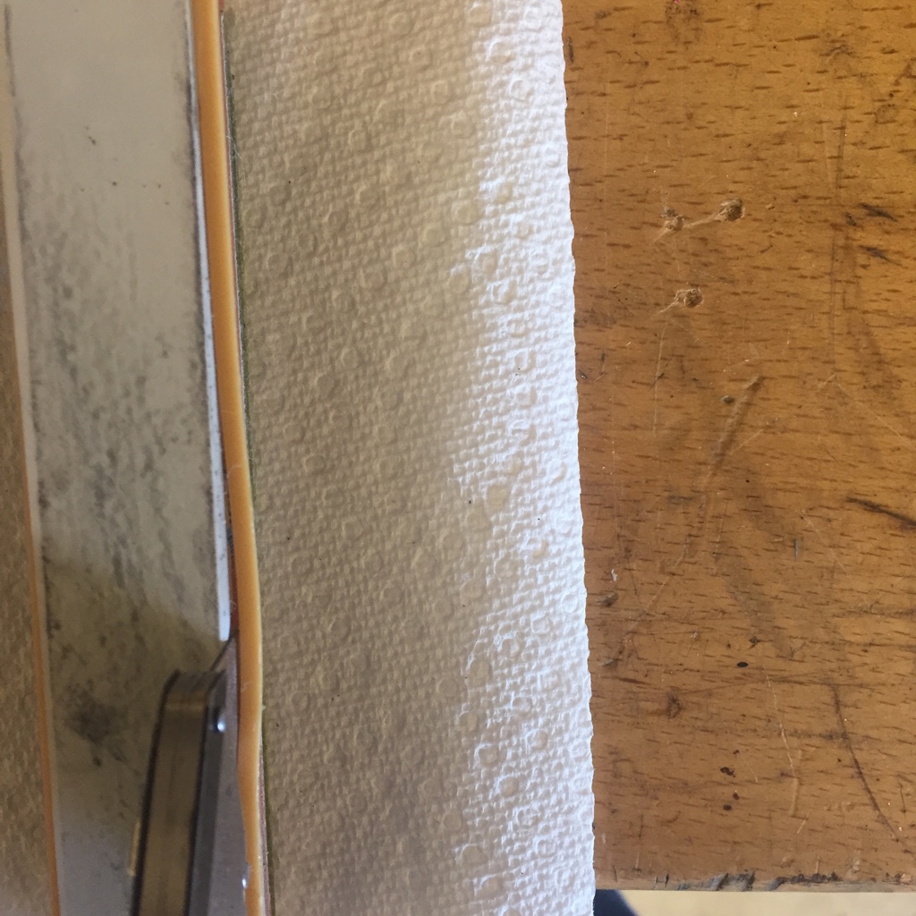

Removed the plastic edge on one side of every stone, blank and strop. I'll post pics later.
Ok, it's later:
Razor knife the plastic edge off next to the stone, aluminum or glass blank, or leather strop.
Then clean up the edge on a belt sander

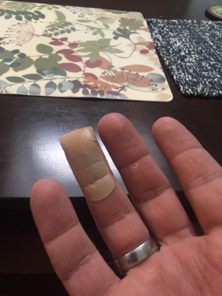

If you remove the edges of your paddles I recommend ordering the Wicked Edge cut resistant gloves or equivalent. Ask me how I know, lol.
How bad
I cut a tiny little cut from my PM2 just by touching the blade after the strops
There is a huge difference in sharpness when you get to polished edges

Not because of extra sharpness in the blade, because of cutting off the plastic edge that protects your finger. My brain said "that will never happen but the Wicked Edge over ruled! Cut the tip of my right ring finger off, not so bad that it won't grow back but enough bleed all over the place. Didn't even feel it till I saw blood, lol.

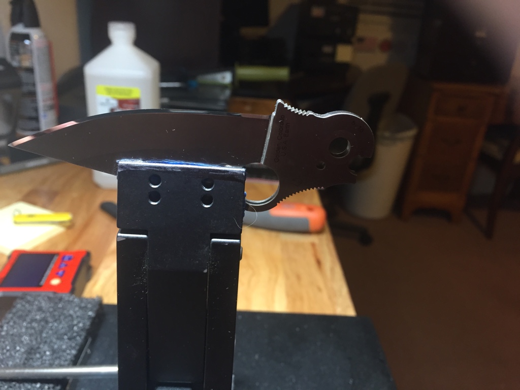

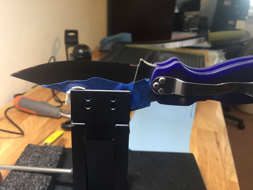

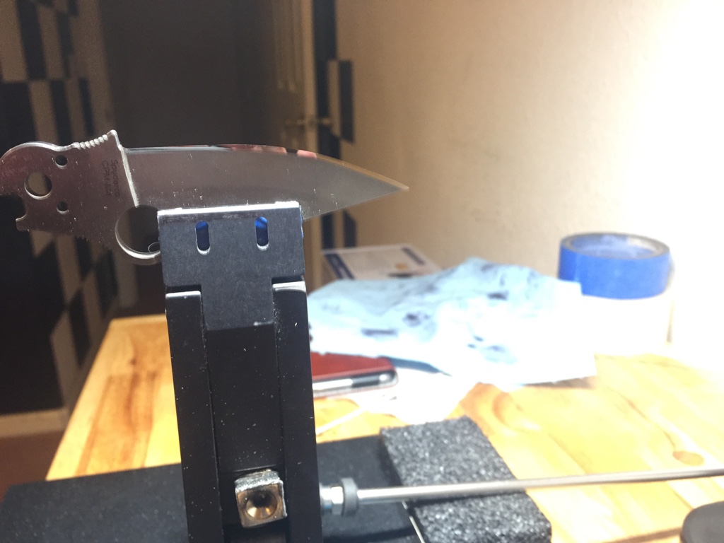

How do you like to clamp the ffg blade?
I have the gen 3 clamp, the first para 2 I did I foam taped the front tabs of the clamp. I'm doing my M4 blade right now and I only put blue tape on both tabs and it's holding fine.
Lol, if you look close in the second pic you can see my glasses in the reflection on the edge. I haven't even done the 1.0/0.5 micron strops yet and probably don't need them but I'll do them anyway.
