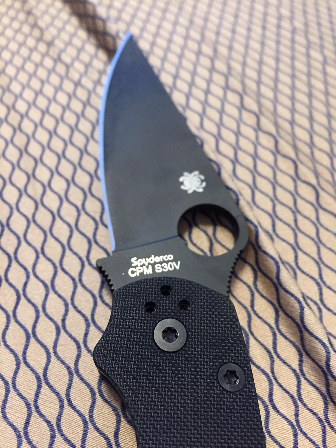

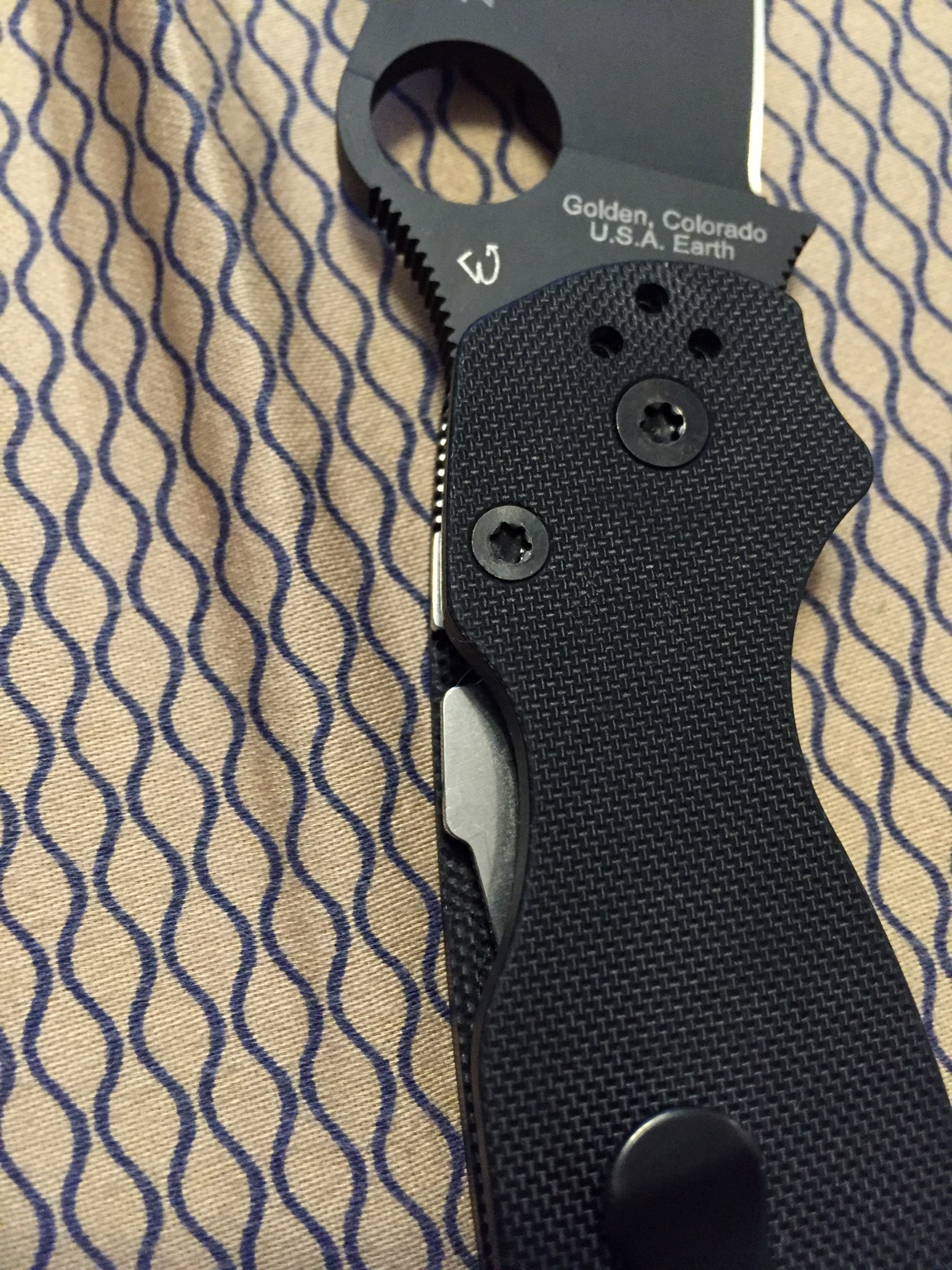

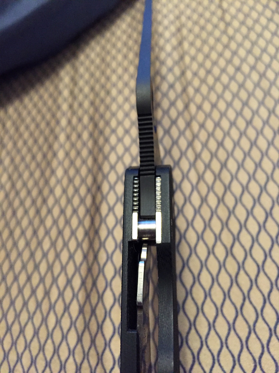

so what do you think? here so photo (the pivot screws are from spyderco directly...i did something stupid with old one and spyderco sent me remplacement) but they where exactly like the real
tell me if yours have really coarse texture,because IMO i found the best spyderco pm2 fake (never seen something like this on youtube )
thanks !
The PM2 in the pictures appears to be real to me. Usually the fakes have a sharp edge on the compression lock and it's not all rounded. On the box, does the barcode touch the numbers or does it have a space?
And to answer your question, yes spyderco had a batch of coarse G10 that they used on knives temporarily. I'm not sure if it was on the digicam also, but for sure it was on the black G10 models.
Looks real to me the swoop where your finger disengages the lock looks real most fakes have a round half moon shape not the swoop like that one

the barcode touch the number on the boxe but i dont think
its weird for the texture because both of my pm2 are 2015 so they should have the same g10 texture..i think xD
+ the compression lock sound not matching any real pm2 ive seen on youtube or with my new real pm2

G10 will naturally smooth over time as you carry and use it. So if you have had the first PM2 for a year, it should feel smoother than a brand new one. Also I have owned several different PM2s and the smoothness of opening and of depressing the compression lock has varied greatly between them (some butter smooth, some pretty stiff). I'm not saying yours is 100% real, but the differences you mention could have reasonable explanations. If you want to be sure you could send it in to Spyderco.
The batch of coarser G10 PM2s were released this past Spring and were only the black G10 models, not the digicam.
Looks real to me. Here are some pictures of mine which you can compare to

I've dealt with Outfitter Country a few times and have not any problems. I'm sure that the pm2 I got from them is the real thing.
I bought few Spyderco knives from Outffiters Country and can say only positive things. And your PM2 is real.
thank you every one for the reply !
you guys must be right...its too perfect to be a fake one.. maybe one day i will send it to spyderco just to be sure
i was a little confused because of the g10 texture both of the knives are made in the same years
if that's a fake then they have gotten as good as the factory...

Man I dunno...it looks real to me but if it's fake it's a damn good one.
another good way to check is take one USA made knife like benchmade or Kershaw's pocket clip screws which is US 2-56. Try screwing onto the Para2. It should also fit since Spyderco also tap theirs 2-56. The fakes tap them metric M2.5 which is larger in diameter so if your 2-56 screw drop right in...fake
Looks real to me. Hard to tell if the jimping is angled backwards in the pictures but the G10 around the lock disengagement is smooth as it should be.
