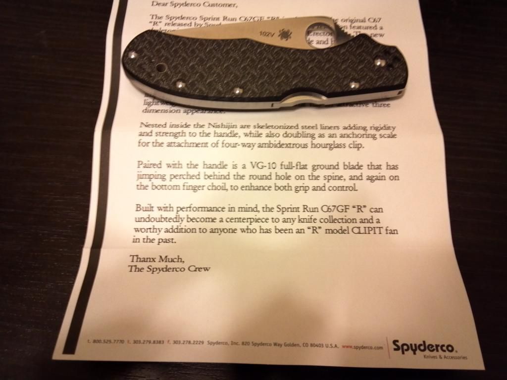

I really took a liking to the Spyderco R Nishijin when I first saw it in their catalog. In particular, the scales were especially appealing.
According to Spyderco’s website, the R Nishijin is a different version of the R that was originally released back in the 90’s. The main difference is that instead of having skeletonized handles, the R Nishijin has solid scales and milled out steel liners. The handle scales are what make the R Nishijin special—they are a glass fiber weave fashioned after a specific pattern used in making cloth for Kimonos.

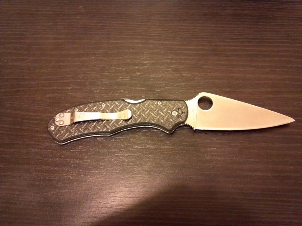

Please note that the clip that the R Nishijin ships with is a black hourglass clip, rather than the silver hourglass clip shown. I switched out the clip with another knife because I think that it coordinates better with the tones of the knife.

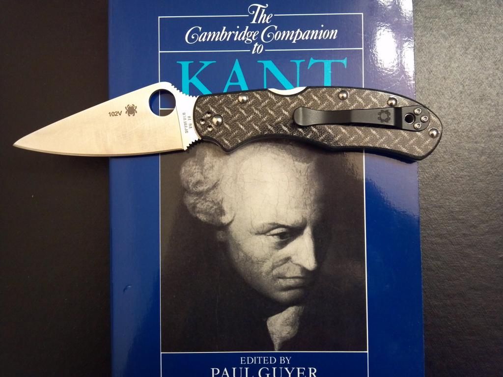

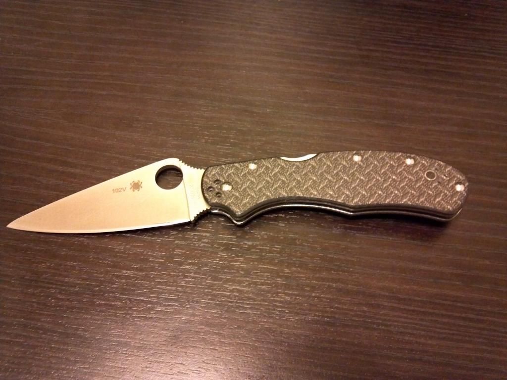

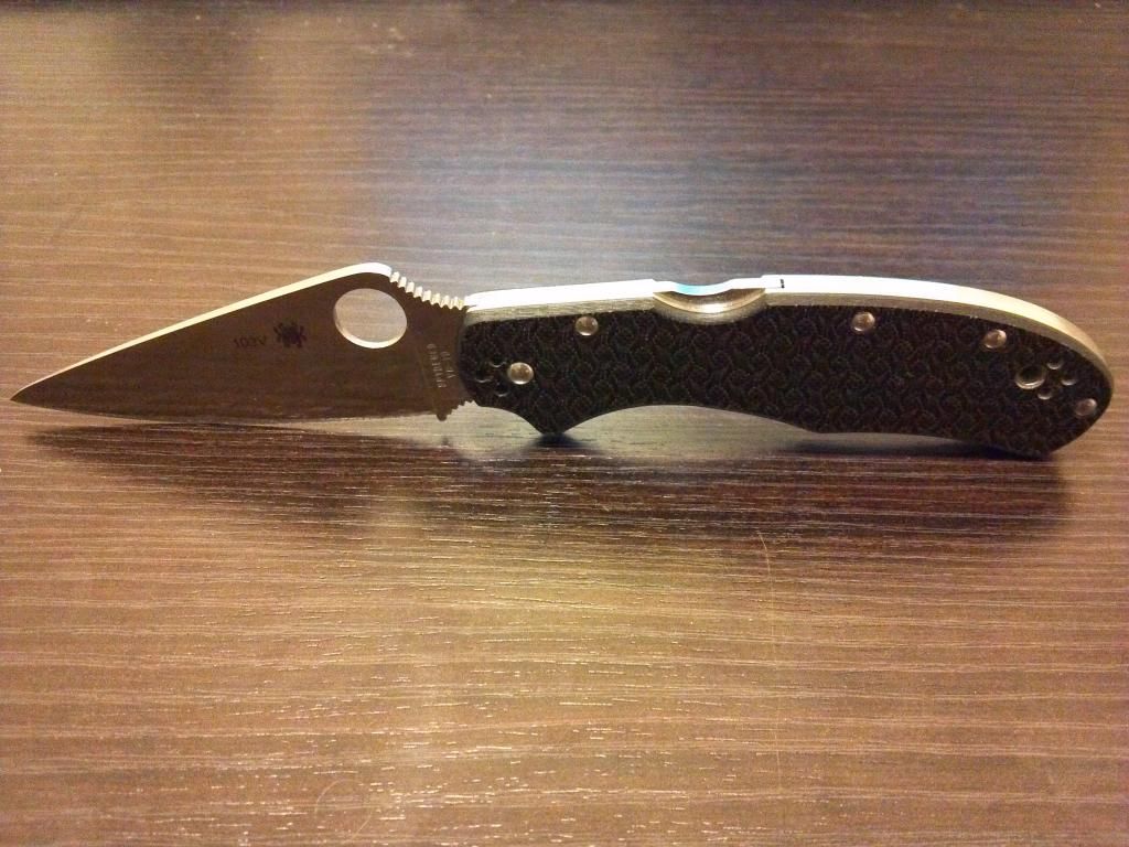

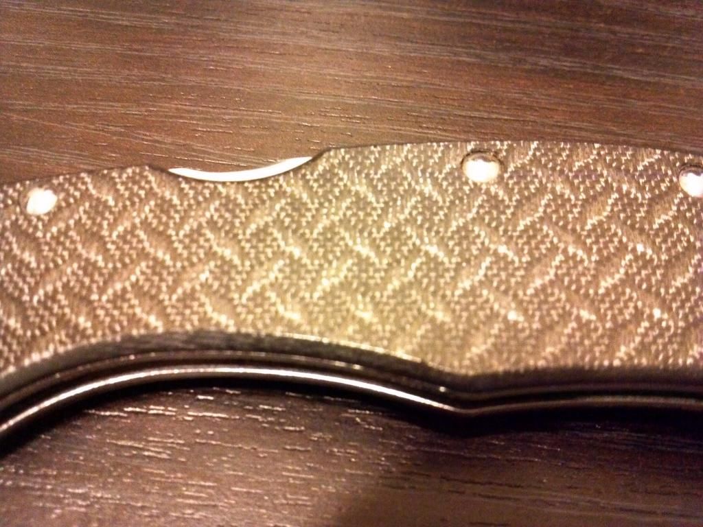

The Nishijin scales are very smooth, with virtually no texture at all. They have a very pleasing 3D look about them that does not come across in pictures very well:

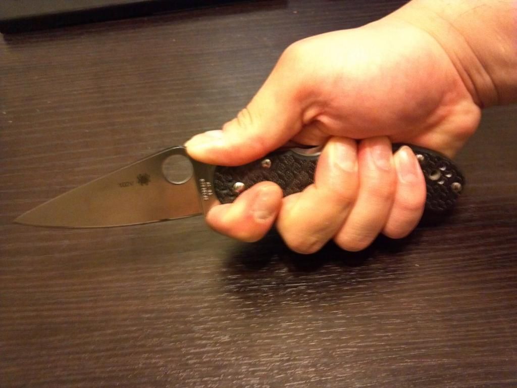

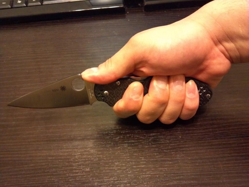

I found the knife very ergonomic in this position with a finger in the choil:
Though a bit less so in this position further back on the knife:
One thing to be aware of is that, due to the pronounced curvature of the choil on the R Nishijin, it could possibly be uncomfortable for someone with thick fingers. I have medium sized hands and I find the choil is just fine for me, but I can imagine that if my fingers were bigger in circumference the choil could end up creating hotspots.
A disadvantage of the smooth texture less Nishijin scales is that they can become slippery. If your hands are coated in oil/grease/blood/soap then the scales become difficult to hold on to when resisting torquing motions. I don’t think that you would have to worry too much about slipping up onto the blade, or the blade slipping out of your hand, as the shape of the knife does prevent this from happening. There is jimping on both the thumb ramp and the choil which also helps to improve grip. Aside from the visual aesthetic appeal of the Nishijin scales, one advantage of their smoothness is that they pretty much guarantees that your pockets will be safe from being shredded.

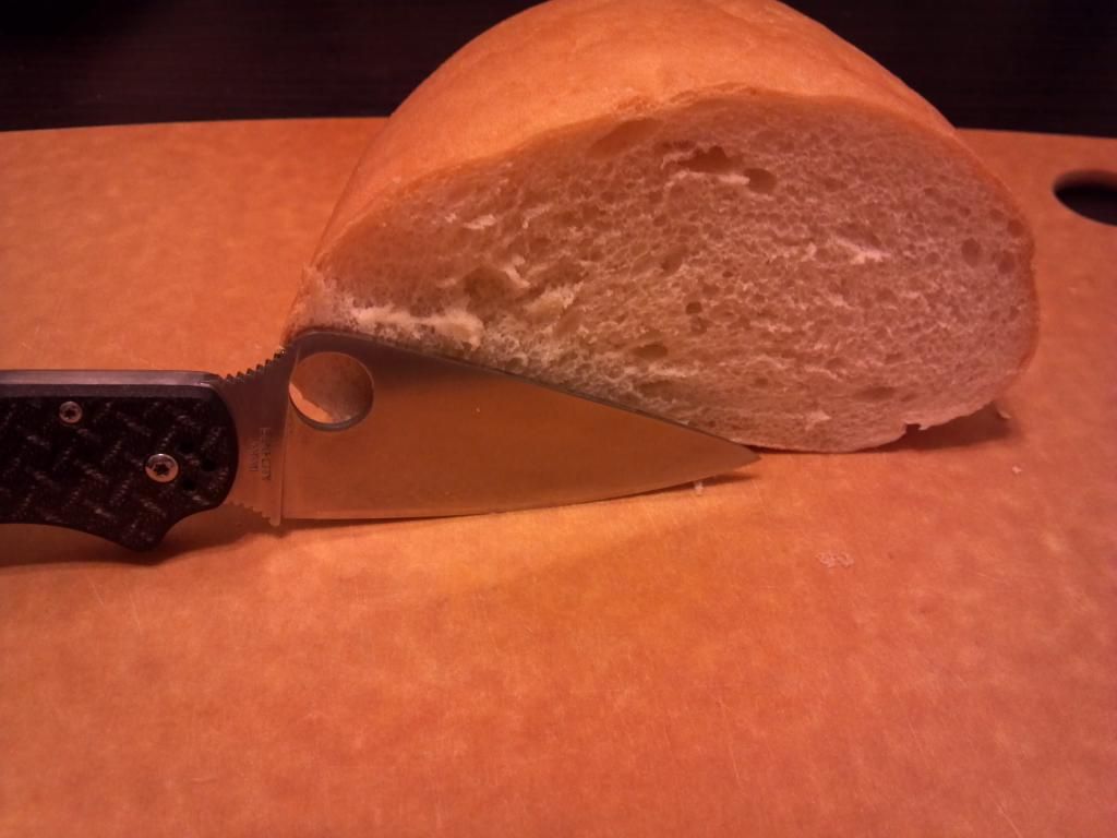

The blade is just long enough that you can cut bread without smashing the loaf:

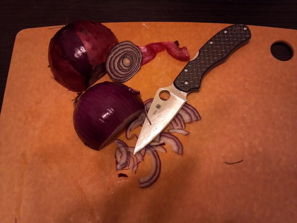

For how thick the blade is, relative to dedicated kitchen knives, the R Nishijin did a pretty good job of slicing onions:

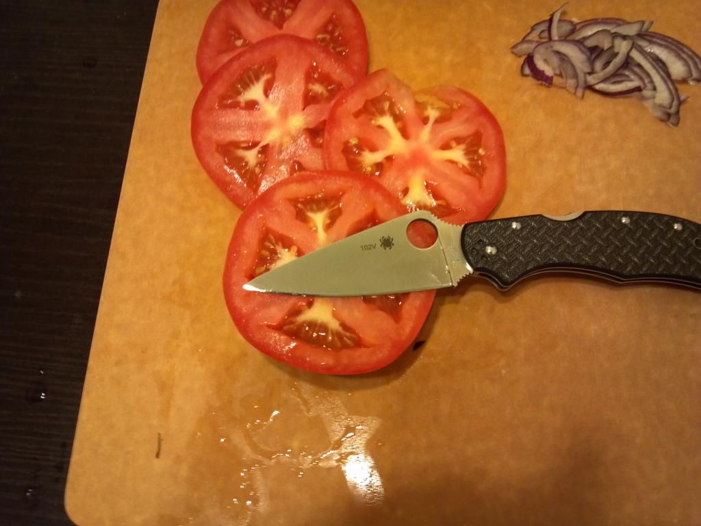

Tomatoes can be cut with the R Nishijin, but unless the tomato is pretty small you will need to do a bit of fancy cutting to get a good slice. Large tomatoes are not going to be able to be cut with one slice:

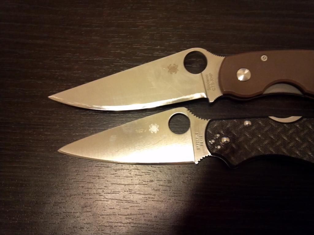

Additionally, I found that I’ve really taken a liking to the blade shape of the R Nishijin—the actual edge is almost straight, with a subtle curve like a modified wharncliff blade. Another thing that is nice is that the spine of the blade is flat, which is useful for scraping things. Here it is compared to the blade on a Spyderco Military:

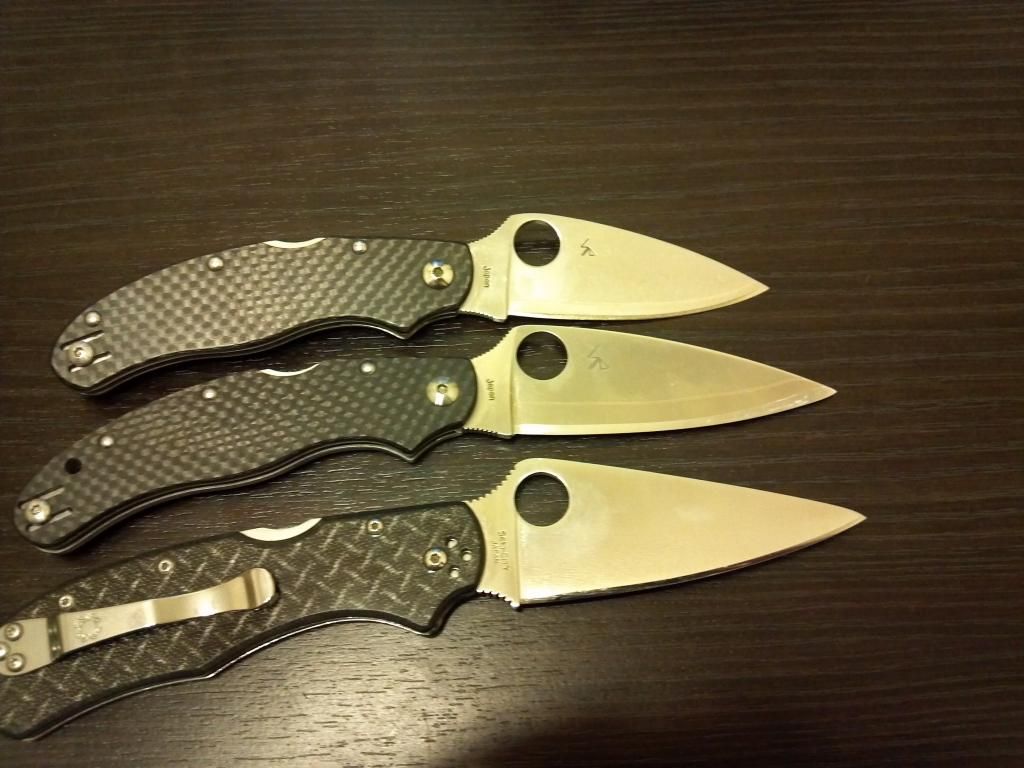

Unfortunately the R Nishijin has some pretty stiff competition in Spyderco’s own lineup. The CF/ZDP-189 versions of the Caly 3 and 3.5 can be had for a comparable price, or even ~$15-20 in the Caly 3’s case. The CF/ZDP-189 Caly 3.5 provides a very slightly shorter cutting edge length (of 3.125” to 3.16”) while being 0.445 inches shorter overall and 1.1 ounces lighter and offering a ZDP-189 blade.

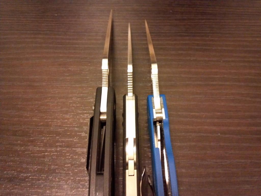

With their blades lined up the differences in cutting edges can be seen:
Here’s a comparison of their overall length:

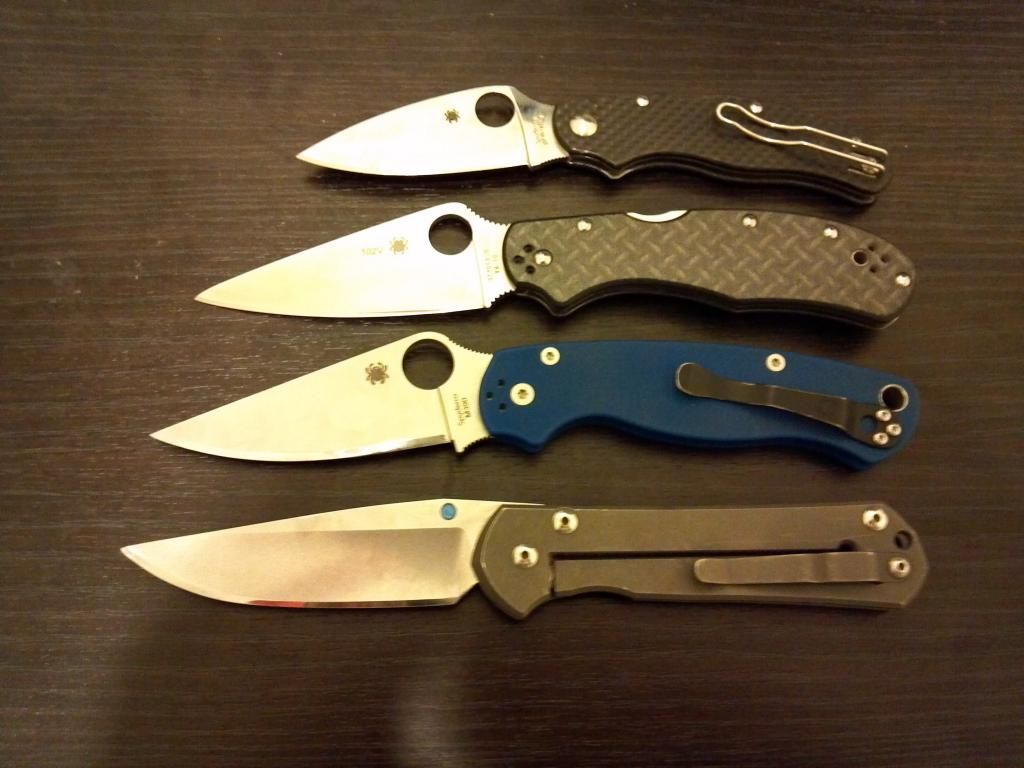

Furthermore, the Paramilitary 2 offers competition from Golden Colorado. The S30V version of the Para 2 can be had for around $100-110 and offers similar dimensional properties with a thicker blade, G-10, and is 0.45 ounces lighter.

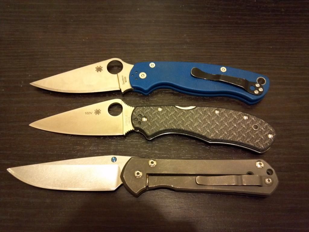

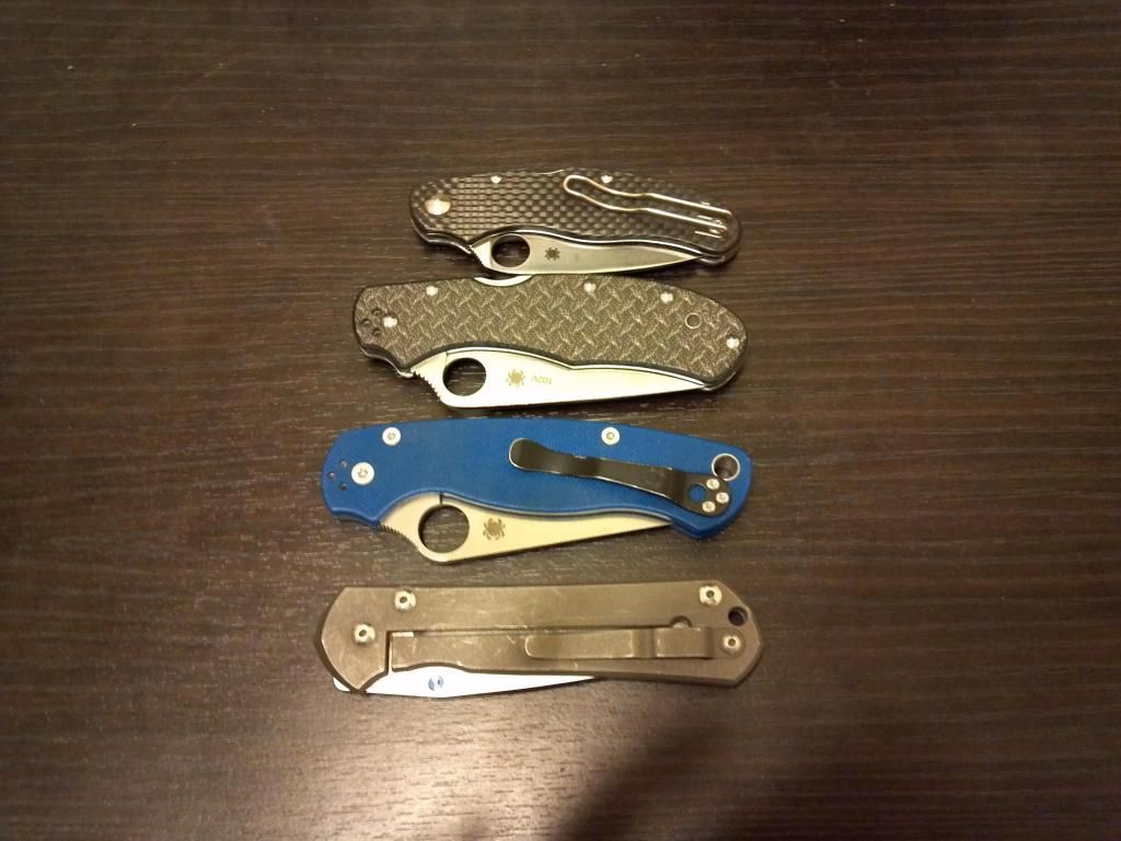

When closed, the amount of real estate that each knife would take up in your pocket becomes apparent:
The R Nishijin has a flat and thin profile, which can be noticed next to a Military and a Para 2:
