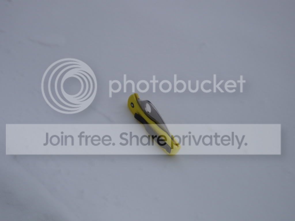

Well... -27 degrees C/-16 degrees F today... I put the knife outside for an hour to chill out.

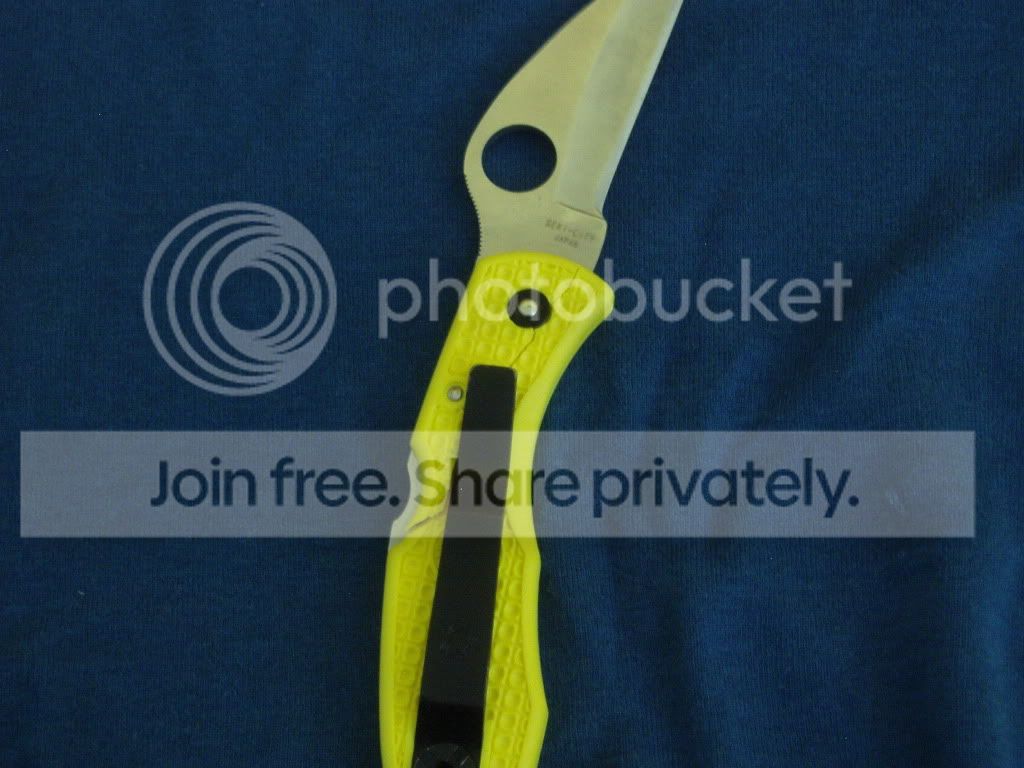

I then flexed hardcore with all my hand strength side to side and the FRN and blade were fine. I grabbed 2 pieces of Oak and went to town again. First I batoned on the blade real hard like normal into the other chunk of wood. Then I layed it down and whacked the sides of the handle. Next, I rested the blade edge on the wood and put my weight on it... this is when I noticed the crack that must have happened when smacking the handle sides. Here's the crack...

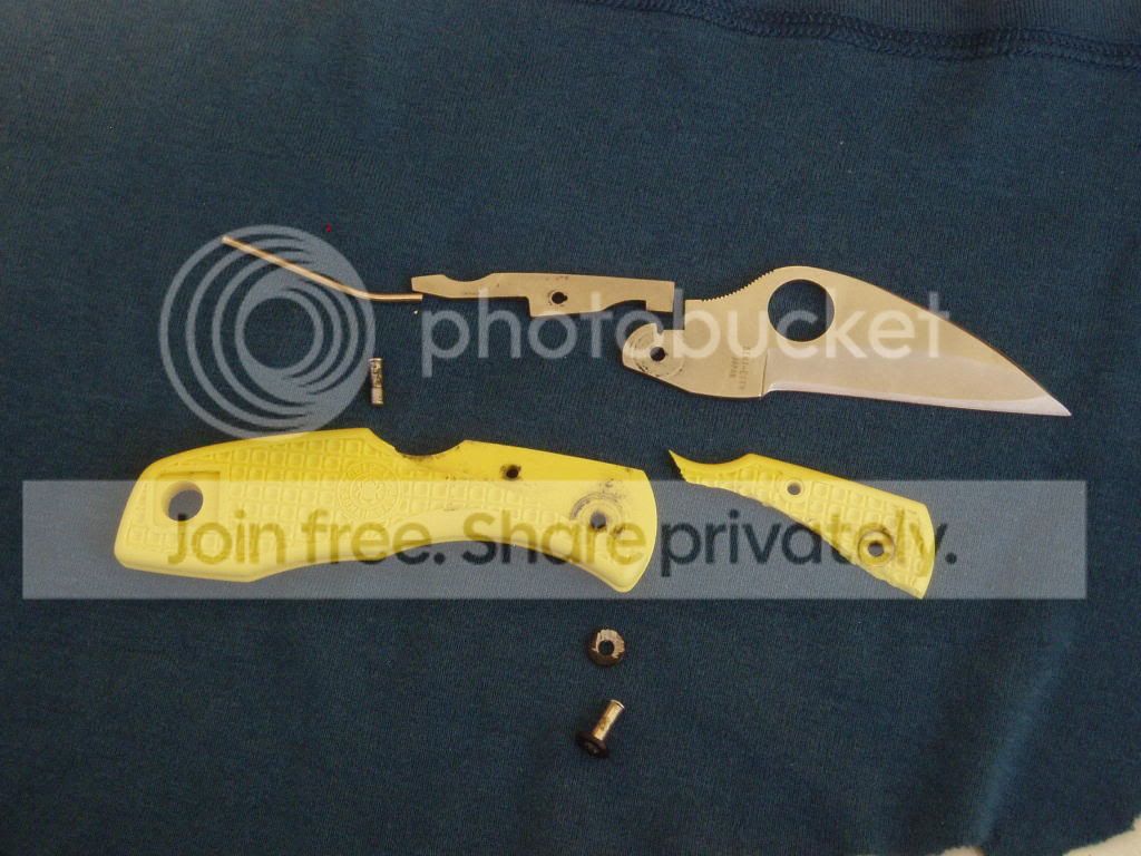

I guess -27 C is somewhere around the limit for this stuff (with batoning and such). I'll be carrying my Milli or large Wegner in these temps from now on, but FRN seems fine (to me) down to -20 C/-5 F. I don't plan on using my knives for these extreme things, but what if?... Here's what it looks like in pieces...

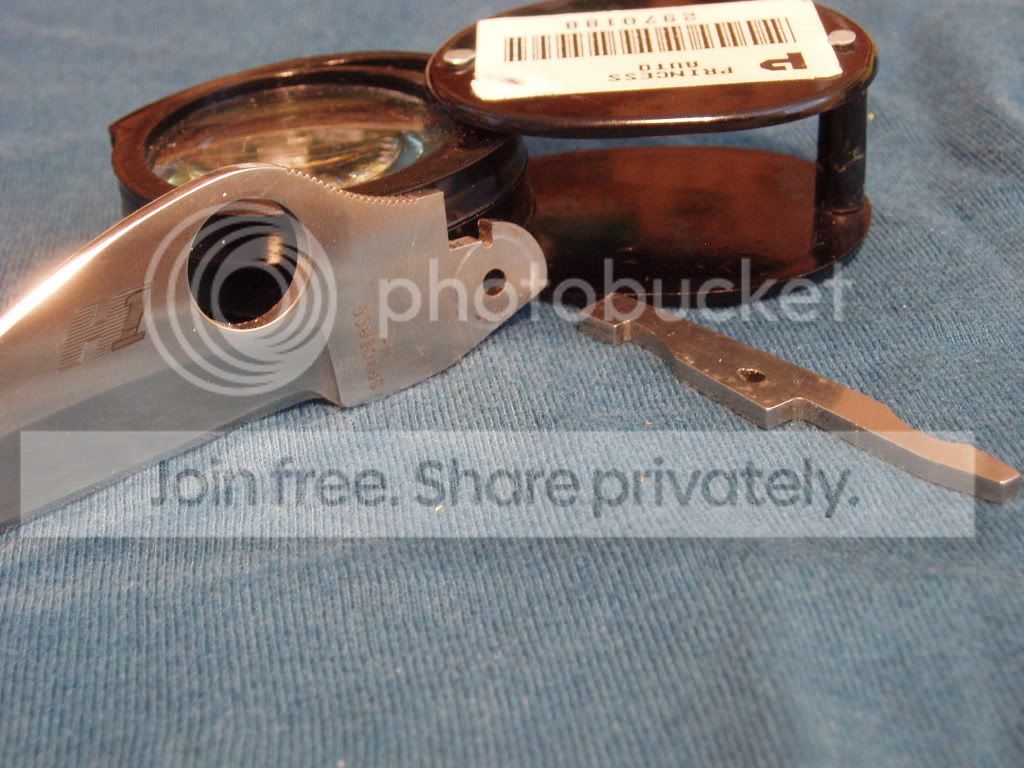

The areas I marked in the drawing are where there was plastic deformation from extreme batoning. It's kind of curved there a bit - that's why I could defeat the lock with my own hands only, I guess.
You can kind of see it in this picture...

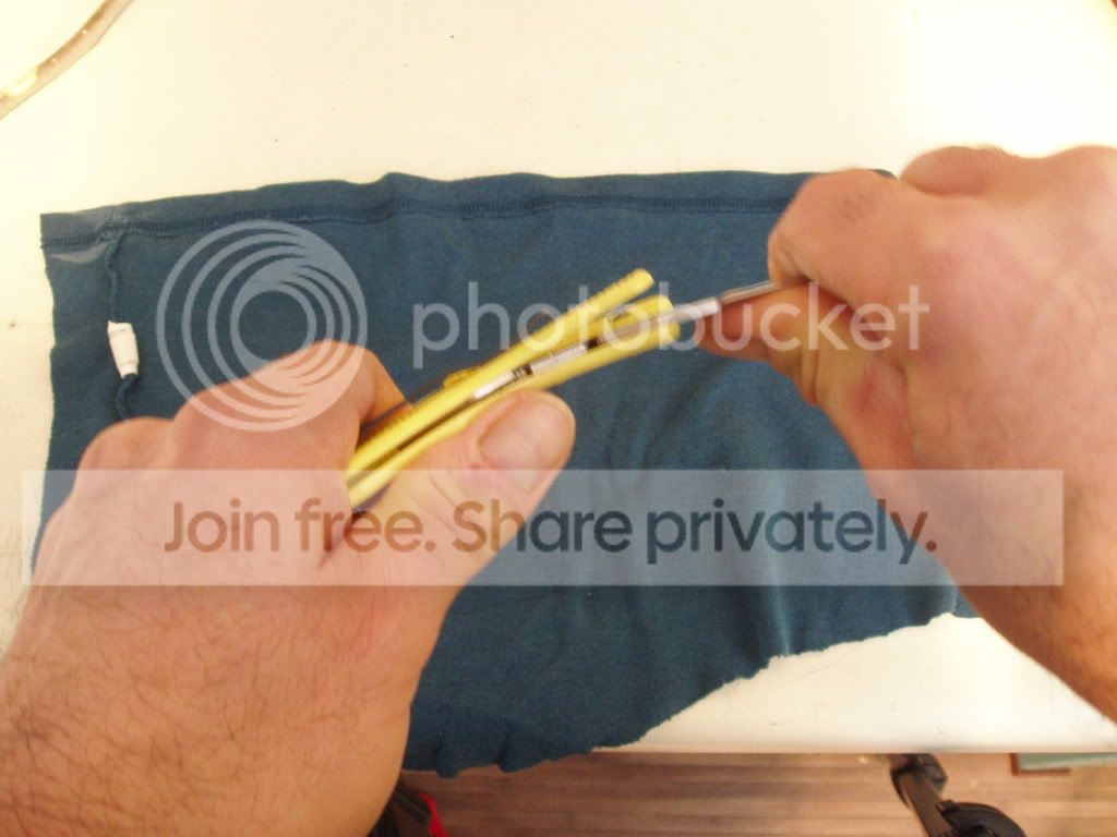

After it was warmed inside for a while (so, it was around+ 20 C/+ 68 F), I flexed the FRN in a vise and it broke at this angle - two times I did it and the same angle it broke...
