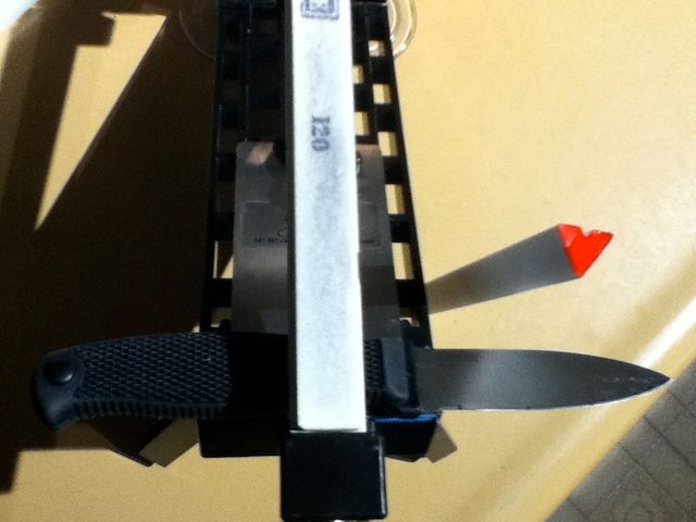

Big update here.
I took one of my Cold Steel Kitchen Classic paring knives, sharpened the edge using the Shapton 120 stone on the Edge Pro. I moved the stone off the edge rather than into the edge; in other words not back and forth as usually used. I lifted the stone off the blade, pushed it toward the vertical support rod, set the stone down on the blade and pulled the stone toward me. That is the way I usually sharpen. I rarely go against the edge. I have recommended going against the edge to people here and Buck recommends going against the edge but it is because it is easier to tell when you get the angle right rather than because it is going to give a better edge.
Anyway . . . got the slightest wire edge that I could doing this and then ran the stone a few passes super light, not even the weight of the stone and sharpener arm. So far better results than using a 700 water stone free hand. Judged by the way it bit into my thumb nail ala Sal Glazer Sharp Maker video.
To get rid of the slight wire edge I decided to use the ultra fine Sharp Maker ceramic rod. I didn't rub it against another rod or anything else to break it in; I just slid it out of the plastic tube and using one of the corners of the rod (not one of the flats) I took the edge of the knife super lightly down the rod, against the edge now, opposite of the way I was working so far. Just very lightly, not even half the length of the rod to do the whole edge of the knife then the other side. Checking every one or two passes for the wire edge. When it was gone I stopped. This hardly took any passes and very light pressure.
Results :
Bites my finger nail like crazy just like I like. And like only using the Edge Pro can do . . . at lest do in short order.
Easily shaves hair.
Some what sorta hair wittiling but not well.
Better results in less time than using the 700 water stone and a rough leather strop judging by finger nail bite and shaving hair.
Toothy ? You darn tootin' ! ! ! !
So . . . I think this Sharp Maker ceramic rod, even in ultra fine, may be very useful for the way I want to work.
