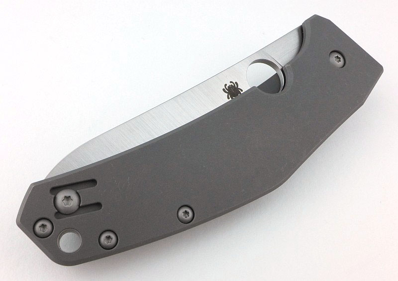

Using flat Titanium handles and a Reeve Integral Lock keeps the design streamlined and simple.
The gently curving and elegant design is by the Polish custom knifemaker Marcin Slysz.

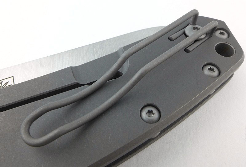

Being a Spyderco, we have a Spyderco wire pocket clip. This can be fitted to either side of the knife for a tip-up carry.
The alternate clip position with blanking screw. If you swap the clip side, you need to swap the screws round as they are different lengths. The Lanyard hole is lined to make it easy to fit cord through both sides of the handle.

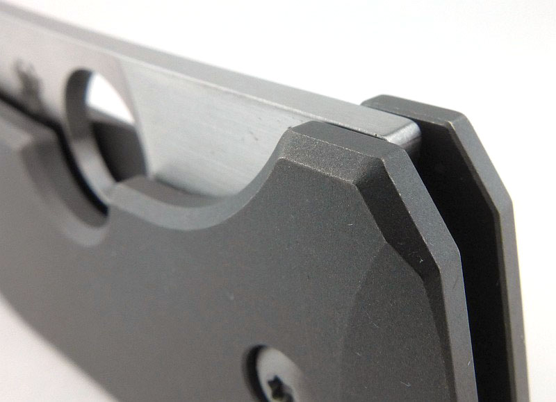

Details 'make' designs, and in this example, the finger guard formed by the handle titanium, and the spine of the blade have been positioned such that they line up when the blade is closed, keeping the outline of the closed knife smooth and tidy.

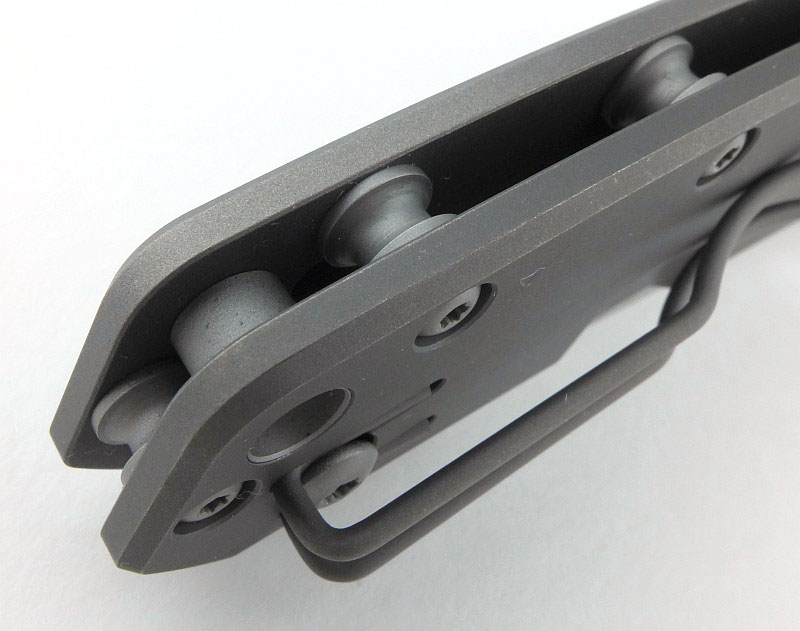

To make the SpydieChef easy to clean, small spacers have been used to give as much access as possible into the handle.

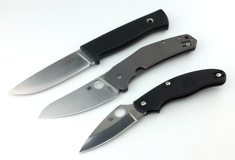

Before we look further at the SpydieChef in use, to give an idea of scale, here it is next to the Fällkniven F1 and a Spyderco UK Pen Knife. It is a very pocketable size knife which is helped by the slim profile, but has enough blade to be useful. Clearly you will struggle to chop large vegetables with this knife, but it is an EDC folder and not a substitute for a full sized Chef's knife.
