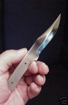

EDIT: Something like this would be great, only not in 440C, and with a more prominent hilt or guard:
http://cgi.ebay.com/Knife-Blank-Bla...oryZ7306QQssPageNameZWDVWQQrdZ1QQcmdZViewItem

Out of curiousity, is the third pic I posted just a generic offshore knife blank? It's 400C, and shaped like a knife, so if you toss on some scales and sharpen it up, are the odds good that it's an okay knife?
If so, any ideas on who can toss some decent scales onto it for me, for a reasonable price? It's a really nifty little design.
