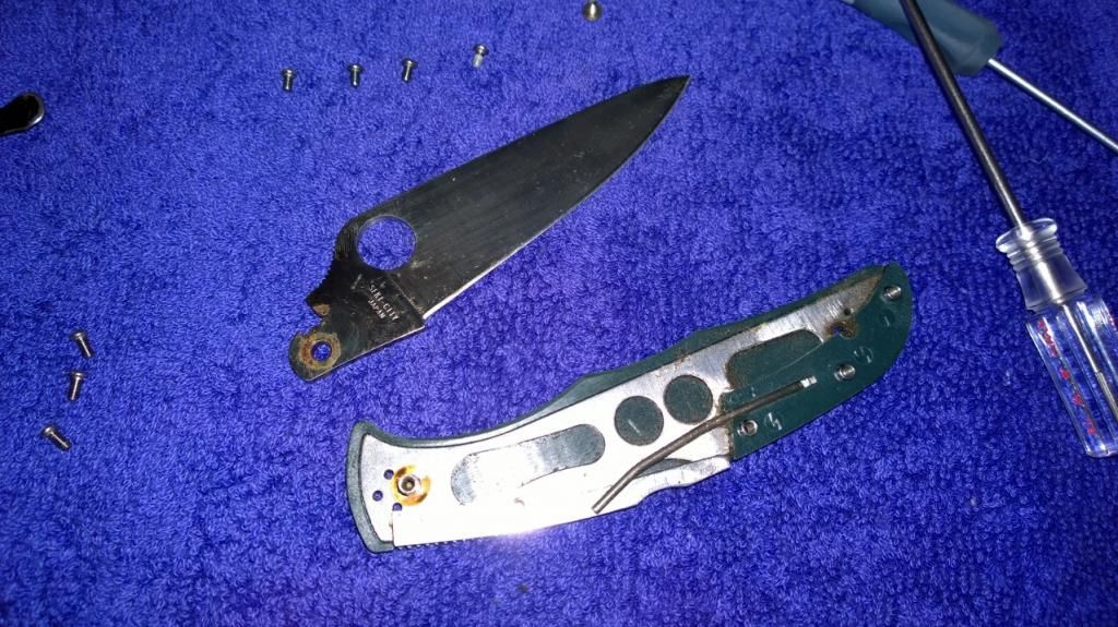

Like others, my zdp Endura formed a bunch of rust around the pivot.
I can now really appreciate those blades for the stretch and caly which they make out of a composite superbluex420J1 and ZDP189x420J2 respectively. That must really help rust resistance especially at the pivot. Any negative marks on those?
