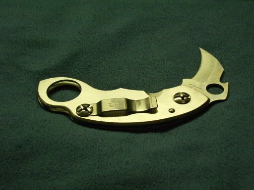

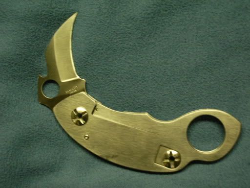

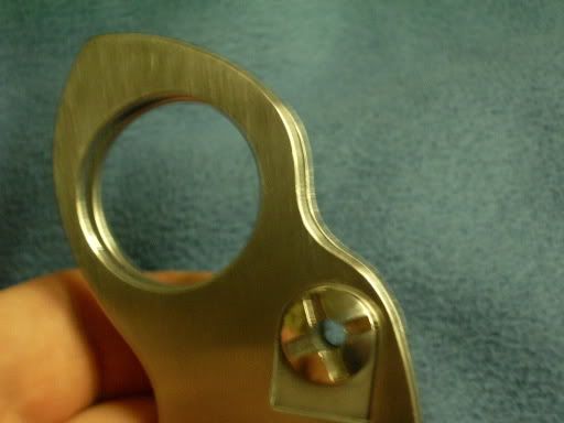

I decided to modify my Warren Thomas Karambit a while ago. I wanted to primarily add the "wave" that is so slick on Emerson's design. I also thought about adding a "stop" to the spine after reading Michael Janich's review of the knife in a magazine. He advocated the addition of it. I didn't think it would be too hard to do these things, but it did take a while. The only tools I used were a Dremel tool with sanding wheel, fiber-reinforced cutoff wheel, and two grinding bits. I finished with varying grits of hobby sandpaper.

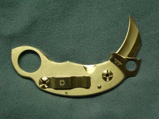

Basic shots of it open and closed.

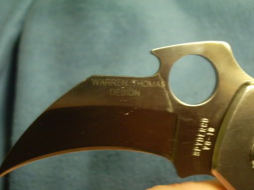

My modified "wave." I didn't want to cut through the designer's name, nor mar the useability of the Spyderhole. I think I reached a good compromise.

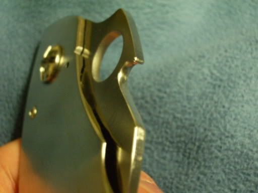

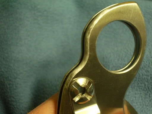

The "stop" I added. I tried to match the bevel of the top:confused: half of the knife. It turned out pretty well. The grind isn't perfect, but this is my user knife and is already scratched up anyway. Looks fine to me.
I'm really liking this knife now. It has temporarily deposed my Yojimbo as my SD EDC.
You did a great job; the bevel is dead on! :thumbup: (Never noticed before:o )
As far as I understand, a stop is a notch that catches on your middle finger when you extend the knife from a reverse grip. As it was, a rough curve bit into my finger. The knife also rests at a lower angle when extended, seeminly making the hooking movements in this position easier.
Basically, I like to play with the knife a lot and the stop makes spinning it around much more comfortable.
