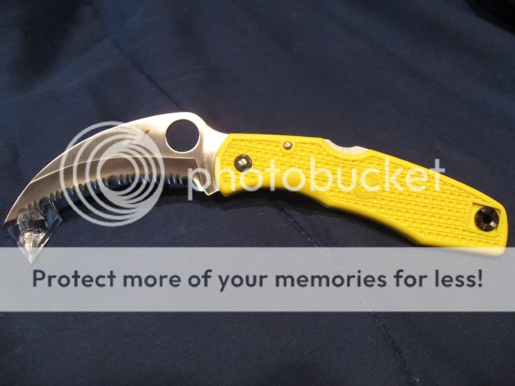

Hey, I had posted this in the General section earlier, but didn't get any good answers so I figured I'd post it here. I would love to get an answer from Sal or Kristi.
Hey guys,
Today I got my PE Spyderhawk H1 today and it's an incredible knife, but I am weary of the edge.
It seems dull which is very unlike Spyderco, but then again it could be the blade shape. It cannot push cut paper (of any type) and can barely shave.
My question to you is if you have gotten your Spyderhawk are you experiencing this as well?
*And then I posted* Well, something is definitely wrong with this knife. It came dull and will not get sharp. Perhaps the heat treatment was botched? I'm not sure but I will definitely send it in to Spyderco and have it sharpened and buffed or perhaps replaced if something is truly wrong with it.

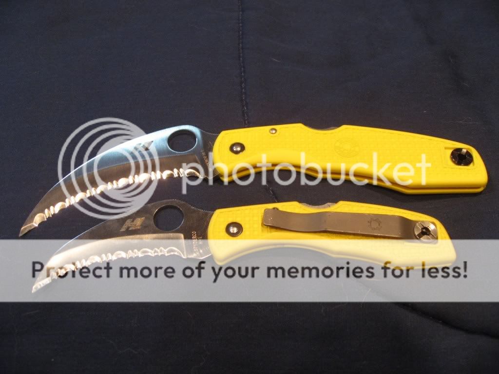

Here are some bad pics.
and with its little brother
