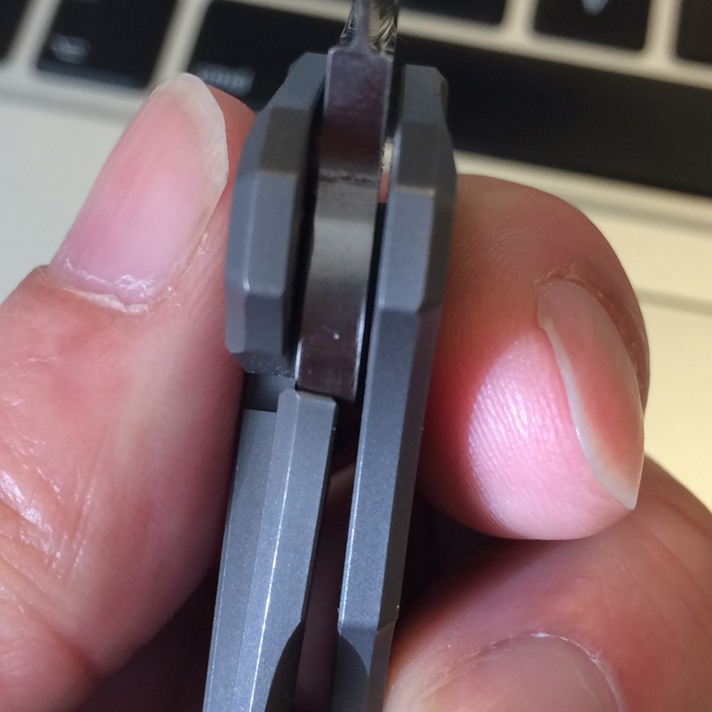

The lock up might not be as late as it looks. If you check the scratch mark on the blade tang (actual contact between the blade and the lock bar), it might indicate that the lock up is little earlier.
Mine looks like 80% from the lock bar position, but the scratch mark tells it may be around 60~70%.
Anyway, as others said, the "secure" lock up of Slysz knives is only a good thing to me.

What Miso said is correct. I noticed that mine locked up quite late new...especially if I pushed it over with my thumb. It looked like it pushed over to about 90% but upon inspecting it with a 10x loupe, I saw that the way the lockbar is cut, it engages earlier than it appears. What I thought was 90% is really about 70%. I've been using it daily for months now and lockup is still rock solid and hasn't creeped over any further. I know it's hard not to obsess sometimes...especially when the internet tells you you're supposed to, haha, but I think the design and lockup is made this way and works just fine.

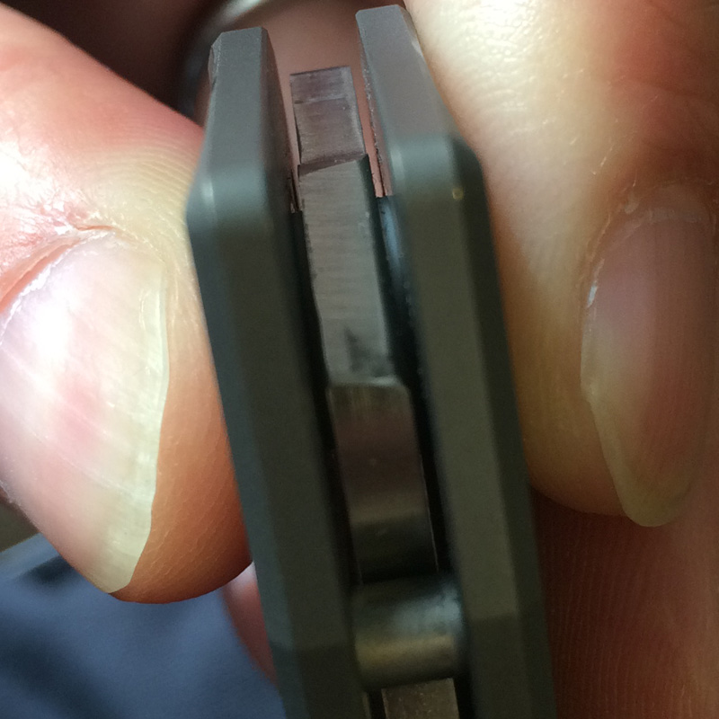

Mine goes a good 10% deeper than yours Miso. Yours looks like about 65% or so and mine is probably 75-80%. That's only if I push it over with my thumb though. I've used the knife hard for months now though and it hasn't changed any so I don't expect to have any issues with it.
The lock up of Spydiechef gives a similar feeling of Sebenza's, late and secure.
I guess it is also quite stable as Sebenza's lock up, as yours stays where it was even after your hard use in salty environments.
