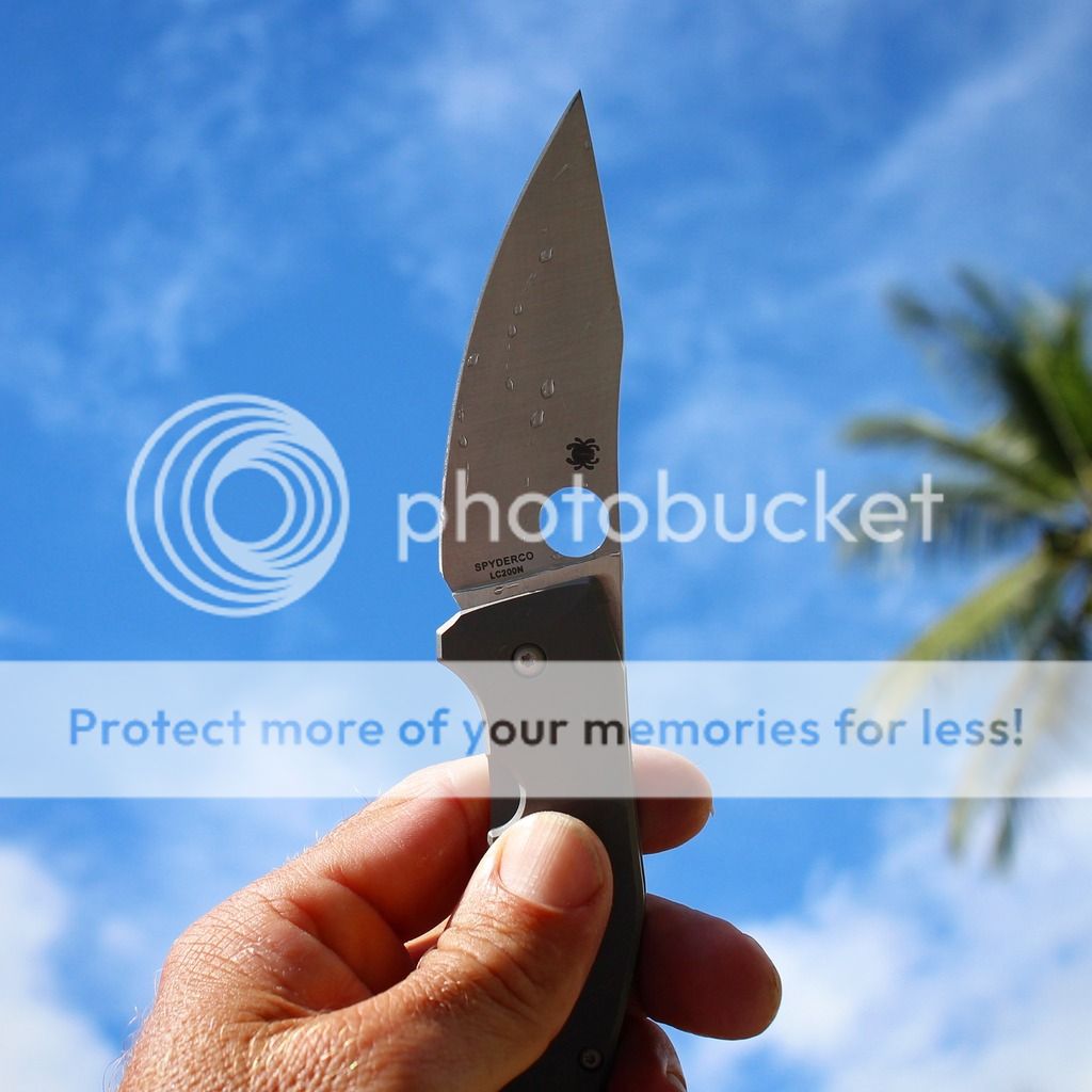

I was stoked when the Spydiechef was announced. Not because it is the perfect fishing knife but because I finally had an option for a plain edge rustproof folder with better edge retention than pe H1. I picked one up knowing that I would be regrinding the blade for use on my kayak. The main goal was to give it a pointier tip that would make the knife functional for gutting/stabbing/filleting. And yes, I have very nice fillet knives for that type of work but I like having a folder with me that is capable in a pinch.
Mostly I just ground down the hump and gave the knife a point. It was a bit tricky to make it not look weird because of the sweeping edge profile but I'm ok with the results. I also ground a bit of sway back into the rearward part of the spine just for grins. Here's a look at what I came out with.
I can't decide if it looks good or if it looks wonky but I'm not too worried about it. The idea was to make a blade that was more functional for my intended use and I definitely accomplished that. I had the knife out on the water today and used it for my normal tasks and on the way in I decided to fillet a snapper in the kayak and shoot a video, so here ya go. Forgive the sloppy fillet work...moving kayak and lack of space are my excuses. ;)

One note: This video was intended to be a review of the functionality of my regrind, not the knife itself. After I got in I did some more grinding and gave the knife a bit pointier tip. I will try it again tomorrow and see if I'm going to leave it like the picture above or thin it out a bit more yet. The Spydiechef is an amazing design and I love it. So much so that I am thinking to buy a second to leave in its stock form and use more for its intended purpose.

Hey bud, used a bench grinder. Went slow and quenched often. Finished with 60, 100, & 180 sandpaper. Matches stock finish perfectly.

I like the look of the original but your regrind looks good. It's not jarringly out of balance.
I like the regrind much better!
That's exactly the Salt folder I was looking for, pointy, LC200N, nice belly...If only I could buy it like this from factory or have someone regrind it that way...
