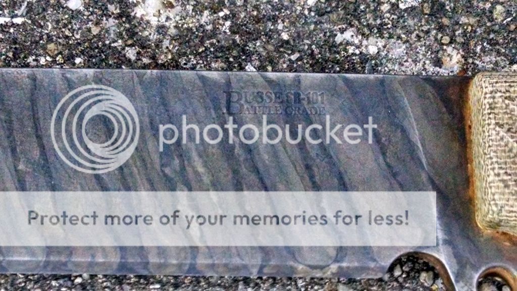

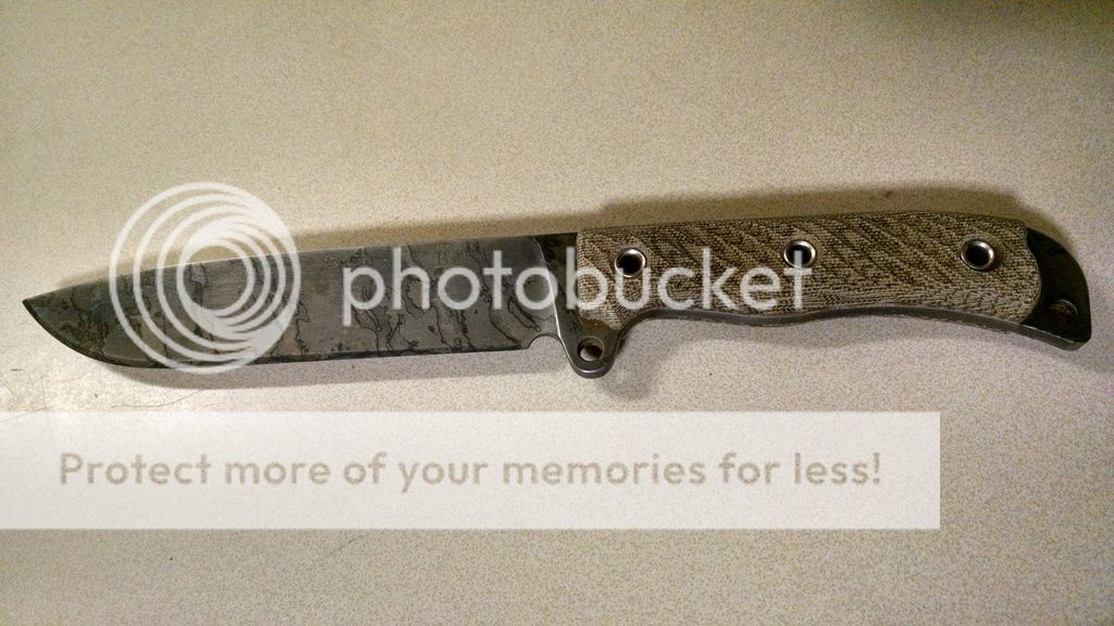

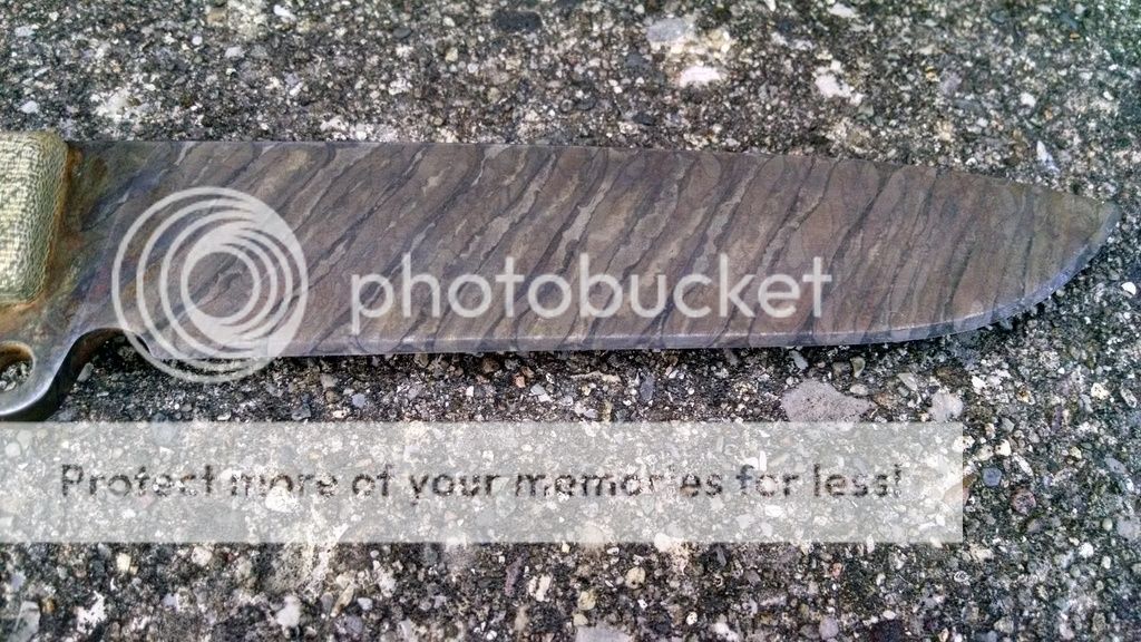

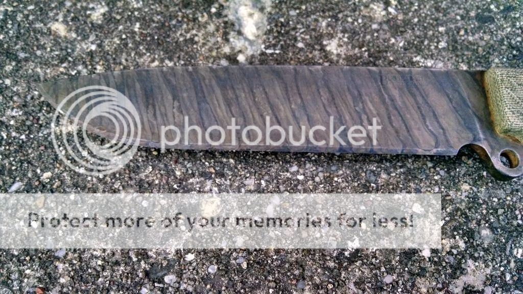

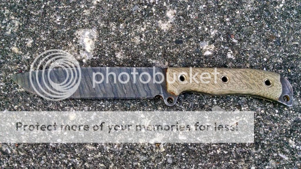

I feel kinda guilty for doing this. My Battle Grade Boss Jack really had a pretty amazing finish under the coating but I figured No Regrets and went for it.
These pics are after multiple mustard applications. I think five but I'm not sure. I just kept experimenting til I got it looking pretty good.
Now I just have to clean up around the handles and talon holes and have my buddy sharpen it again.

Like I said above, I did multiple apps. The last one was about five hours. It definitely isn't a quick process. The multiple apps let if fill in pretty well.
I used Plochman's mustard.

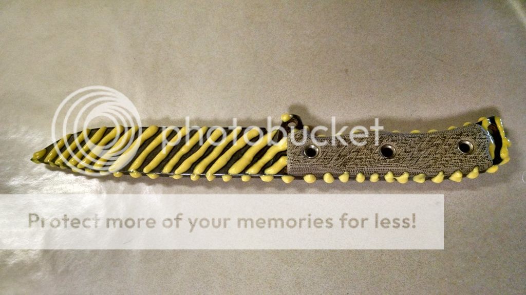

Here's an early pic. I was using strips of paper towels to see if I could get a cool pattern.
I decided to just start doing stripes. I tried to keep them as straight as I could but it isn't needed. I think a little variation makes it look better.
For those who don't know it's actually the areas without mustard that take the dark patina. So, I alternated each app putting the new stripe of mustard on the already dark patina stripe on the knife.
