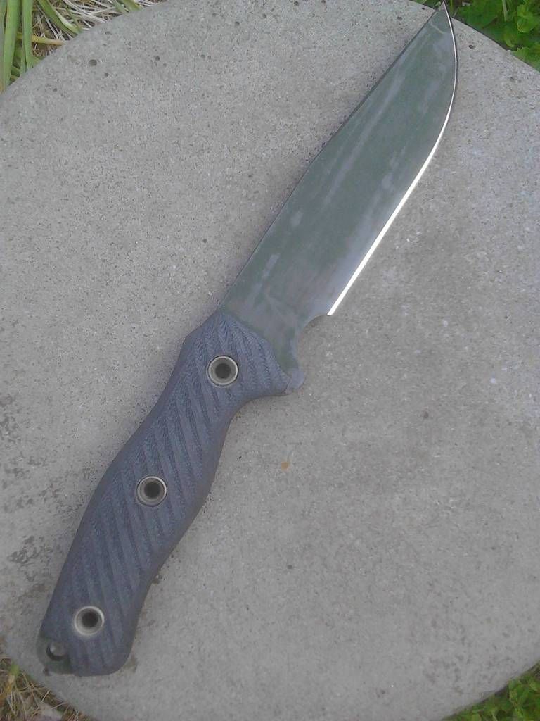

I used a wire wheel to finish the Ratweiler:
I used Pferd non woven hand pads (think Scotch brite) on the AK47 and love the ghetto satin it produced!

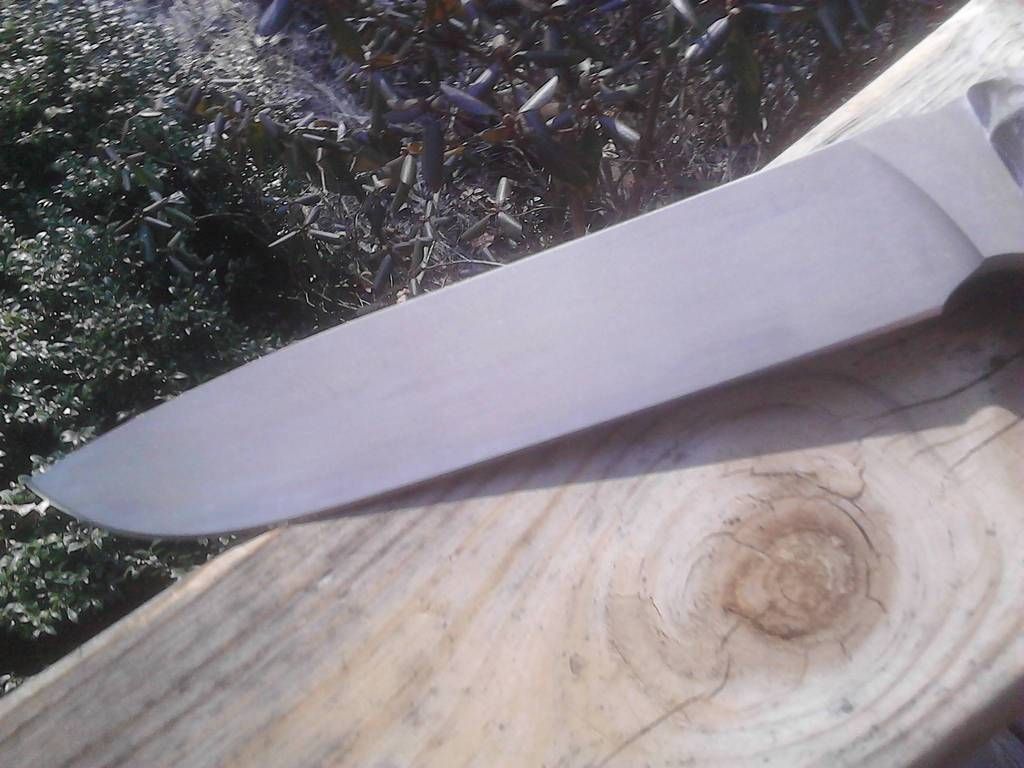

Stripped INFI Gladius for demonstration, see how corrosion dead ends at shiny white. :)

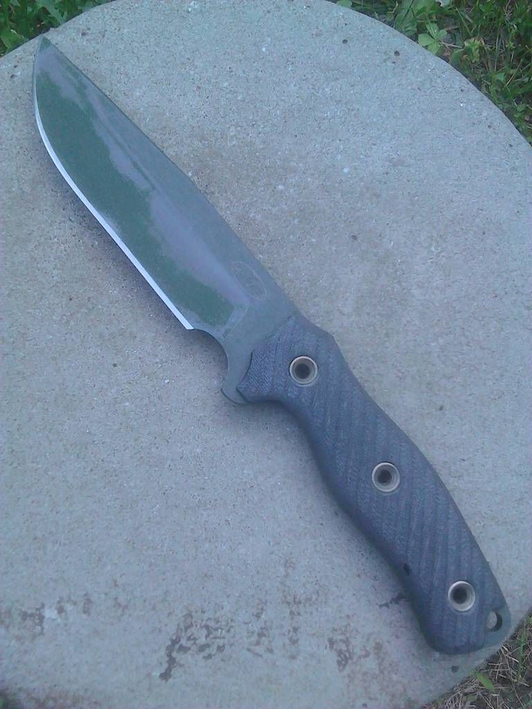

Unless it is just the lighting playing tricks, your color change above the edge where it looks like a gray hamon is the decarb layer transition. It takes a ton of sanding to get rid of it on the whole blade. INFI or sr101 doesn't matter, Gray = decarb and it easily is overlooked. ;) That layer rusts faster than the bare sr 101 will.
It's possibly the light, in good lighting the whole blades looks a really nice satin with the only grey areas the parts I haven't given my full attention to.
But I haven't gone to town on the decarb, so more than likely have not removed the whole layer.
