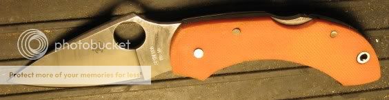

Lookin' kinda rough, but once I get all the pins set and the edges beveled I think it will do nicely... I goofed up a foliage green canvas scale because I used the removed scale for a template. Turns out the tolerances require tighter attention that that. Spaced the pivot to the rocker arm pin alot better on this one
WTF? Your first folder or what? Freakin' magnificent dude!!
How exactly did you get the pins out?

Yeah, it was my first spyderco and the first folder handle I've done anything with really. I had the right size punch for the pivot pin, so I punched it but I pryed the scales to find the other ones. It actually came apart pretty easy.
Wow, great job.
That looks so effing good.
Thanks. I wasn't sure about the orange, but the mili and the slipjoints look good so I had to try it.

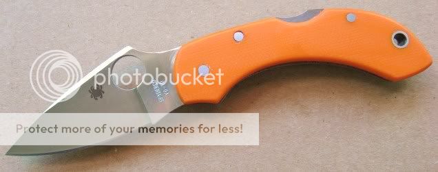

Well the SS one is pinned together, so had to use new pins and set them with ball peen hammer back into the new scale I made. I also used a larger diameter plastic washer between the g10 and the bronze one to reduce any friction it might have since I didn't use a steel liner.
On your's all you'll need is the right size torx bit. When you're done just put it back together the way it came apart.
I'm really likin' the little guy. Carries effortlessly in my back pocket. It's such a handy little blade.
