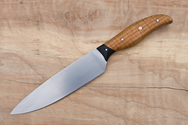

Teak is very nice for a lightweight, but durable handle. Here's one done in curly teak and blackwood.
