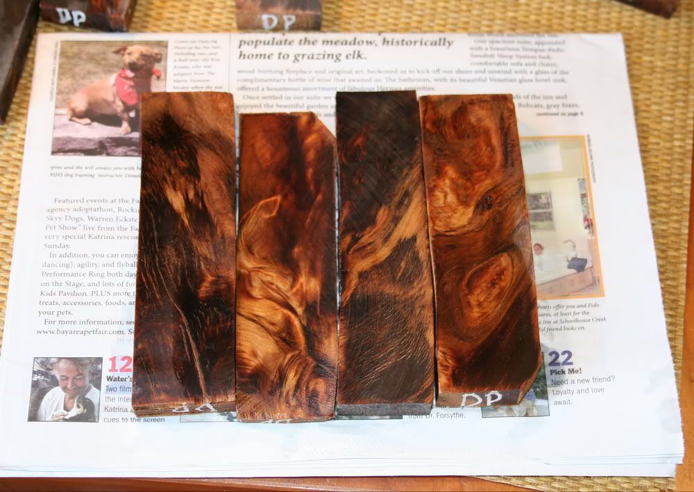

Man, that's tough luck. That ancient Kauri is some gorgeous stuff. If you could, would you mind posting a pic or two of how it looks stabilized? I've been wondering.
Also, are you certain it was dry before it went to WSSI? I know when it comes out of the ground it's very wet and has a lot of drying to do.

here it is
oh my god. I thought my birch burl scales were bad (as in badass)! Those scales make my wood look like a cheap hooker! Who is sellin that stuff so I can buy ALL of it!
Makes you want to cry it's so pretty....I need to sucker somebody into buying me some Kauri :)

From about 12 pieces only 2 have really nice pattern. Other have too much checks, defects or no nice grain.
I am leaning toward desert ironwood. I can buy a large piece of it for $100-120 with very nice pattern and make probably 10 or more handles out of it. It comes out much cheaper and looks great too.
BTW I've bought my Kauri at http://www.ancientwood.com/
Great customer service. Highly recommend it. They do a good work of trying to pick up the wildest pattern pieces they have for you. It's just very hard to tell if a piece has a good pattern by looking at very roughly finished board. Another thing with wild grain is that they always have lots of checks and cracks.
