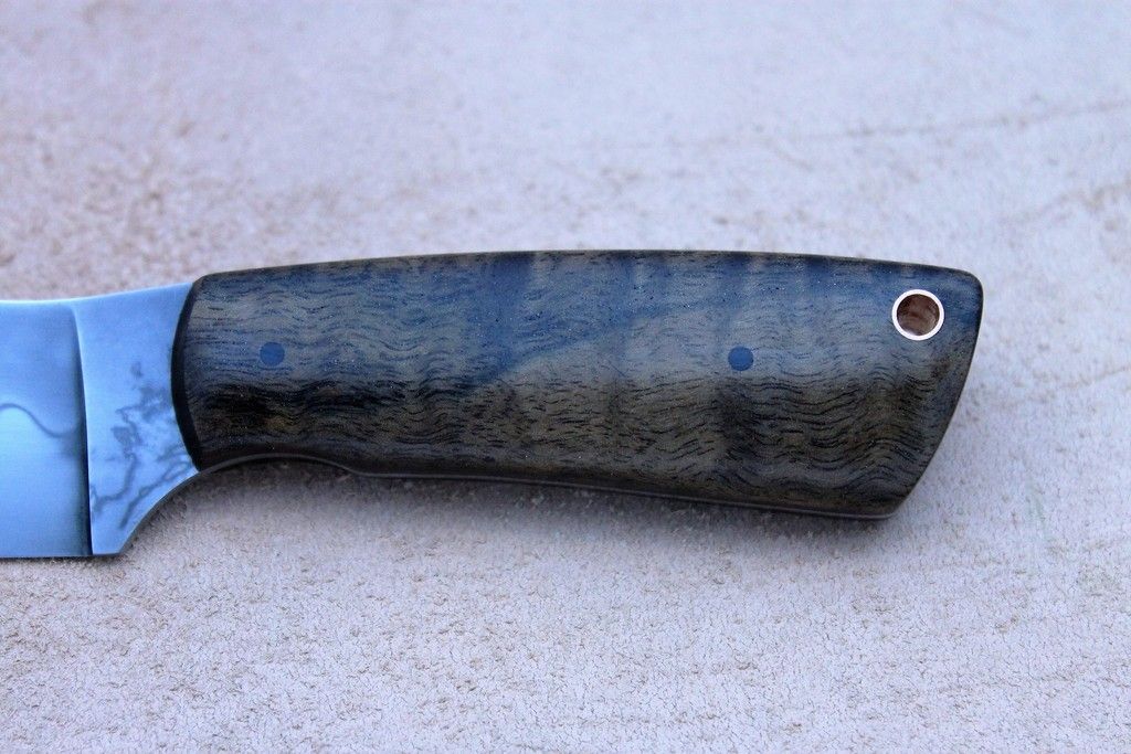

Otherwise work your way up hand sanding doubling the grit each time. Finish up to 1000+ grit and it should be polished up. The handle below was about 5-7 minutes on a buffing wheel.

You don't have to power buff handles. With this handle I sanded to 2000 grit, then hand buffed with a clean cotton cloth. Then I applied two coats of truoil. The handle isn't as glossy this way, but I like it.
