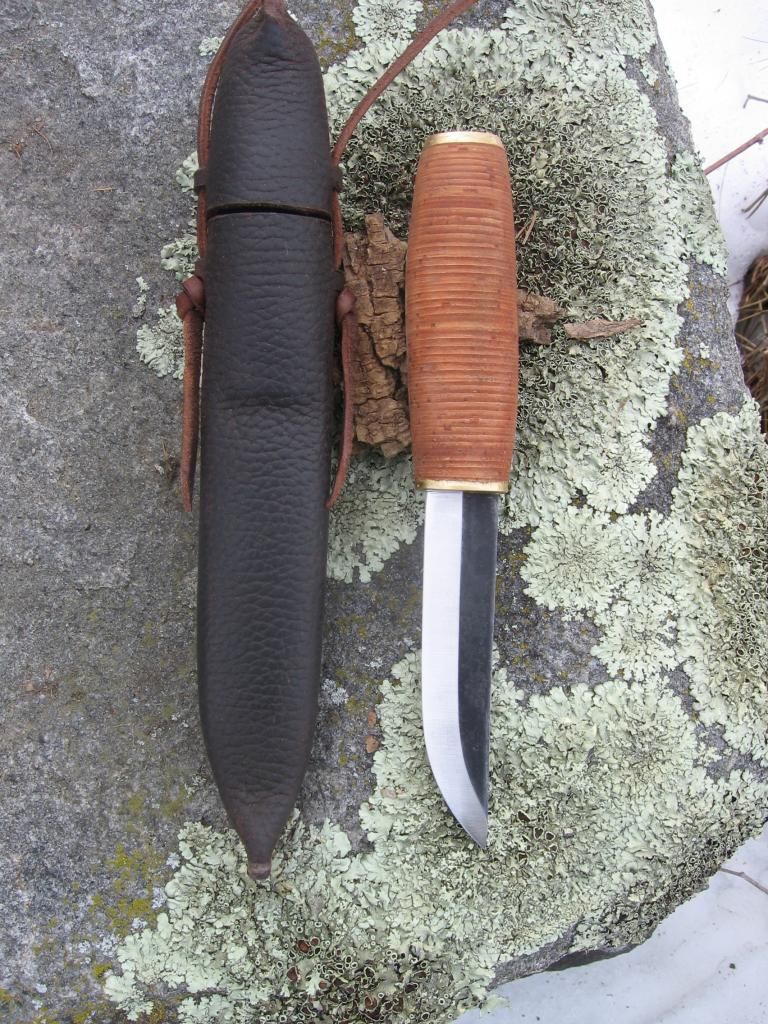

Anyone got any stacked birch bark knife handles? I've seen threads about stacked leather handles but not birch bark. Let's see some!

Here is a pic of one of mine, while I haven't used them in the field much due to sheaths missing or in poor repair, I do use them in the shop while waiting for the sheaths to be made. Comfortable, warm, unique. I have a bunch of birch bark waiting for me to try!!

Here's one i made up a couple of years ago with an early style capped neck sheath.
Best regards
Robin
Blade forged by Yrjö Puronvarsi. Birch bark handle by Simo Passi. Sheath by Kari Rämäkkö
