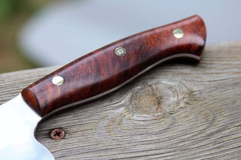

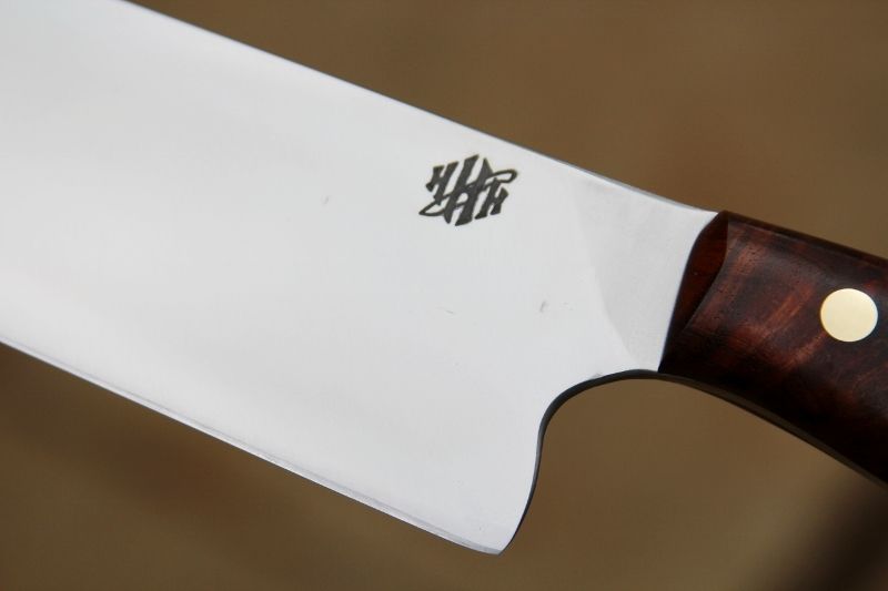

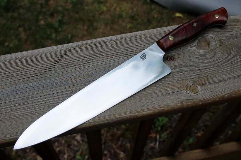

Heres on I just finished up for my brother from another mother, Dave
Its a ATS34 stainless steel Chefs knife 9 1/2 inch blade. RC 60/61
Red wood burl handles. Brass pins and a single mosaic with brass copper and stainless combination!
Enough talk heres the goods!

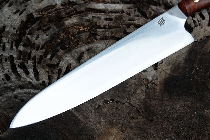

The money shot!

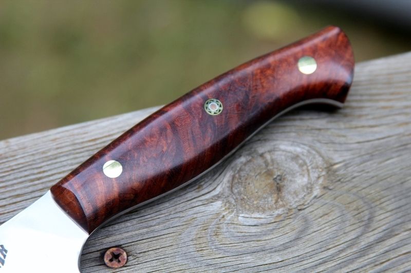

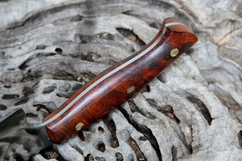

The Handle!! Beautiful material, I have never used this wood, The seller calls it red logwood. Its from South america and is very dense and naturally oily like cocobolo or ironwood. So it should be a perfect handle for a kitchen knife!

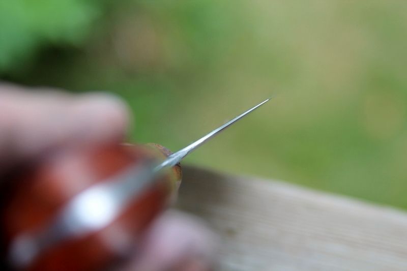

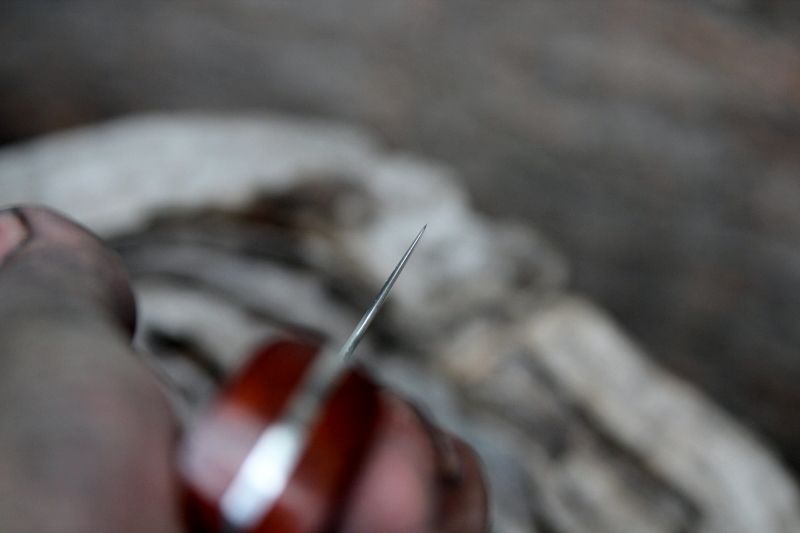

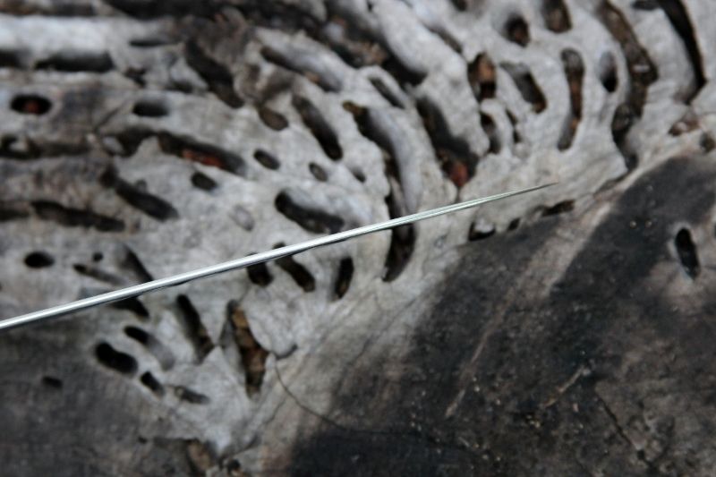

Spine shot and choil shot. Full blended grinds with rounded spine and choil.

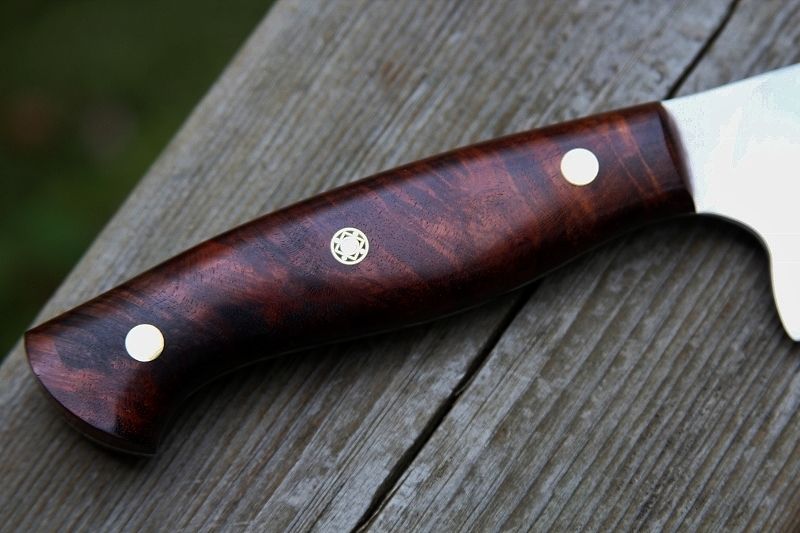

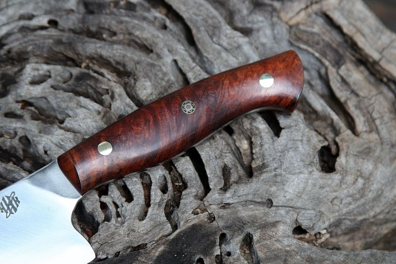

And the rest of the images! This is a 9 1/2 inch blade
Im not use to taking pictures of SHINNY stuff. But these show off the handle and blade pretty good! I hope he likes it!
Thanks for looking, as always, comments and critiques welcomed!
