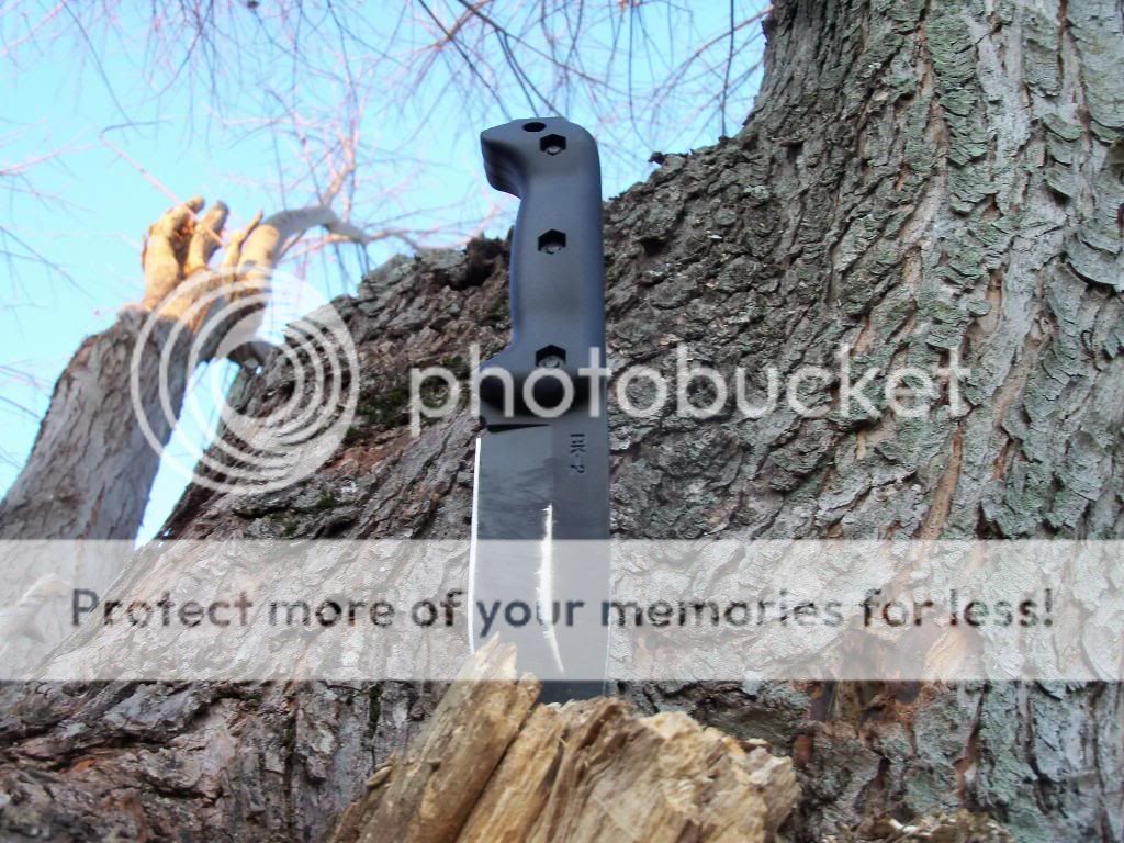

I cannot seem to find any stainless hardware in my are that will fit Becker handles. I have tried Lowe's, HomeDepot, and a couple other small hardware stores. And I still cannot seem to find any. Can anyone tell me where I might find them and what size they are? Thanks. And a few pics...

I got my parts & pieces at Ace hardware back in the specialty hardware bins.
they're either #8 x 32 or #10 x 32, I can't remember which.
Home Depot here has em. They're a pretty standard size, I don't remember if they're 8x or 10x either though. I'm leaning towards 8x though, so it's probably 10x, knowing me.
im pretty sure its 10, i also got some good possibilities at the leather working store..
I used 10x24x3/4... That's what they had at Lowe's... They are a little long so I was going to cut them but they don't stick out so I left them as is.
I switched my BK7 handle screws out to slotted types, 10-32 IIRC, so the screwdriver on my SAK Huntsman can turn them, and I can get to the matches inside if needed.
Trim to length, put them on a lit burner on the stove for a minute, them drop them into a glass of cold water. They'll turn a funky purple-black color, and not be so shiny.

i got mine at home depot. with liners, 3/4 is perfect.
the depot didn't have 5/8 or i would have bought a handful of those.
