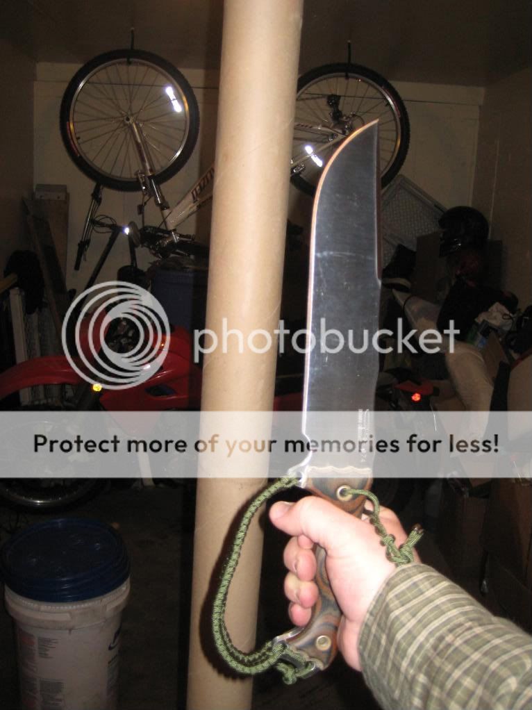

indeed, I think the steel in the Trailmaster in San Mai III does very well. It is the handle that I did not like as much. I used it for years. It does tend to roll more in the hand than other knives (like the FBMLE, or many other choppers with a different handle shape)
The steel it's self performed great. Great edge retention. Never had problems with chips etc. It stayed sharp for a long long time. In that price range I would probably recommend something else. Fallkniven Thor I think has the option of stacked lether handles. I would prefer Micarta though.

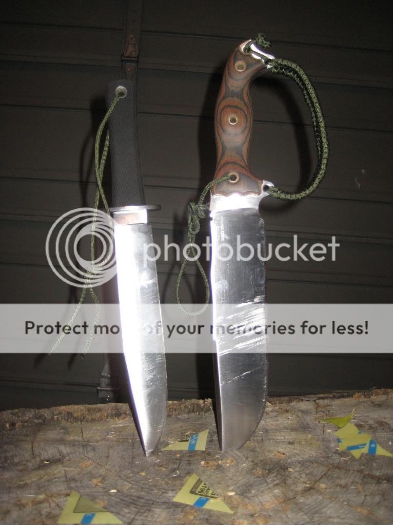

Yeah I hear you there, I love the feel of my CGFBM and it's a chopping machine. :D
I really wish CS would go with a different handle for the reason you stated.
NIce photos though. :D
