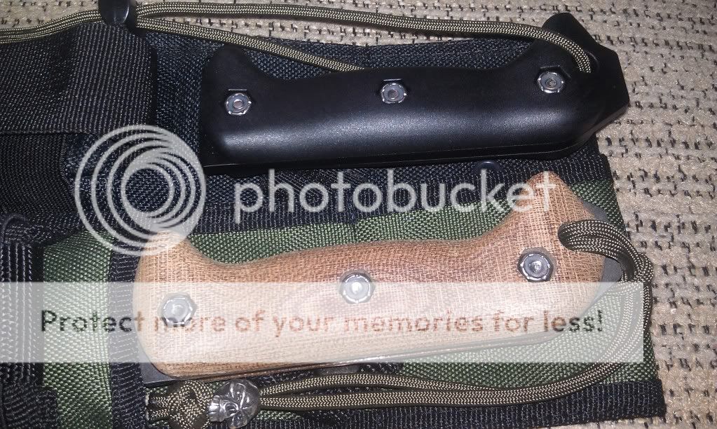

After doing some extensive forum research here I decided my BK10 LE needed some stainless hardware to compliment the overall package. The recommended size was 10-24 x 5/8" (thanks Moose). Went down to the local Home store and Murphy was along for the ride. No 5/8" only 1/2" and 3/4". So I picked up both sizes. The 1/2 is about one thread to short in my opinion (see picture). I ended up using the 3/4" screws and cutting them to length with a dremel cut off disc. Just wanted to post this in case some of the new BK10 owners are thinking about doing the same upgrade. The scales are the Kabar micarta scales that came with the knife.
Finished Gratuitous Knife Shot

it's a good mod.
screw specs should be in the Database. we have seen shipped variants, but the old standard works :D
That stainless looks good! I might have to look into picking up some myself.
Bladite: I agree, the stock screws are good to go , just wanted to dress up the knife a bit.
EK20: for a couple bucks, it's a cheap way to dress up the knife. I might just upgrade all of my Beckers to stainless screws.
