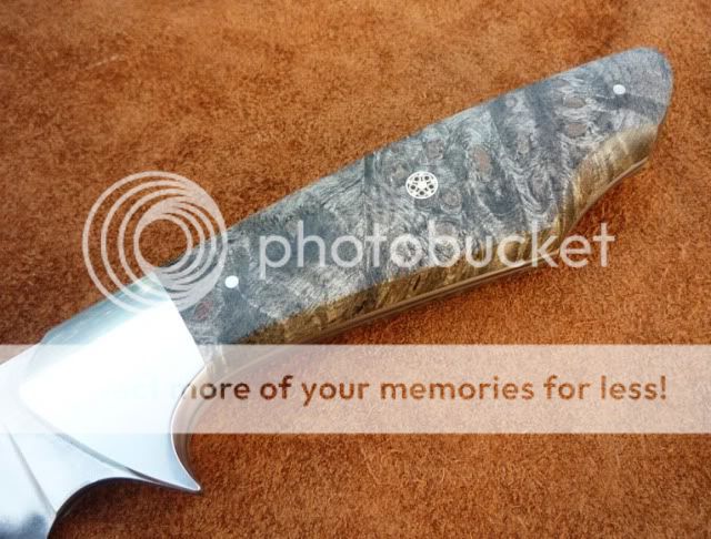

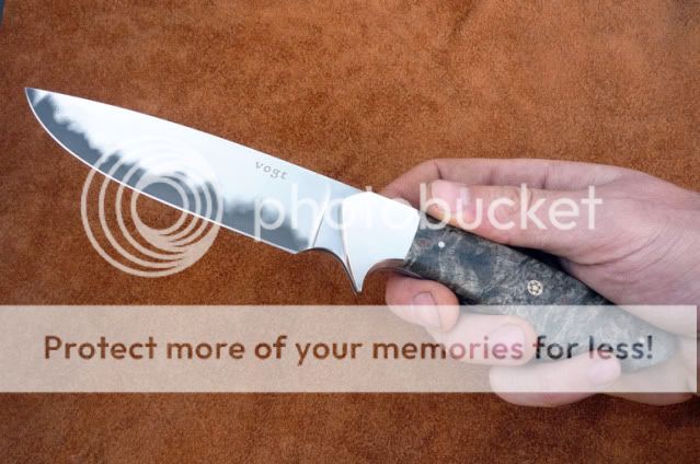

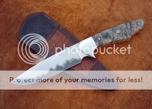

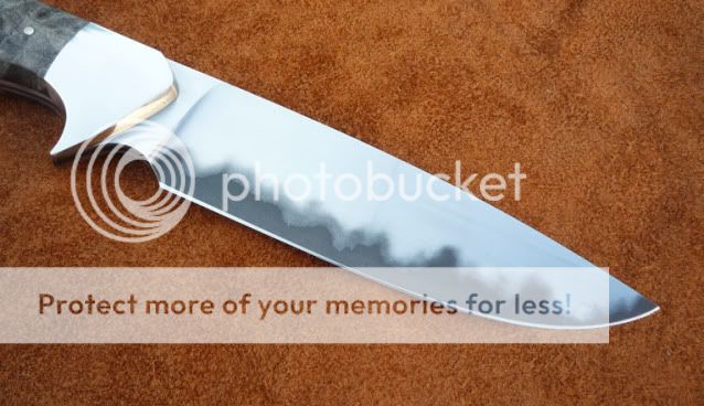

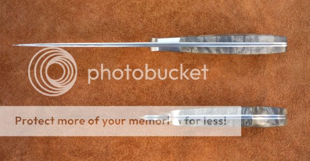

This one was done without any client's requirements, so I did something different (different for me, of course).
It's a full tang contruction, with a core of Bolher K110 (D2) and 420 MoV on the sides.
Bolsters are stainless, scales of stabilized buckeye burl with nickel silver pins and a nickel silver and copper mosaic pin.
Blade lenght: 5"
Total: 10"
Sheat is hand sewed, with some texturing and ostrich leather insert.
Hope you like it!
Happy Christmas!
Javi
