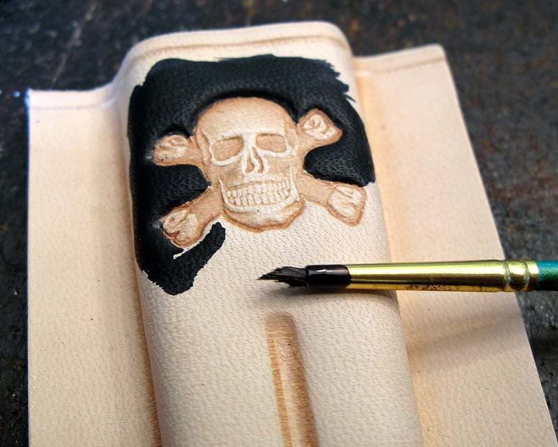

just like the title says, do I dye before or after i stamp/impression designs into the leather? Also, do I dye the inner portion of the leather? And also dye the portion being glued? I'm using a black dye/sealer combo on vegetable tanned leather.
It depends on the final output of the embossing, if I am to leave it
a different colour than the entire sheath, I emboss first before dyeing.
If the embossing will be dyed the same as the sheath, I now dye it
and then emboss, especially on lighter coloured sheaths, just works
better for me.

Back to the embossing, if you are forming the sheath, you will want to
wait until you have it fully formed and dry so that all the give is taken
out of the leather and then emboss away.

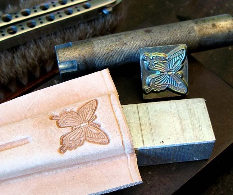

I use a very thick block of steel to emboss on and also place smaller
blocks of aluminum beneath the leather to act as mini anvils.

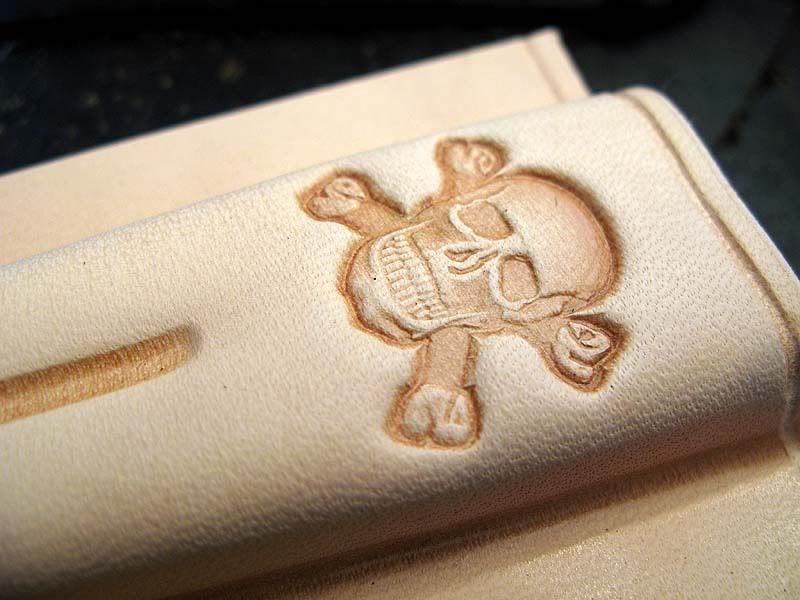

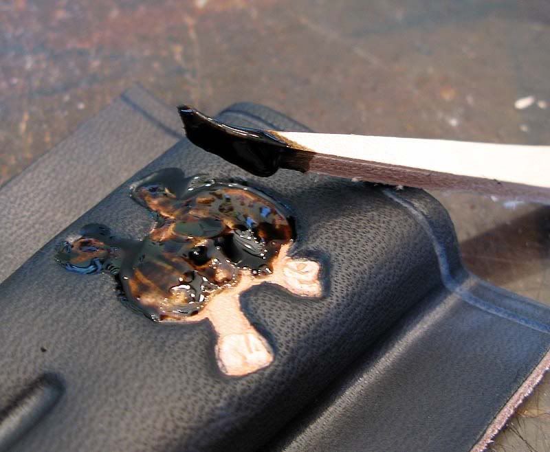

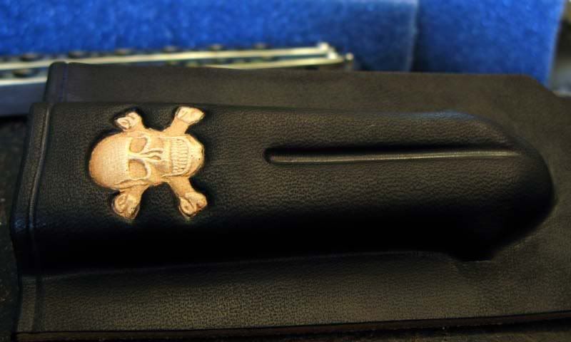

and here's some steps where I emboss, dye around the embossing and
then use highliter to darken the area of the embossing to bring out details

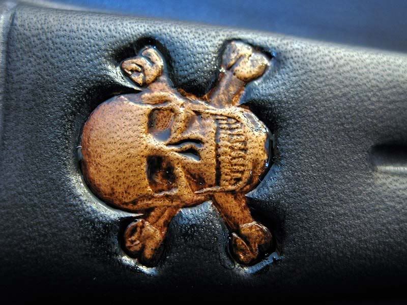

highliter is a thicker goouey gunk that will wipe off but be left in the creases
of the embossing to help it look more 3d like;
after drying a little, wiping it down leaves this effect;
hope that helps some for you,

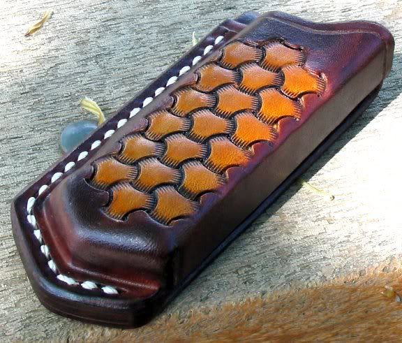

Here's an example of a sheath that was overall dyed burgundy and the
embossing was a saddle tan, but also rubbed in some of the highliter
to bring out the details of the embossing. It's a bit tricky and not
something I like to do too often;
